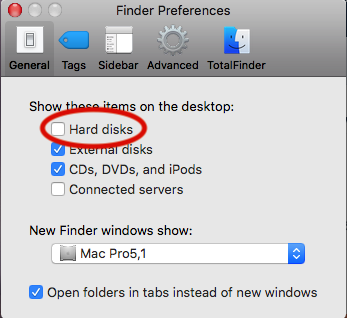

Something to try...
In Finder preferences under Show items on desktop,
try toggling Hard Disks off and on.
Thanks, tried to switch this on and off. In general external drives are shown, only one of the 3 installed drives disapeared but is still mounted and working. Only desktop icon is gone.
