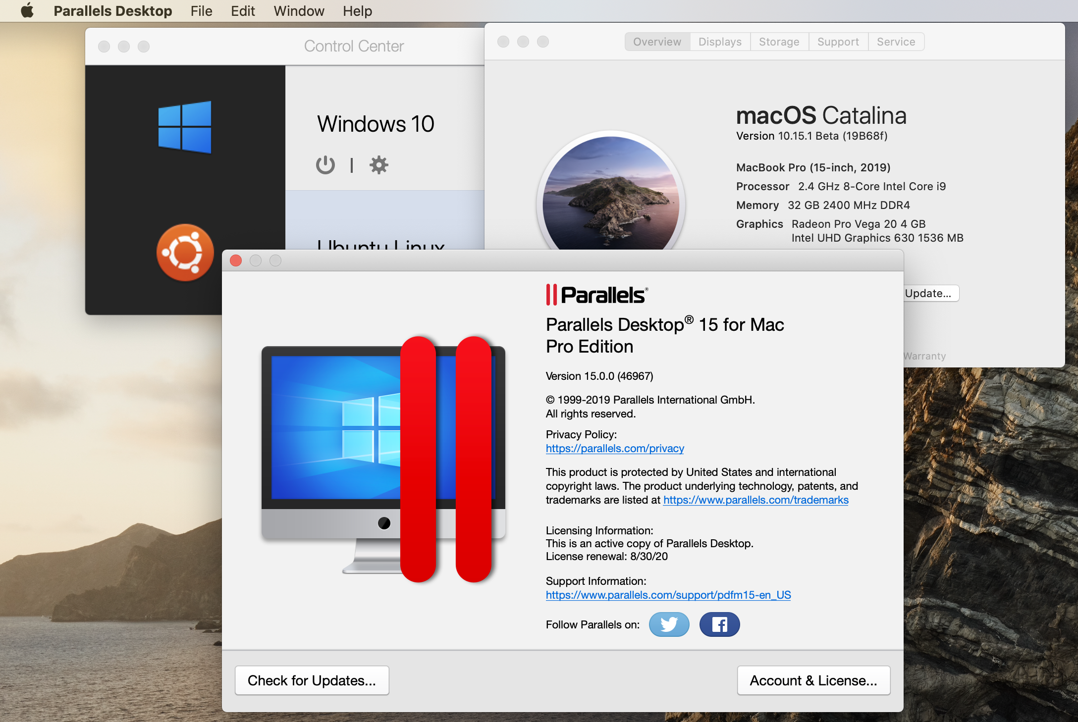

I have Parallels on 4 different machines on Catalina, including the same one you specify. Throughout the Developer Preview and now in to Cat 15.1b
