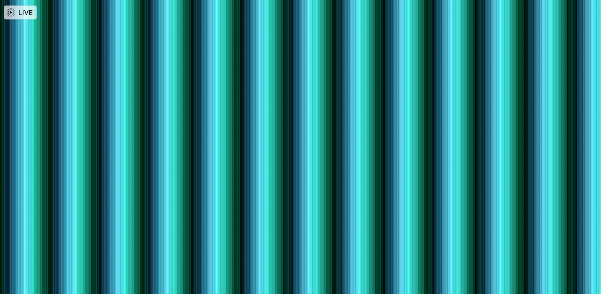

In Photos, occasionally zooming a picture (i.e., select it and press space bar) out to its full size results in this:
Sometimes, it shows most of the picture but the blue "glitch" is just a strip on the right-side. Sometimes, the blue is in squares across a portion of the picture. But it's always this blue weird pattern, and the "glitch" appears randomly.
If I hit space to zoom it back, then space again to zoom it up? Sometimes the same, sometimes the picture is fine.
If I keep using Photos? The glitch goes away. Or, moves to a different picture. The fun never stops!

Hi! I also had these kind of graphical issues but since I installed macOS 11.5 the problems are gone, I also thought it might be a bad graphic card (Radeon Pro 580X) but since I got that update everything is fine so I assume it was bad drivers all along.
In this website you'll find a more detailed explanation of your problem, keep in mind this was before 11.5 and up: https://icanthascheezburger.com/wordpress/2021/04/graphics-issues-on-the-2019-mac-pro/

Well, the problem is back with a vengeance today. Photos is glitching out almost every photo I tried to edit. Interestingly, it's only affecting my HEIC photos -- others don't seem to be affected at all.
I did notice today that whenever I zoom in on one of the photos that's affected, and get the blue corruption bar, I see this logged in the console:
Code:
void IOAccelContext2::process_token_BindDataBuffer(IOAccelCommandStreamInfo &): bad texbuf id. id=0x00000038
The graphics driver has encountered internal error 0x0, 0xfffffffe.
I actually see a whole bunch of those appear, like 10-15 or so, every time the graphics glitch. A little Googling turned up -- NOTHING. So I'm really at a loss as to what this all means.
