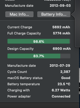

What about the condition of the battery? Have you verified that it's okay? You state that you think the battery specs read normally. You can get a good idea of the battery condition by downloading and running "coconut battery". (The clicking sound is probably coming from the optical drive.)
Hey chscag, thanks for your response. I have coconut, and everything seems to be normal? See below:

Actually, your battery looks to be in real good condition which is surprising for a 2012 machine. Cycle count is normal and charge capacity is good.
The symptoms you described could also be caused by a failing DC input board or indicate logic board problems. Do you have a spare Mag-Safe charger that you can try? Sometimes a flaky Mag-Safe charger can act the same way.

I would disagree about the condition of the battery.
Almost 2,400 charge cycles is well past the suggested design life of 1,000 cycles.
Status (battery health) might be reported as "Good", but is less than 84%, close enough to the "edge" of 80%, where Apple would consider the battery depleted. Kind of amazing with that many charge cycles.
And, it appears to be the original battery - it has served a good life...
Bottom line... If your MBPro shuts off "in pretty short order" after unplugging the power adapter - I would suggest that if you want to continue using your MBPro, battery replacement is the next step.
I replaced the batt in my 2012 MBPro a few months ago.
Working great, I think not too much to spend to get some more use out of a 10 year-old laptop (if you want to do that), particularly if you want to be "portable" again :cool:

Hey Delta, thanks for your response. The reason why it seems like the battery is unlikely as a culprit (or the sole culprit, at least) is because it continues to shut off even while plugged in. At the moment, it won't stay on for a longer than a minute or two after booting up, even while plugged in.

One test that could help you eliminate the battery -- disconnect the battery, and use your MBPro for an hour or two, maybe long enough to tell if it seems to continue to run without randomly shutting off (with no battery connected)

I was thinking for some reason that 2000 cycles was normal, however, after looking that up @DeltaMac is correct. The battery is still able to charge to 83.7 % which is still workable. Anyway, try what was suggested and let us know.
