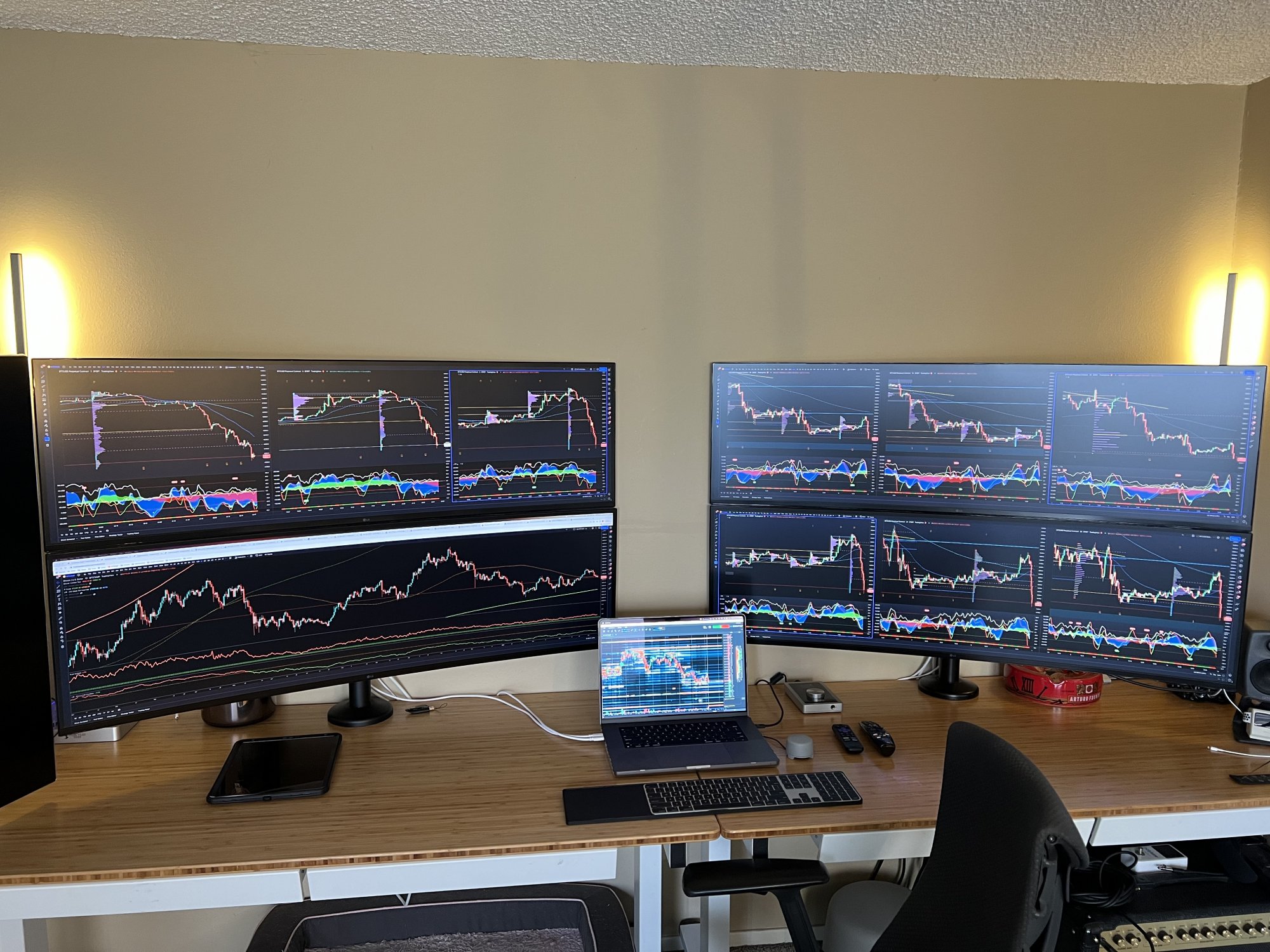

I’m running 4 x LG 49” monitors (5120 x 1440) on my maxed out spec 16” M1 Max. Two of the monitors are plugged into individual thunderbolt ports. The other two monitors are plugged into 1 Caldigit Element hub.
Btw, I was able to run 3 of my monitors with no dock (each plugged into their own thunderbolt port. In your case I think you could run 3 x 4K with no extra dock.
