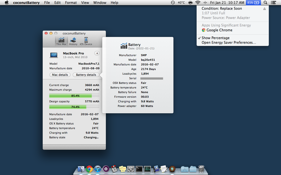

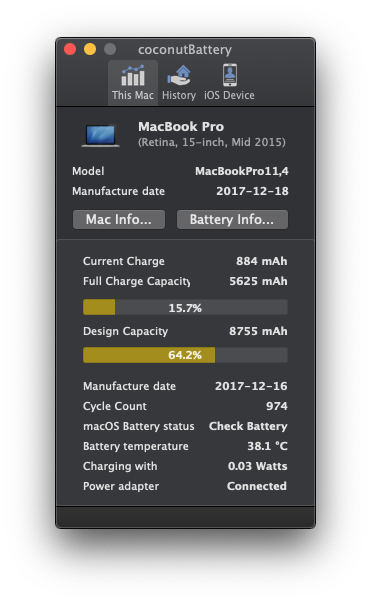

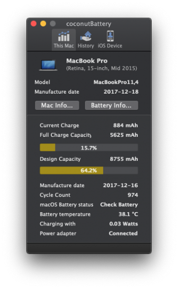

You should replace it if you want a healthy battery in your MacBook as it has over 1000 cycles but is not urgent, here is my Retina's coconutBattery for comparison:
Mine has nearly 1000 but the health is much worse (64.2% vs 74.4%). You can get new batteries from iFixit and from eBay (if it has good reviews).

Would you say a better strategy from now on is to use it plugged in most of the time? Would that technically 'suspend' its current health state or is that just nonsense?
I had my Retina plugged in 24/7 for over 2 years and it worsened the battery health. These days I unplug it when it reaches 100%, then plug it back in once it reaches 70%.
Alright! I think I'm going to follow your advice. Thanks!
No problem! Though at 1000+ cycles I would still recommend at some point replacing the battery. It is easy to replace in your model. ifixit.com has a good guide.
Yes I will absolutely look into that but some time in the near future! I'm still getting about 4-5 hours out of this baby. More so if I'm just watching a movie/show in a dim room!

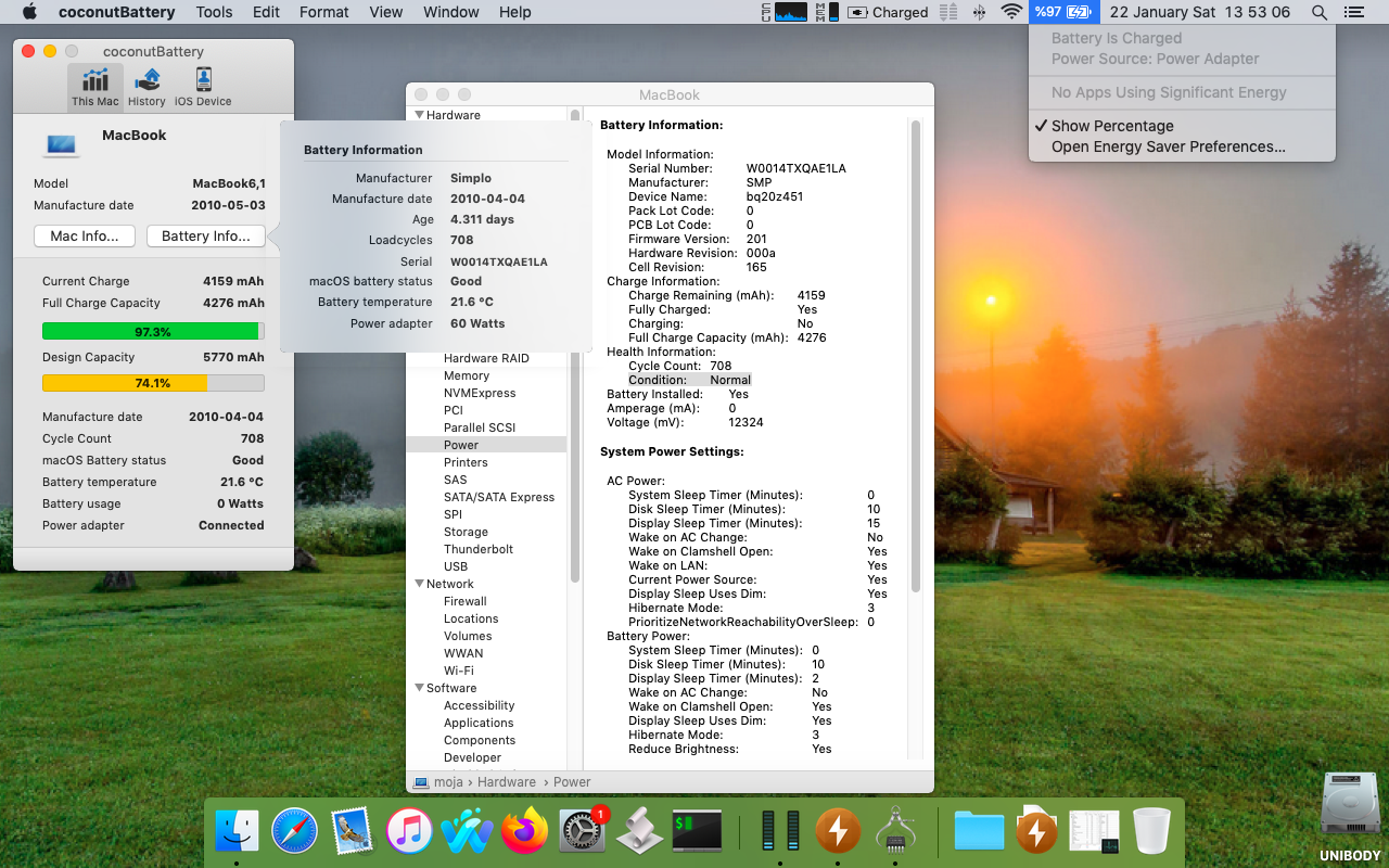

Here is a screenshot from my MacBook Uni/Lat 09 for you to compare. The battery shows as %74 healthy in the app but in reality it feels perfectly healthy i.e. no sudden jumps in time Remaining during battery power, no unexpected surprises. Considering its 10+ years of age it feels and works perfectly. macOS version: Mojave.

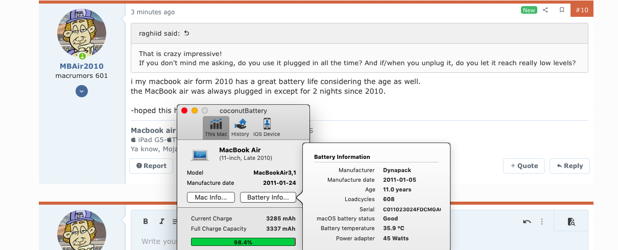

i my macbook air form 2010 has a great battery life considering the age as well.
the MacBook air was always plugged in except for 2 nights since 2010.
-hoped this helped!View attachment 1947775

Actually I had mild issues with this battery when I bought it 2nd hand but I fixed them quite easily. The issues were mainly related to the battery being unused for a long period of time and the Mojave's unreasonable way of evaluating the battery health (Lion and Mountain Lion had no such problems)

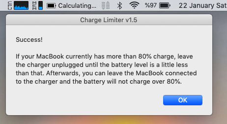

As for the question, I use it plugged in most of the time. But later I've found out that in order to increase the battery life, it's best to keep the charge level between around %80 - %40. So I've downloaded and installed a very basic app called Charge Limiter version 1.5. With this app you can set the maximum charge limit. When you open the app it just asks for a number up to 100 (percent) The generally suggested number is 80, so I enter 80. After that it pops up the notification dialog below.
When I unplug it, I usually avoid reaching too much low levels. Actually I discharged to very low levels only once or twice in order to recalibrate the battery when I first bought it.
As for the question, I use it plugged in most of the time. But later I've found out that in order to increase the battery life, it's best to keep the charge level between around %80 - %40. So I've downloaded and installed a very basic app called Charge Limiter version 1.5. With this app you can set the maximum charge limit. The suggested limit is %80 so I set it to %80 so the battery is charged at about %80 level. In the picture below you can see the app in action.
So the app is merely a notifier? Notifying you when the battery reaches 80% so you can unplug, or is it actually setting a ceiling for the battery and preventing it from charging past 80 even while plugged in?
Oh no, it 's not a mere notifier. It does what you say latter: It sets a ceiling for the battery and so prevents it from charging past 80 even while plugged in (I've just edited the related section in my message) And it seems to keep this charge limit setting even if you change the harddisk and boot another version of macOS because several days ago I plugged in my Mountain Lion installed HDD and noticed that it wasn't charging beyond %80. I wanted to change that limit on M.Lion so I've installed the same app on M.Lion but it didn't work. None of the older versions of it worked either. I wish this app had a M.Lion compatible versions too.
