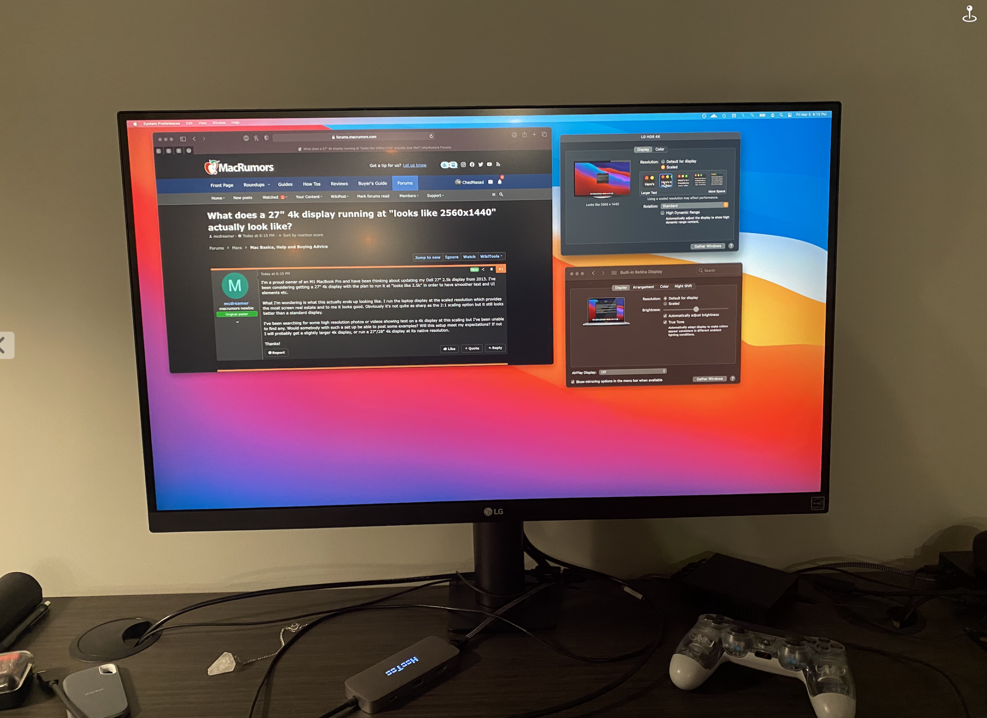

I would say it looks pretty good. This is one of the 27" LG 4k Ergo monitors

Thanks for the image. I guess that for 4k at 27" the macOS "default for display" setting is "looks like 2.5k"?
If you wouldn't mind, would you be able to attach an image a bit closer to the screen showing the text in a bit more detail please? No worries if not!

Just as an update, I've now been using the LG 27UL850-W for a couple of weeks and I can confirm that it looks great. It really does look 99% as good as the Pro's built in retina display at "looks like 2560x1440" and I've seen no performance degradation on either the M1 or Intel Mac. I can start to see a slight degradation in text quality at "looks like 3008x1692" which isn't too surprising but honestly it still looks good. I would post an image of the display in action, but if you've seen a retina display then you'll know what to expect.
