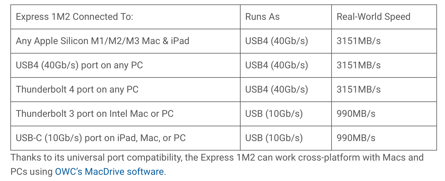

You basically have three connection choices, and the last one (USB 4) provides no benefit over USB 3 on your 2019 iMac:
USB 3 SSD (max ≈1000 Mb/s)
TB SSD (max ≈1500 Mb/s, or ≈2800 Mb/s, depending on the enclosure)
USB 4 SSD (max ≈1000 Mb/s; normally these go up with ≈3000 Mb/s, but that's only if your device uses USB 4, which in turn requires TB4, which your iMac doesn't have; since it's restricted to TB3, you're restricted to USB3 speeds). [See chart at bottom for USB 4 performance.]
If you want to go with USB 3, and don't want to get your own enclosure and drive, you should be able to get a good 1 TB external SSD for ≈$100. The Samsung T7 Shield is a popular choice (https://www.samsung.com/us/computin...exact-&ds_k=samsung+t7&gad_source=1&gclsrc=ds ). Not sure if the new T9 is better or worse (https://www.samsung.com/us/computin...rtable-ssd-t9-usb-3-2-1tb-black-mu-pg1t0b-am/) (I'd suggrest checking our reviews on anandtech.com). I personally use the Kingston XS2000. It's fast for transferring a few files, but slows considerably for extended transfers (which sounds like it would be perfect for your use): https://www.amazon.com/Kingston-Performance-Pocket-Sized-SXS2000-1000G/dp/B09F5YHQ1K/ref=sr_1_3?crid=1MPFNQY8EJFIG&dib=eyJ2IjoiMSJ9.f7XZhKCz8NdXmhImGVB8rwOwU66cKSqd4JM-iue89EuCvfmxQocwRm2kODRaSBky-bqWZx5x9Av80sUG9J4ZhF1QCjBPm322A1ly1CQZquPOUgDwl7z9esx7nnW6Qk1LtLQlCJuJN3TrecDnw8wmHw.Xr8NK_nwlp607Ee2HLYTBSXAqUcClBzyBCtVzwbV4vQ&dib_tag=se&keywords=kingston+xs2000&qid=1705223215&sprefix=kingston+xs2000,aps,143&sr=8-3&ufe=app_do:amzn1.fos.18ed3cb5-28d5-4975-8bc7-93deae8f9840
If you want to go with a TB SSD, you go could with something like a San Disk G40 (https://www.anandtech.com/show/1759...-thunderbolt-usb-dualmode-portable-ssd-review)
USB 4 PERFORMANCE CHART, FROM https://www.owc.com/solutions/express-1m2
