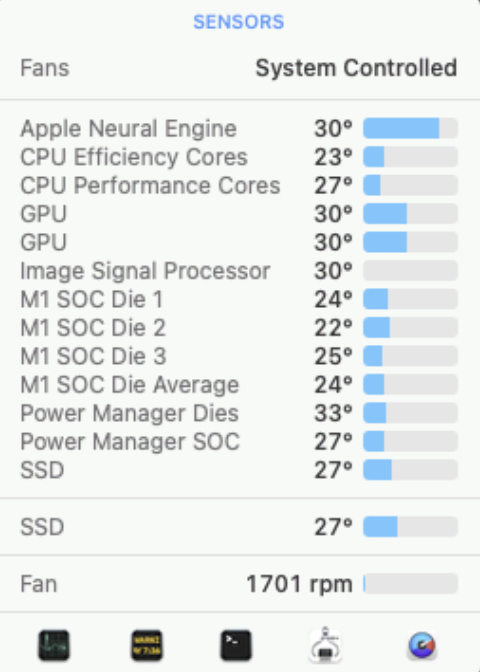

I’ve been a happy user of an M1 Mac Mini for a few months now. It is part of my dedicated stereo system. I run apps like Audirvana and Roon on it, upsampling to 768kHz or DSD256 as required, as well as convolution software for room correction. As expected, the Mini never breaks a sweat.
Looking at the chip temperatures as reported by iStat Menus, I’m a bit puzzled by what I see:
It looks like the CPU cores are the coolest part of the chip (about ambient temperature – this is Australia in summer, mind you). I can understand the GPU being a bit warmer: even though I’m running the Mini headless with remote screen sharing only I do have a dummy HDMI thingie plugged in for better remote screen performance. So far so good, and as expected.
What I don’t get is the neural engine temperature. Why would that be any warmer than the actual working parts of the chip? What is the neural engine doing? This Mac isn’t exposed to a flurry of online or iCloud or any sort of interactive stuff, its only purpose is playing music. I’m fairly certain that neither Roon nor Audirvana use machine learning, so what else is going on there?
This is not a serious concern, of course, but I’d really like to know what the NE is doing in this case, and also what its big mission is overall, since Apple puts to much emphasis on it.

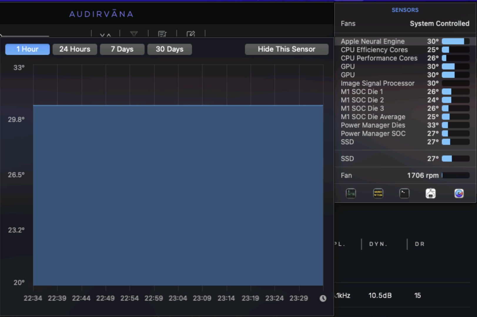

Both the Neural Engine sensor and the Image Signal Processor always show 30 °C on my machine (Air), and never change. I guess the sensors just don't work or need different signal processing.
Yes, that could be the explanation. The NE temperature appears to be a solid 30 degrees over time, so either the sensor isn’t working or there is a bug in iStat Menus.
An astute observation. In my MBA, both NE and ISP are always 30C, and for that matter, both GPU temps are almost always at 30C, except for occasional tiny spikes of less than 1 degree. Maybe someone can ask iStat Menus support about this.
It's probably doing nothing. You should look at power rather than temperature, as temperature data is convoluted with other nearby things. Silicon is a decent thermal conductor, so if there's anything hot nearby, it'll heat up the neural engine too. (This will be especially true if they didn't bury the neural engine temperature sensor in the middle of the neural engine, and instead placed it on the border where it neighbors something else.)
Try running Terminal.app and using this command: sudo powermetrics -i 1000 -s cpu_power . You should see a line like "ANE Power: 0 mW". That's the number to look at. If it's 0, the ANE (Apple Neural Engine) is completely idle and depowered.
See above re: neighbor influence. Since you're on an Air, you can actually make the ANE wake up and do stuff: just run FaceTime. Apple uses the Neural Engine to process and enhance the video stream coming from the FaceTime camera in the notebooks. @dotnet won't be able to do that on a Mini, though. I'm not sure what built in software will actually use the ANE other than FaceTime.
Ah yes, the ANE is using 0mW consistently:
E-Cluster Power: 55 mW
P-Cluster Power: 18 mW
ANE Power: 0 mW
DRAM Power: 22 mW
CPU Power: 73 mW
GPU Power: 3 mW
Package Power: 103 mW
So it’s simply a read-out error. Whether the on-chip sensors or iStat Menus are to blame has yet to be determined.
