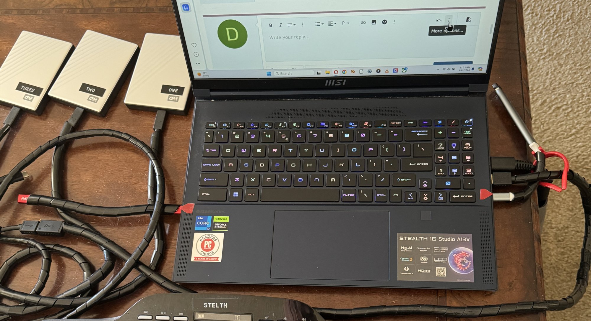

When i started using my new MSI Computer cabling became a challenge.
Reactions: 2Xtreme21
Looks like u need a usb hub and NAS
A four port hub is hidden on the left that small silver thing on right is a also a four port hub the USB Dongle is on it's end freeing up the only USB-3 port and allowing me to use the USB-C for the small USB 3 port hub, i had to do a lot of shopping on amazon to get what was needed.
The black coil covers on all cables is to cat proofing them, have a cat that will chew any cord to death.
