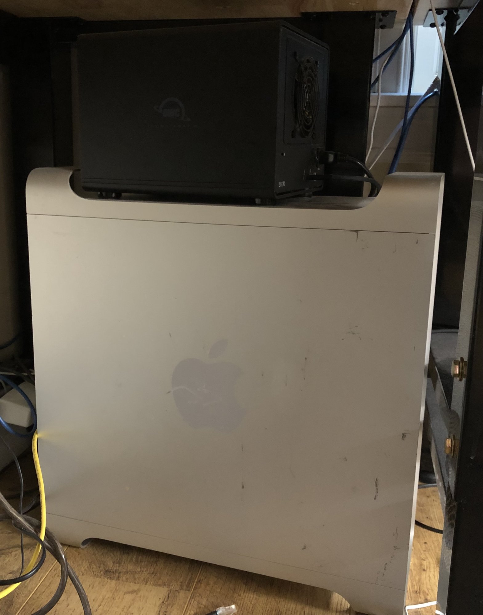

I now use mine to keep my hard drive bay off of the floor under my desk.
@Lasermoon - :) Those are nice cases.

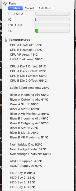

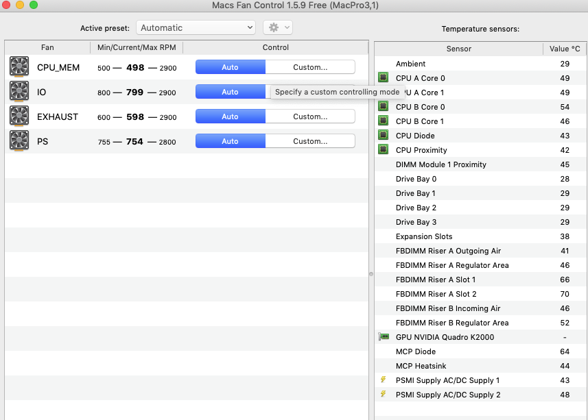

so the easiest point is: Check the temperatures.
a fallen off heatsink on the chipset controller, dried thermal paste or even blocked airflow by dust bunnies can be seen.
Typing this on a 3,1 running Mojave.
These are temperatures of my stable running main machine in my 2nd workplace to compare. I don't have touched the paste myself, yet.
TG Pro and Macs Fan Control

Are these nice cases good for anything? Are they too specialized to work as PC cases?
