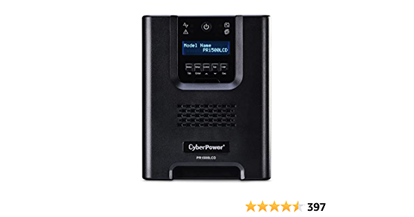

I have the Cyberpower PR1500LCD. Haven't had any problems with it, but the PowerPanel monitoring software isn't the most elegant....

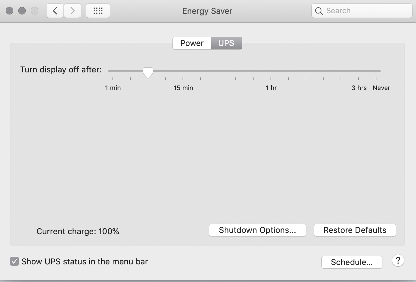

Does APC have Mac monitoring software?
They used to, but not anymore because there is no need. The MacOS Energy Saver Control Panel has all the controls you will need.

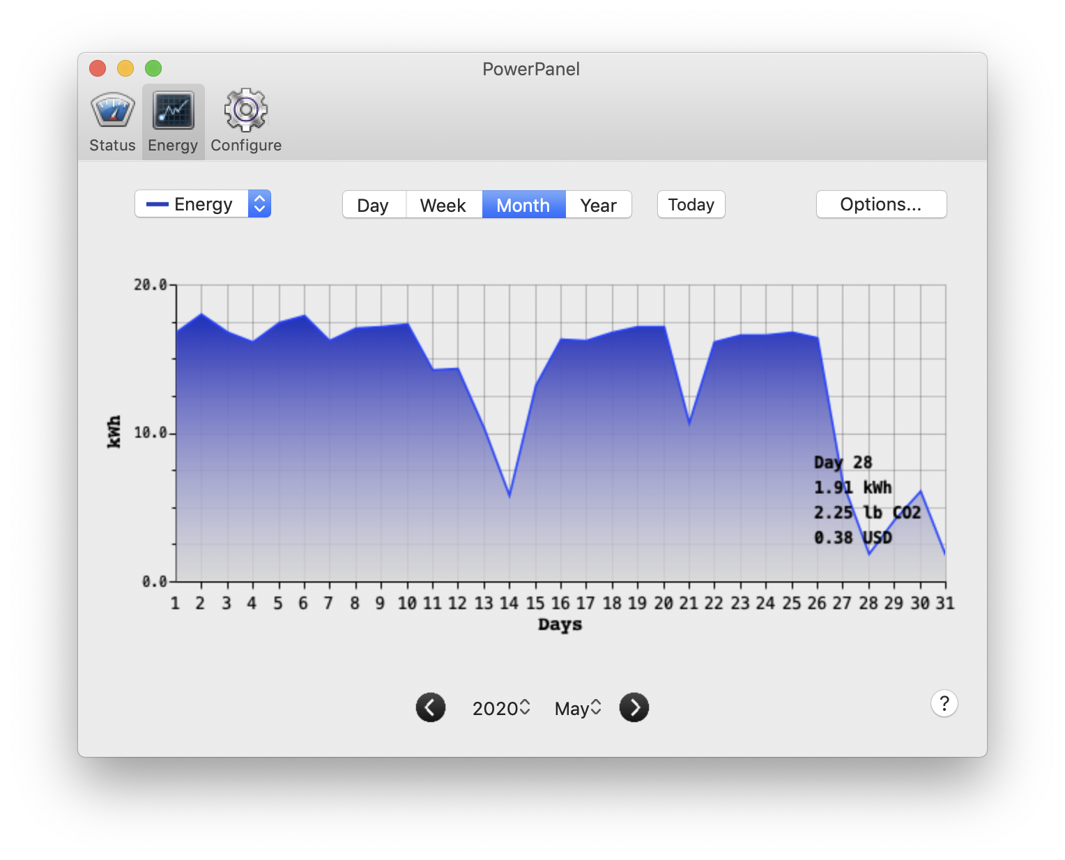

Unfortunately that doesn't meet my needs. I have flexibility in how many of my systems are powered on and how heavily they are used. I need to see a record of power consumption. When I brought up the latest PowerPanel graph I realized that I was using almost 3 times more power than normal. With high-cost electricity (over $.20 KW/h), this is something I have to watch. Shutdown some systems and am now back to normal.
So I guess that eliminates APC as an option for me.
