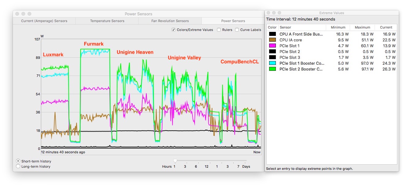

I am now running a 1080Ti with just the 2x mini 6pin. So far, only one software can cause a hard shutdown, which is the CUDA-Z heavy test. But since my daily job is not running CUDA-Z (heavy), and none of any other benchmarks / real world use / gaming cause any issue (I did a lot of tests, including Furmark, OCCT, etc). So, I wouldn't worry about it.
Anyway, this is the power consumption test result.
Even though a 6pin is rated at 75W, but that's with a 15% build in buffer. That means all standard 6pin was designed to provide at least 86W. If we take this into account, apart from Furmark, my 1080Ti's power draw actually always stay within limit.
And the interesting part is, a standard 6pin is designed to deliver 7.14A max via two 12V wires. And in the cMP, all three 12V wires are powered. It seems because of this extra 12V pin available, Apple also raise the real world power limit of the mini 6pin to 86W x 150% = 129W.
In fact, real world tests show that once the power draw go above 120W, the cMP's self shutdown protection may activate at anytime. Which coincidentally very close to this 129W calculated limit.
And from the above graph, you can see that my 1080Ti can actually draw ~100W from each of the mini 6pin without any problem. Anyway, since I believe your daily work is not running Furmark or CUDA-Z. Therefore, I will say the 1080Ti / TitanX is the real most powerful card that do not require any extra power.
N.B. The above comment ONLY applicable to the reference card. There are lots of non reference card out there has very heavy factory OC, and can draw way more than a normal reference card does.

The 1080ti is over the official limit, 250 vs 225w. It does require extra power if you want to avoid shutdowns in all conditions. My answer is still the GTX 1080.
That doesn't mean that some could live with it based on their tasks/workflow, but honestly, if I put in a new GPU, I don't want to have any worry if my stuff will ever shut down from what I'm doing, or what I will ever do. I want a GPU with some headroom, so maybe I could overclock or fiddle with it in the future? I don't want to use "extra bandwidth" as "all possible bandwidth". Especially when it comes to a 10 year old machine that's harder to repair as years go on. Having bandwidth (tolerance) is a good thing!
For me, even if I don't have apps that utilize Cuda-z benchmarks, I still would not put in anything more than a 1080 without power mods. Just the fact that a certain card, like the 1080ti, will shut down the Mac Pro in certain circumstances, even if they are rare and/or currently benchmark-only, is enough for me (and probably many others) to not even consider, period! And those graphs show current apps. What about future apps or games? What about Windows? What about future optimizations?

That's why I said it depends on if OP want a card that has publish TDP within the mini 6pin's official limit. OR if he is looking for a fastest GPU that can work.
But anyway, I totally agree that a reference 1080 should be the fastest 100% safe option. 1080Ti, only practically fastest in most case, definitely not always 100% safe (especially we already found a way to hard shutdown the cMP). Also, almost any 1080 can fit inside the cMP's power envelope, but 1080Ti will be very restricted to the reference design non OC card. Anything above that will greately increase the chance of triggering the shutdown protection.
