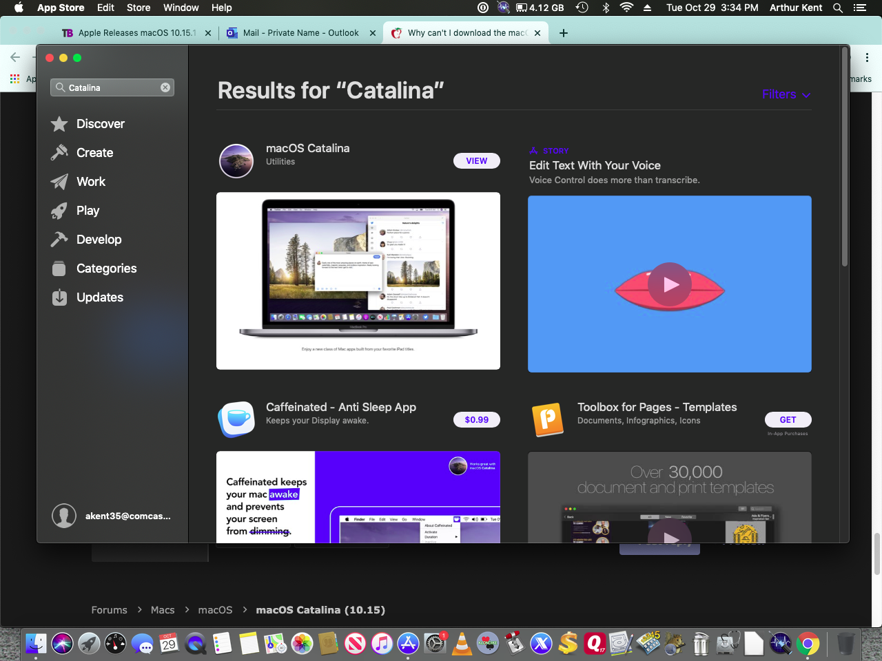

The App Store does not appear to allow a user to download the installer any more. I know it used to work that way in the past with previous macOS versions, but that is definitely no longer the case.
Try it. It simply opens up System Preferences.
Catalina is NOT there! But when I visit the App Store and do a search for Catalina, it brings up the screen where I can "Get" Catalina (but it's still V10.15.0), but says the requested update is not available.
I have previously downloaded the FULL Catalina OS 10.15.0 installer file TWICE from the App Store. I'll just wait a little while, especially since I do not need it right away.
...when I visit the App Store and do a search for Catalina, it brings up the screen where I can "Get" Catalina (but it's still V10.15.0), but says the requested update is not available
But it's System Preferences that says that, right? Not the App Store. The App Store just hands off to System Preferences to do the download. The App Store no longer downloads macOS installers itself.
I don't know what to tell you, it just doesn't work the way you're describing. Here's a screen capture I just took on a brand new Mac Mini running Mojave, you can see for yourself:
Notice that it initially says that the update is not available, but then immediately changes its mind and does find the update. For OP (and on some of my installs) it never gets past the "not available" error which makes the download impossible via System Preferences.
So App Store "MacOS Catalina"
Just tells Software Update to "look"
And "about this Mac" software update does the same.

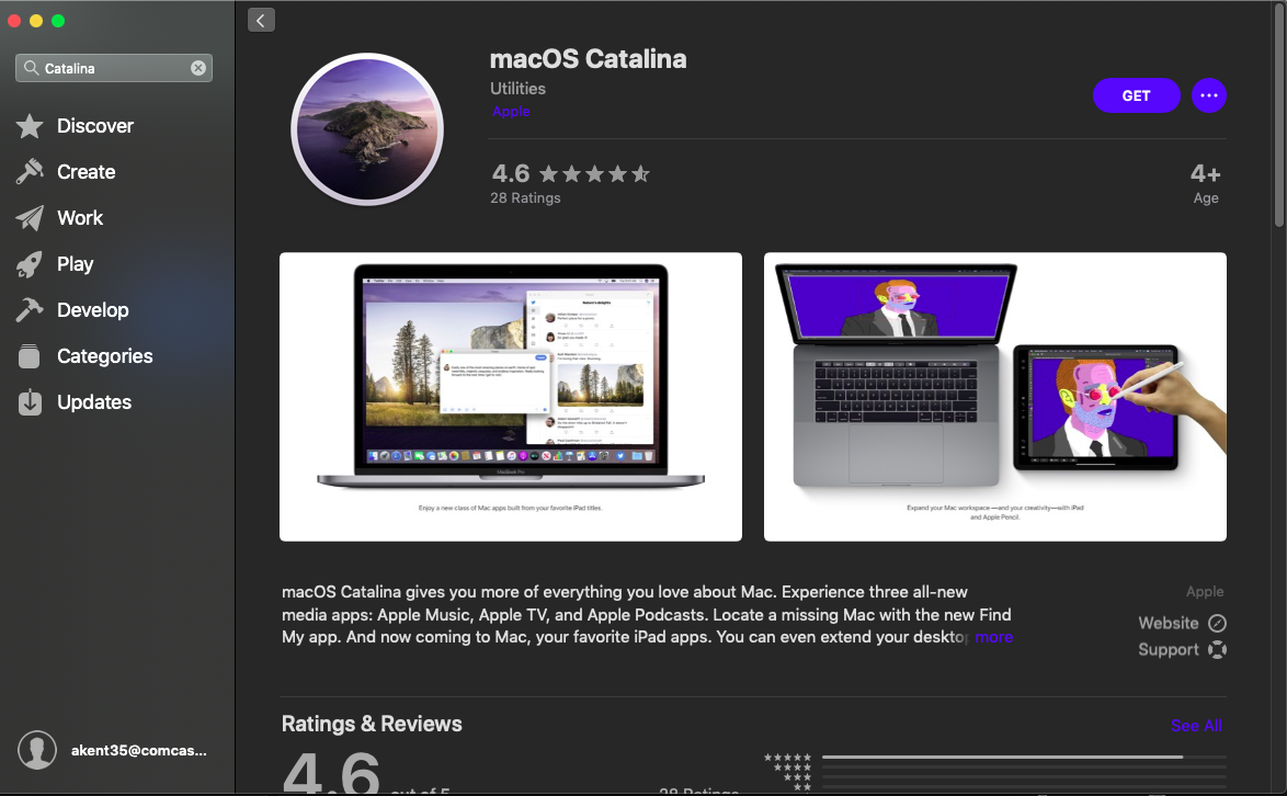

Clicking on "View" gets me this:

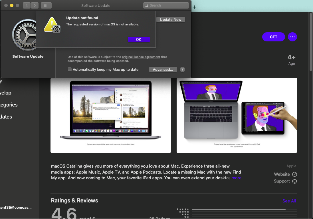

But when I click on "Get", it (eventually) says:
I'll just wait a little longer.
But when I click on "Get", it (eventually) says: "Update not found"
Sounds like you've been bit by the bug. I don't think waiting will help at all, I've got machines that have been stuck in this state for over a week now. You're in that state where System Preferences can't figure out what to download. You might try the suggestions that I and others have posted up-thread when you decide you want to upgrade.
