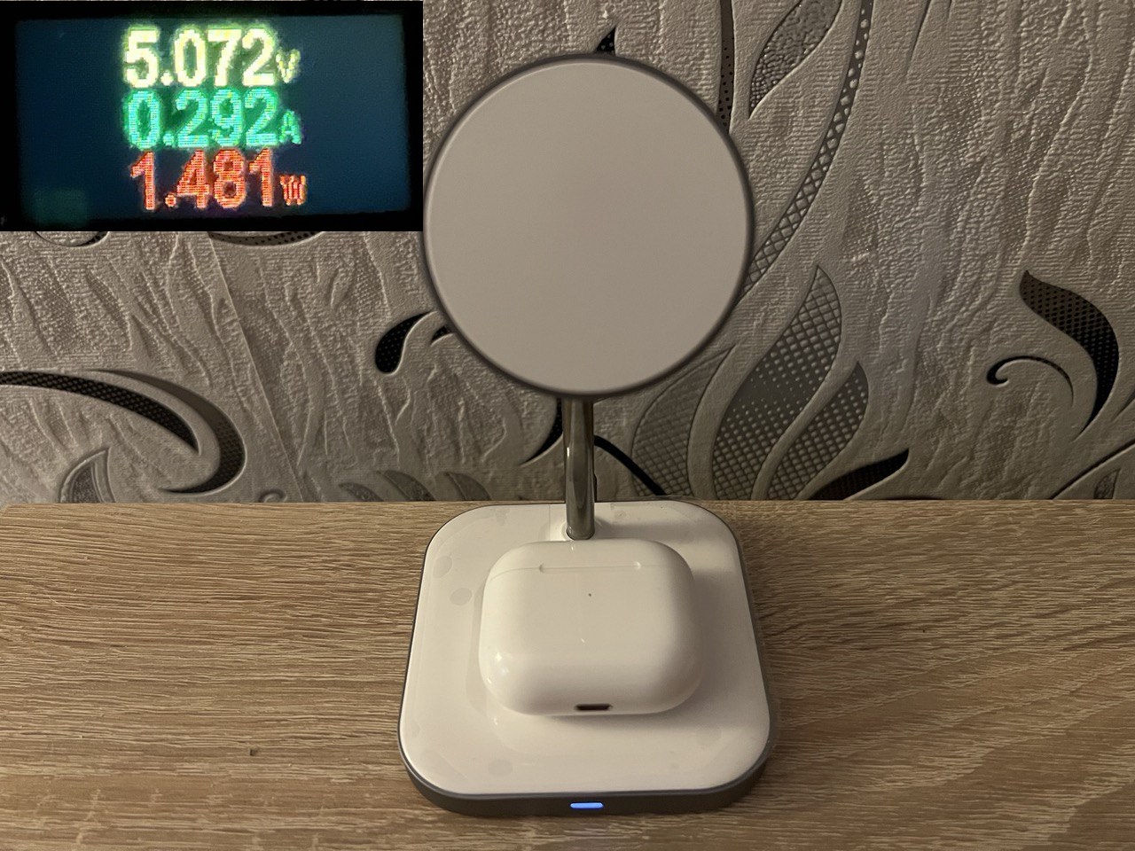

Hello! I bought airpods v3 and wanted to use them with qi wireless charging. But I noticed one unpleasant feature. When the airpods reach 100% charge, wireless charging does not stop the current supply (at the level of 1 watt), which causes the case to constantly heat up. I tested this on two wireless chargers: Satechi 2 in 1 and HyperX ChargePlay. Since I leave my devices to charge overnight, and the headphones on the wireless pad can spend a longer time, how much does it harm them? After all, when I removed the airpods from wireless charging, they were warm. Share your experience.

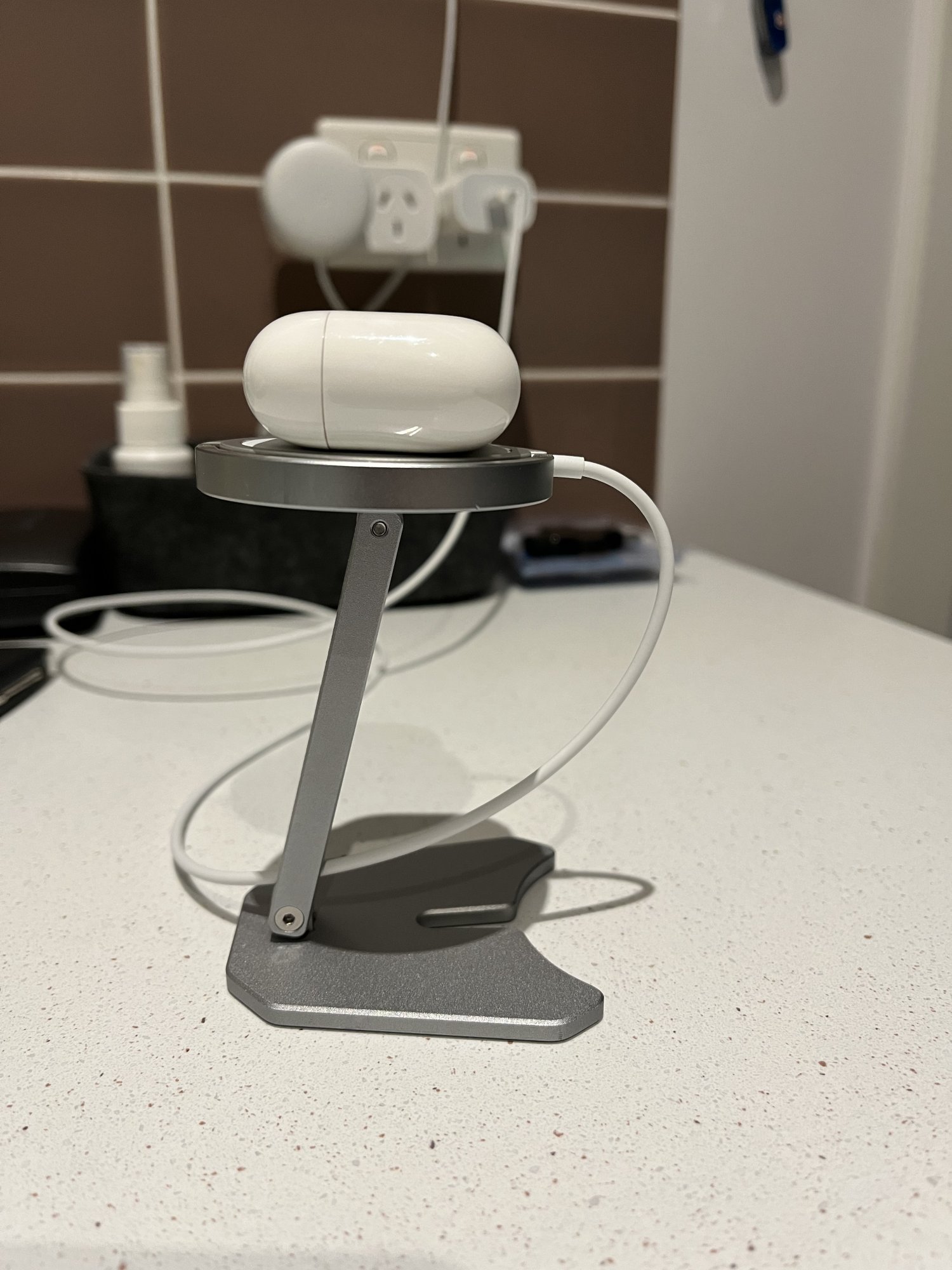

I stopped using it because the heat was surely wearing down the batteries faster, & just purchased an Apple MagSafe charger & placed it in a holster stand & now they charge fine.

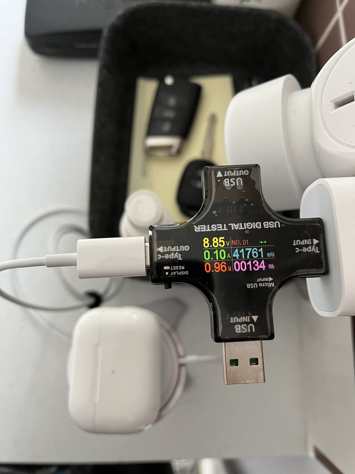

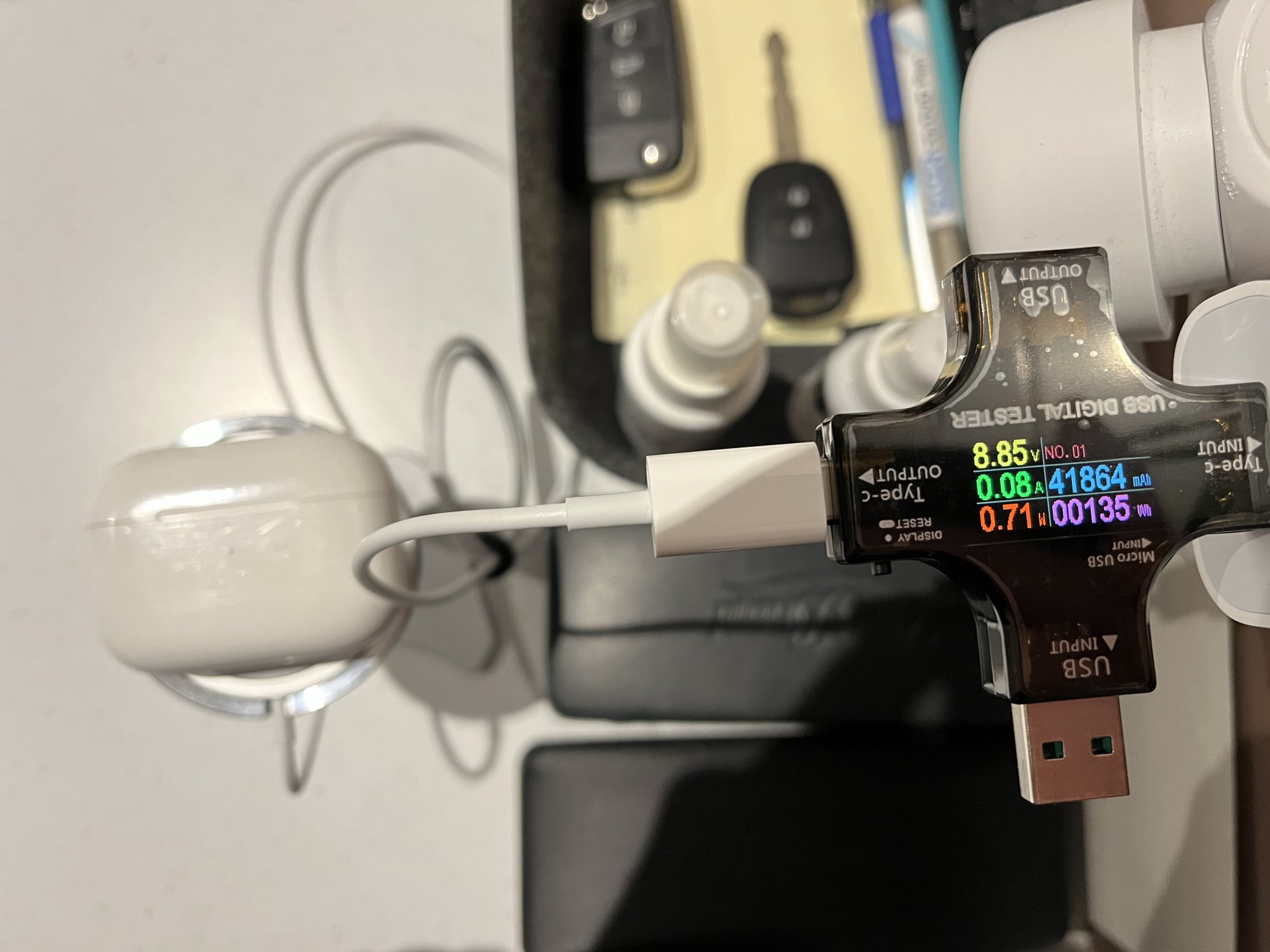

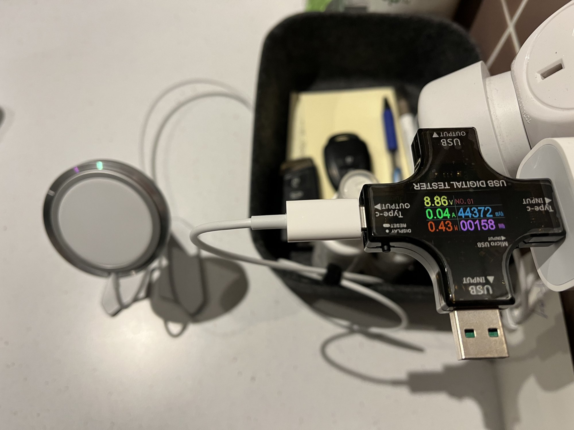

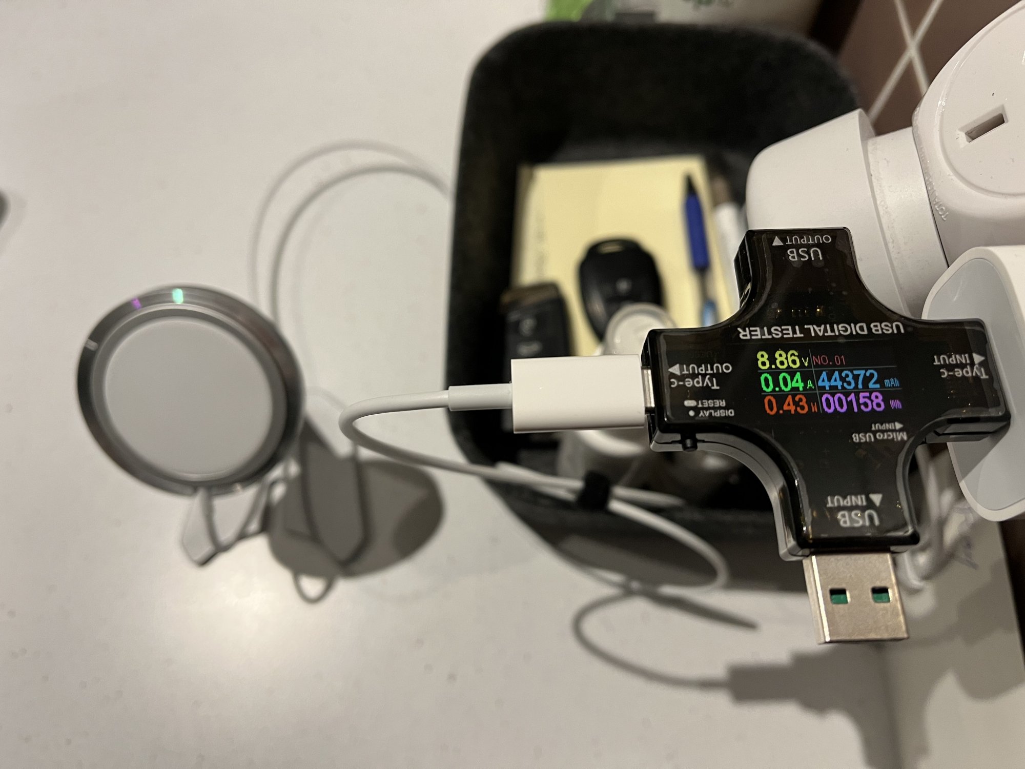

I’ll add a shot of my power meter once they reach 100%, to compare readings…
Here you go…
& the case only gets slightly warm. But I’m pretty sure if I leave it on there longer, it gets even cooler.
How warm is yours? Closer to hot, or just detectable?

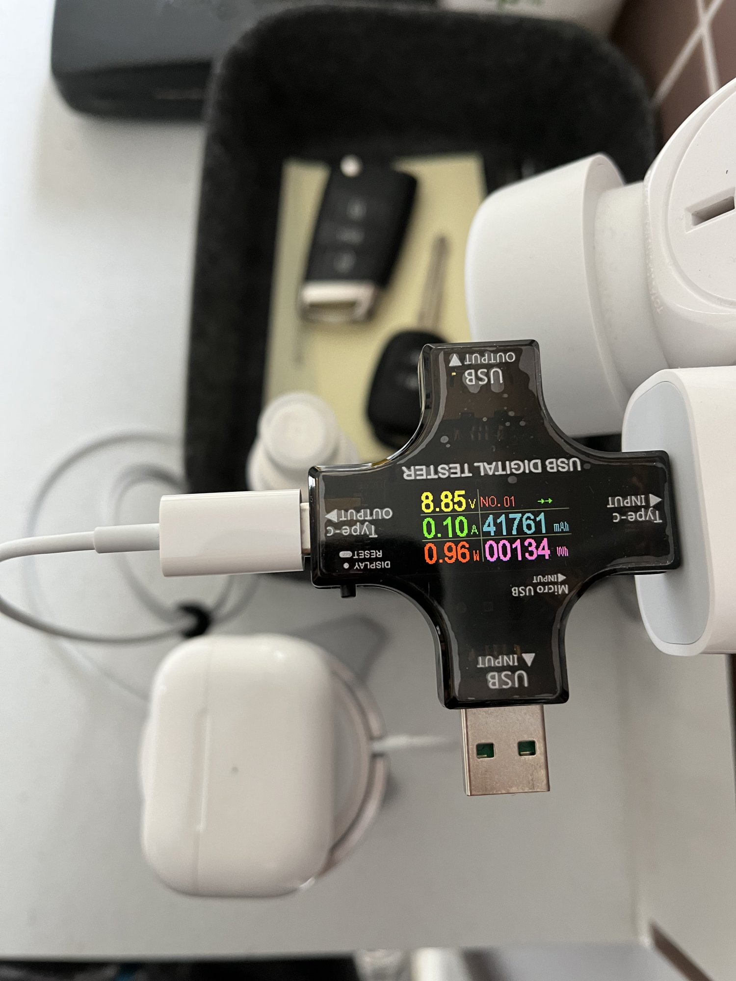

Here you go…
I see that the original Apple MagSafe charger also draws 1W of power (as is the case with my wireless chargers). Therefore, airfields do not know how to signal wireless charging: “Hey, stop frying me!”

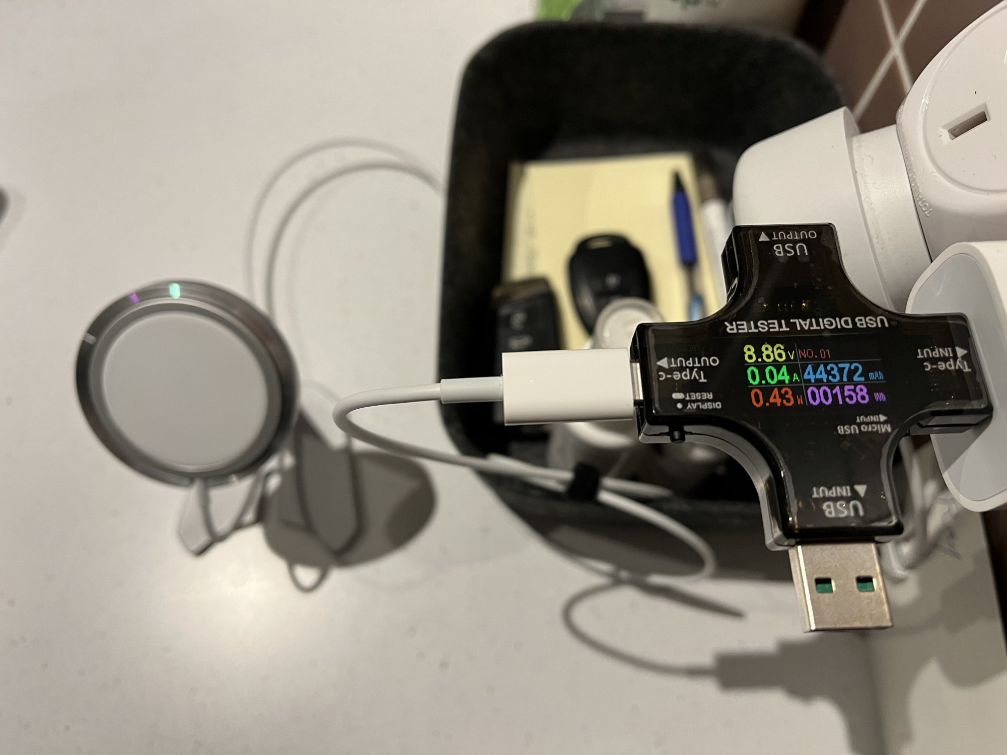

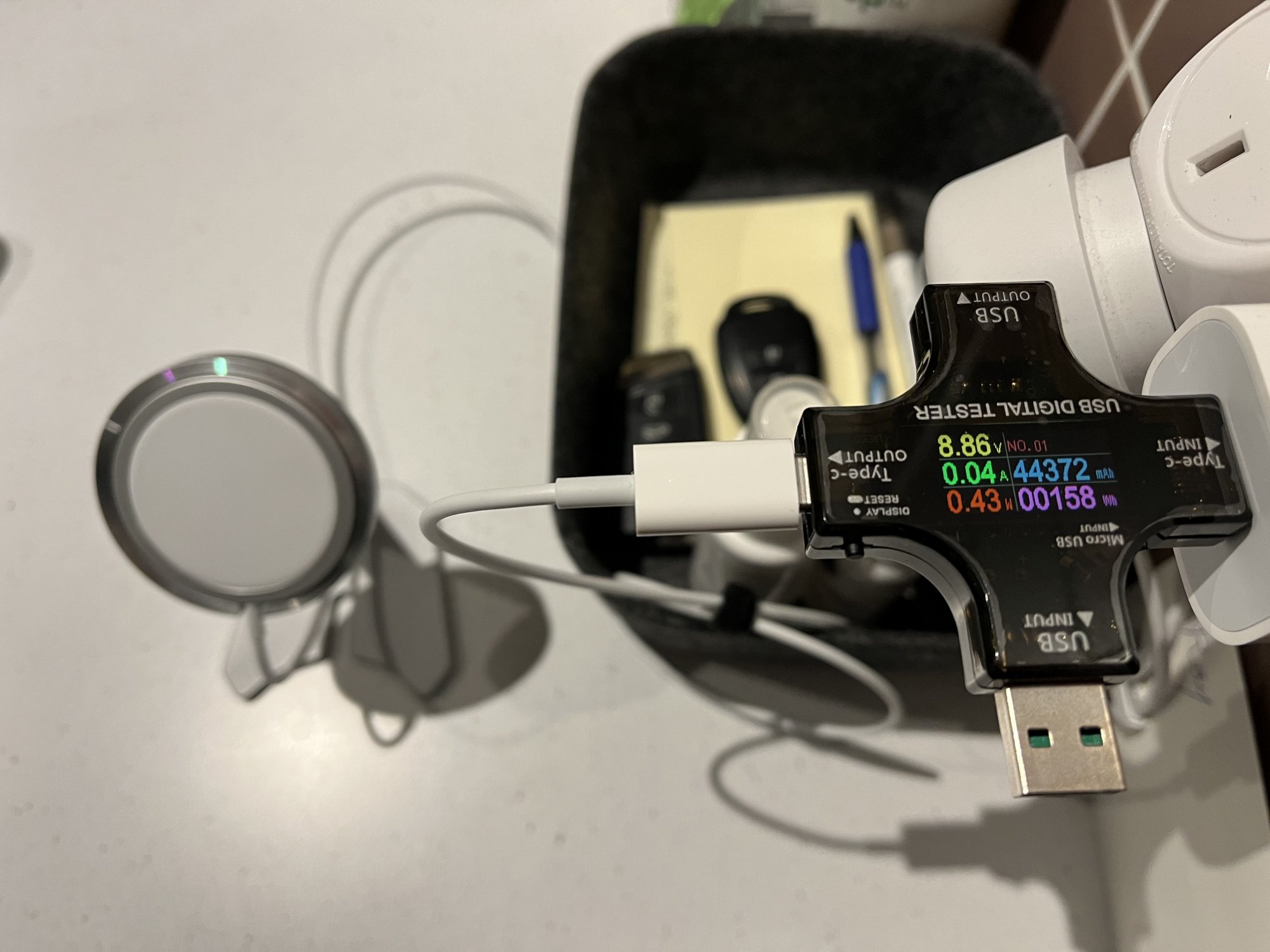

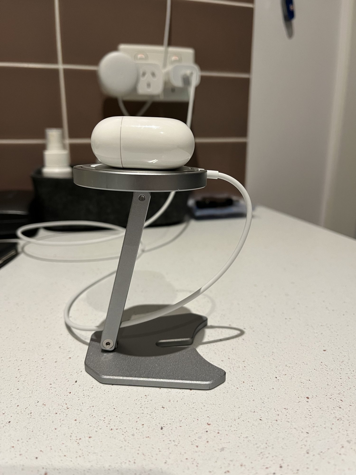

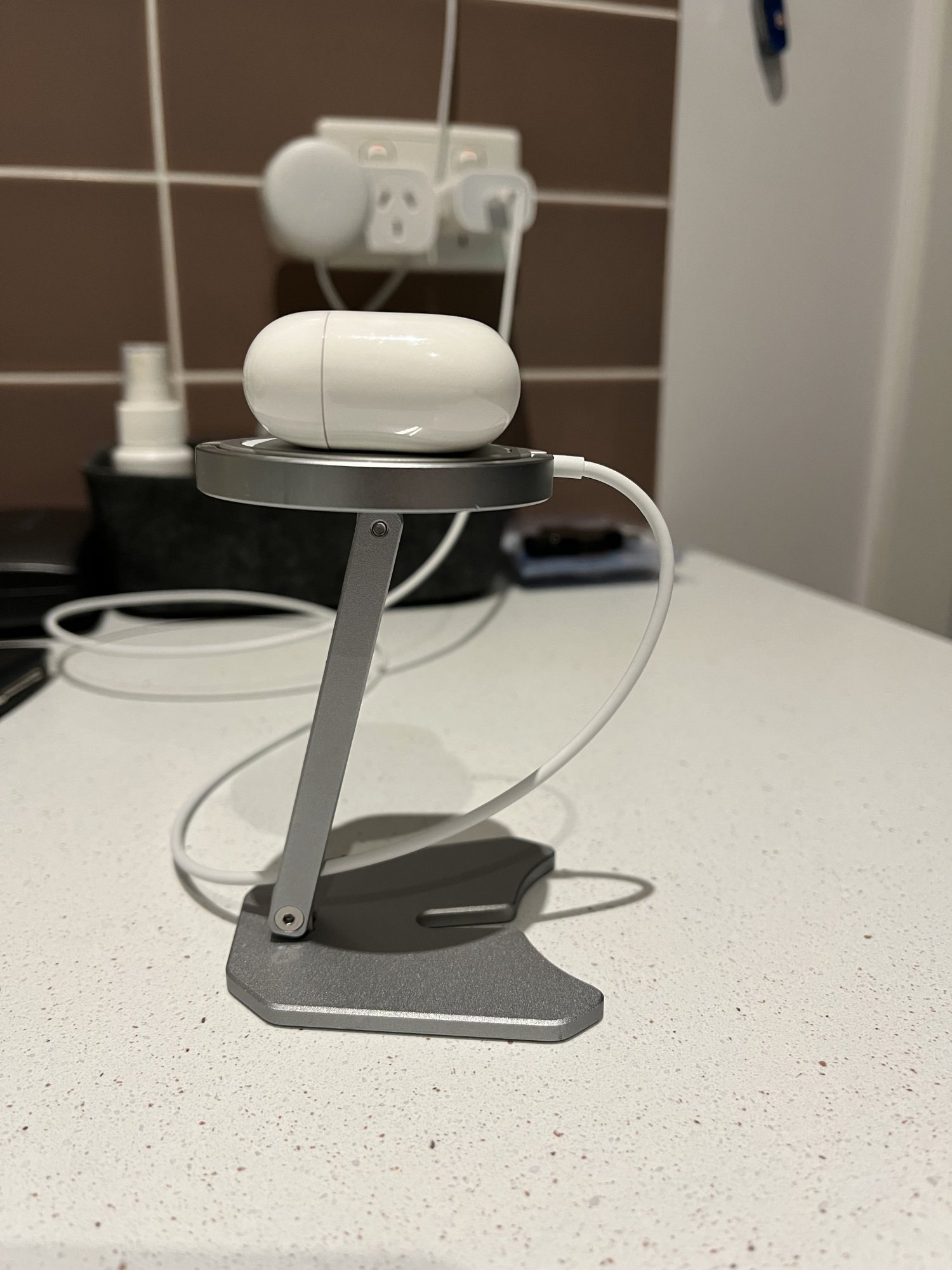

Here’s another photo, this time after a night of being left on the MagSafe charger.
The AirPods case wasn’t warm at all, so it felt like charging stopped completely…

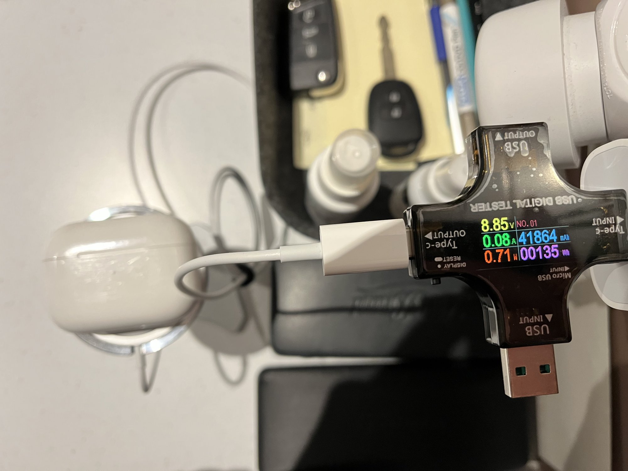

It is a hit and miss. With my AirPods Pro and MagSafe+MagSafe duo mostly they will be cool to touch when 100%, other times same as regular, warm case
Just fyi, even with nothing on the MagSafe charger, there is still a small amount of wattage going through the adapter, but the smart charging of the iPhone probably stops utilising it once full, hence why it’s cool to touch, as it should be.
but 0.43W its not 1.481W
