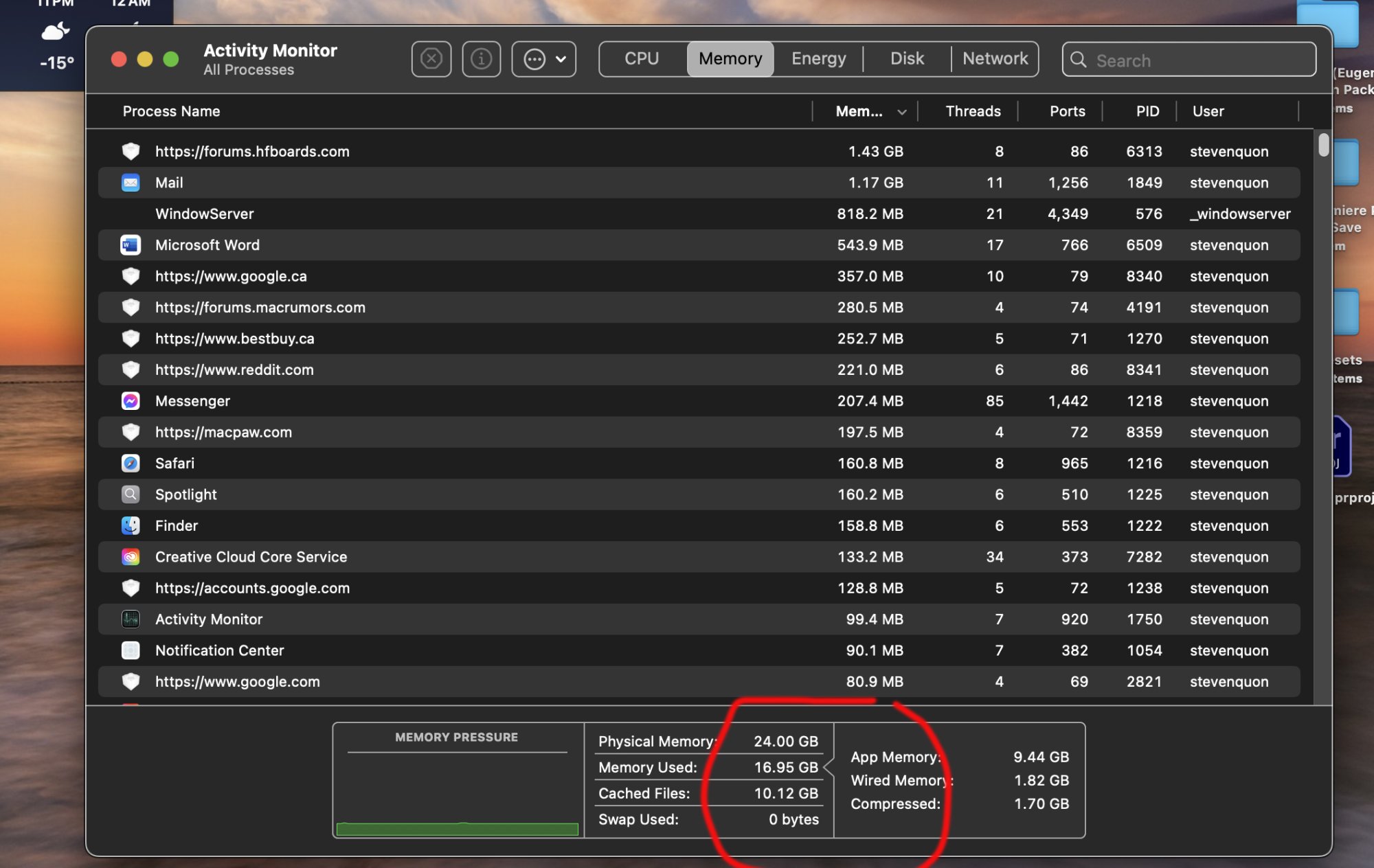

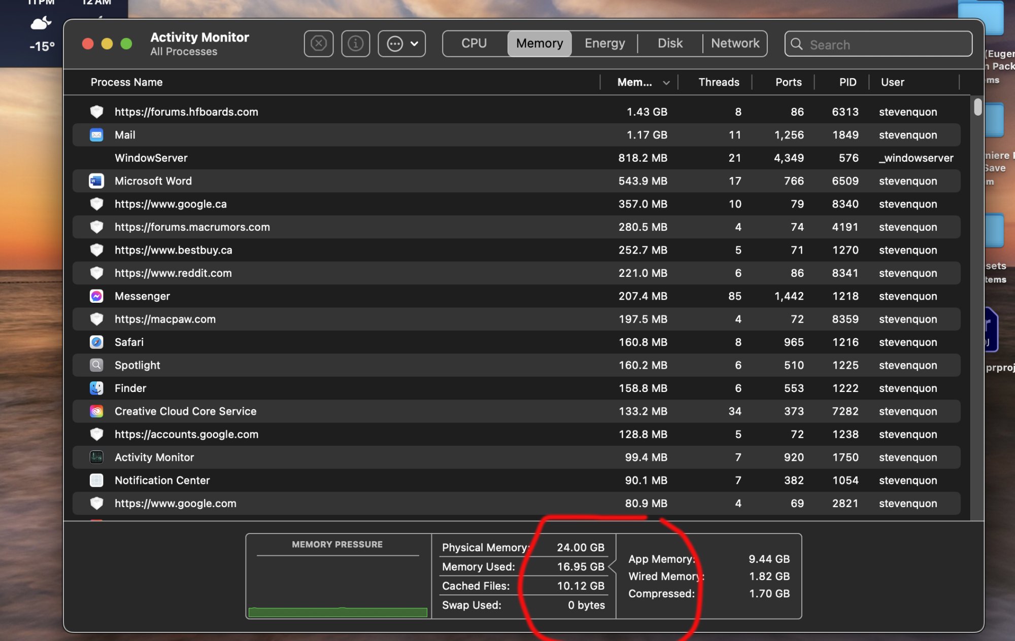

I have literally nothing at the startup. On my M3 Air with 8GB, it has the same stuff at startup but it only uses 6.0GB. Now on the Pro it's using more than double? Seems rather high.
Putting aside the whole how does Mac manage memory issue, few notes from your screenshot:
  • You're not litterally running nothing -- you have several websites open (in I'm guessing Safari), Apple Mail, Messenger, and a few background processes (e.g. Creative Cloud Core Service)
  • Ignore Cached but Memory Used is relatively high for what you are doing. In particular, App Memory and Compressed.
  • I am surprised how much memory is consumed in modern web browser by some websites that resemble BBS of the 80s and guessing that relates to various monetization schemes behind the scenes (e.g. tracking technologies). As such I would look into ad blockers and the like.
  • Apple Mail usage looks high to me but I am not on Sequoia and therefore its Apple Mail. Up through earlier macOS, my Mail thanksfully consumes 50-150 MB even with large IMAP/Google mailboxes. Since I am not sure your Mail's RAM usage is something particular your mail setup or Sequoia, can't offer much advice at the moment. If the latter, your alternative is to find another e-mail program and there's none I can recommend (I also use Thunderbird and find it less efficient than Apple Mail).
  • Since you've still got plenty of headroom, I would grab any easy wins now but not worry about overall usage. Understanding where RAM is wasted and addressing thing you can't justify will make it easier to run anything big when the time comes.

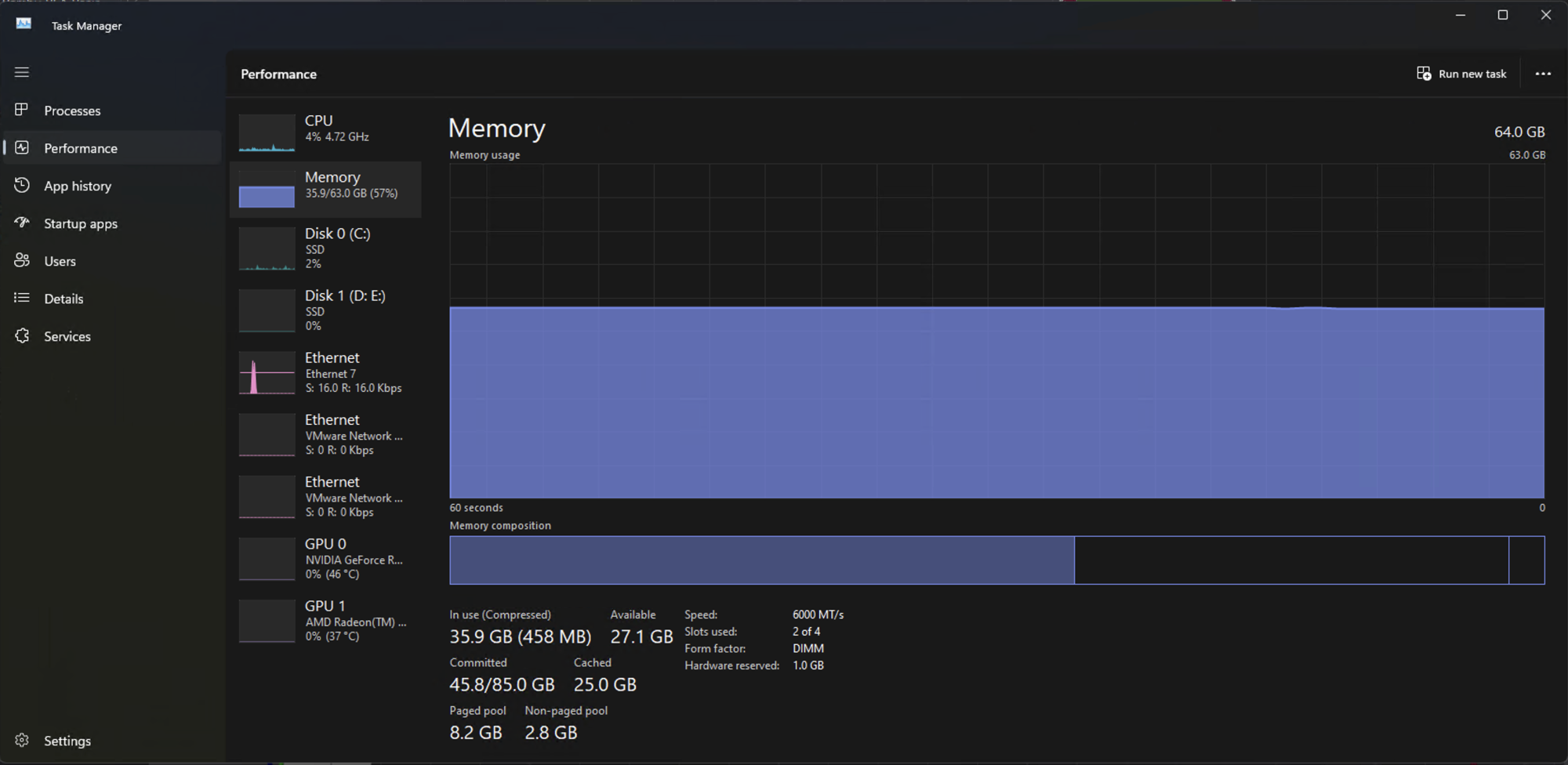

Windows does it essentially the same way. You just are looking at RAM like it is still 1999. When RAM went from scarce to plentiful Operating Systems adjusted to using them as caches to greatly improve performance.
Most people don't understand how RAM is used so I suggest people to not look at it unless they have a reason to look at it and understand what they are reading. Otherwise, they end up doing more harm than good. Start tweaking crap to "free up RAM" and overspending to ensure they have "RAM left free"...

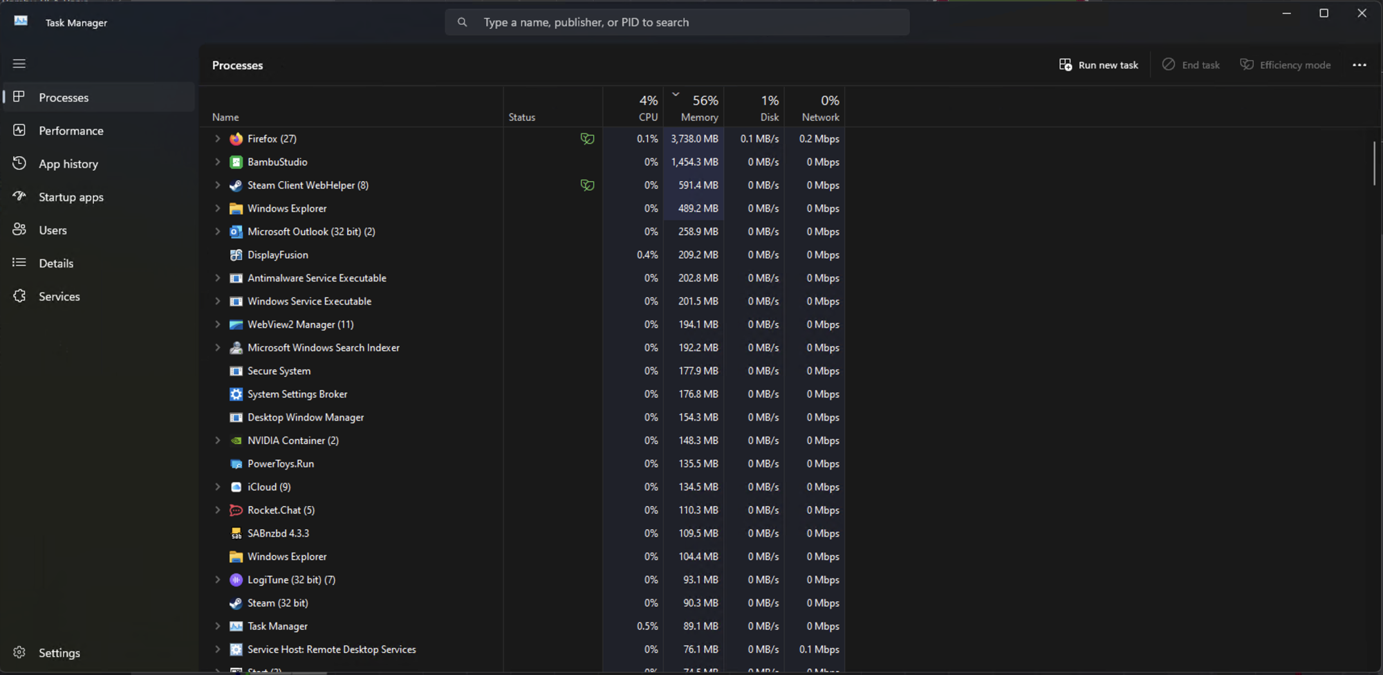

This is my Windows desktop with 64GB of RAM. If you looked only at the memory tab you'd see me using almost 60% of my RAM, but if you look at the things I'm running it is almost nothing. Firefox, Bambu Studio, Steam and some background processes. An in experienced user would incorrectly think I couldn't run this same load on a machine with 16GB or 32GB of RAM. They'd be very wrong.
Apple makes it easier as they add a memory pressure graph to try and help demystify it. Windows doesn't offer any such guidance in its graphs that are easy for a lay person to grasp.
