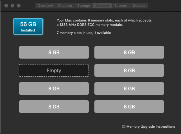

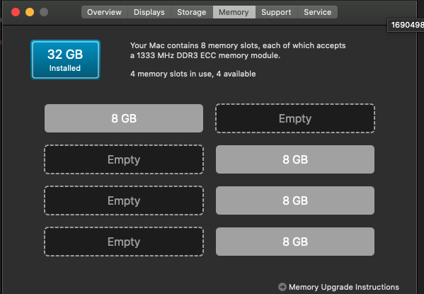

Just last night, two were out. Now 3 are out.
Questions:
1. Can the replacements be any 1333 MHz DDR3 ECC 8GB sticks?
2. What causes memory to die like this?

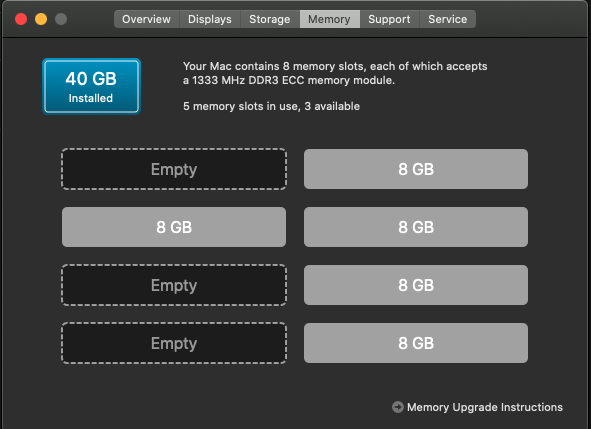

UPDATE: Since first posting, I have done two restarts, moving the sticks around to reseat them each time. Different numbers of sticks come online each time. Why the variation. All these screen shots were made in the last hour.
How did some sticks come back to life?
  • Wow
Reactions: ZombiePhysicist

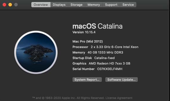

I see you have upgraded CPU's. According to various posts on the forum: if the processor cooling towers are too tight or unevenly tightened it can cause memory problems just like yours. I guess the CPU-tray bends when the towers are tightened too much.
However, I do not know if this applies to your 5.1 too or if it applies only to those machines with 4.1 CPU-trays though. More wiser ones will comment on this, I am sure.
The memory controller is inside the cpu. If not all contacts make good contact this could be a reason.
Another reason could be oxidation of the ram sticks / ram slots.
Plug the machine off and carefully reseat the ram sticks 5 times.
one could also clean the contacts of the sticks with isopropyl. Avoid aggressive sprays.
Reactions: danallen
The CPUs were in the computer when I bought it in 2014
