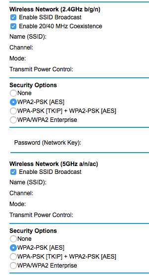

Odd question but is your router's 5GHz wireless encryption set to WPA2-PSK (may be called WPA2-AES) only? So no mixed or legacy modes (e.g., WPA Auto).
If not, could you try to set it to that mode, then restart your router and try again? Just to reassure you that this won't cause any conflicts with devices already connected, beyond maybe re-entering credentials.
Yes, both the 2.4ghz and 5ghz networks are set to WPA2-PSK [AES].
Thanks for your help in trying to resolve this.

I would check your router's QoS setting and be sure that WMM is turned on for your 5ghz radio.

Somebody with your router has suggested the following, but not sure where it would be in your router settings: "Enable QOS checkbox and then press the Update Now button"
Does that make any sense to you - or does that work?
