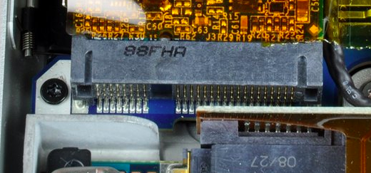

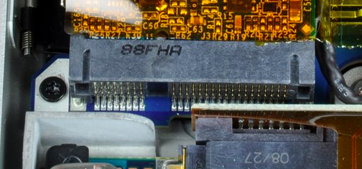

Separately, if available, grab a soft brush (an old, very soft toothbrush might also work) and gently clean out the PCIe socket — with gentle strokes parallel with the length of the socket. You’re not trying to be abrasive with it, but you are trying to move out any dust accumulation which could have dislodged itself when you took it apart previously.
After doing all of that and inspecting the socket area, take especial care to re-insert the card evenly and completely. Also, while you’re down there, try to inspect with a bright light and a magnifying glass to see that the PCIe socket’s connection points to the board look OK (and no hairline fractures or places where the solder appears frayed):
