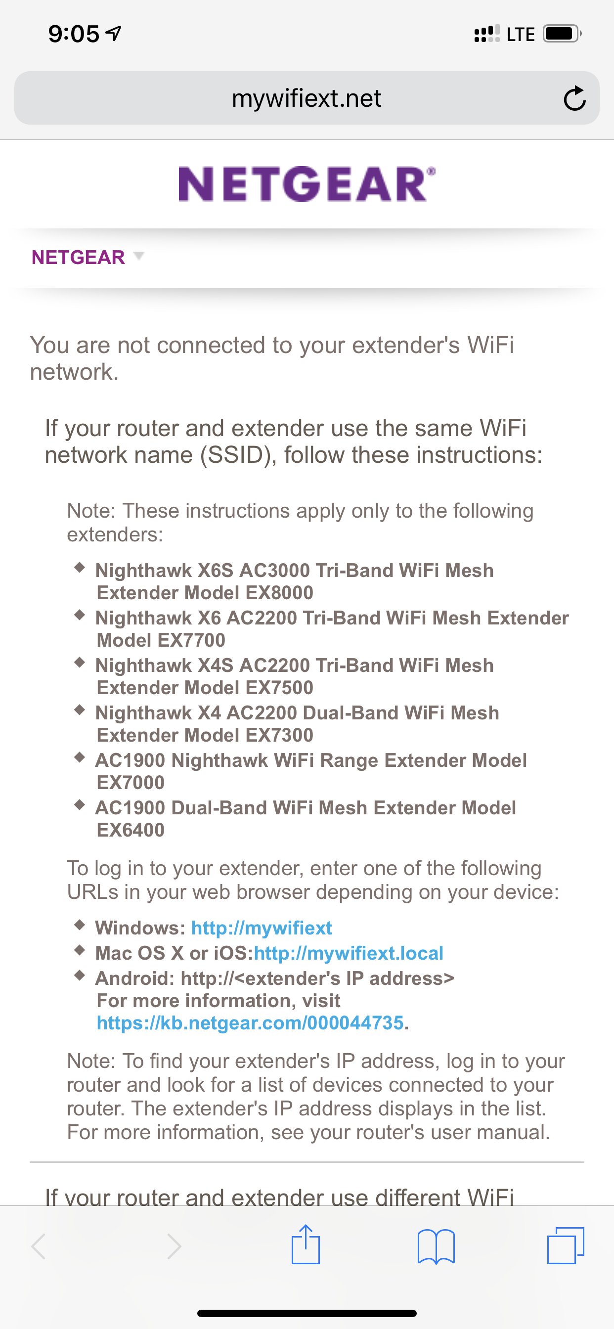

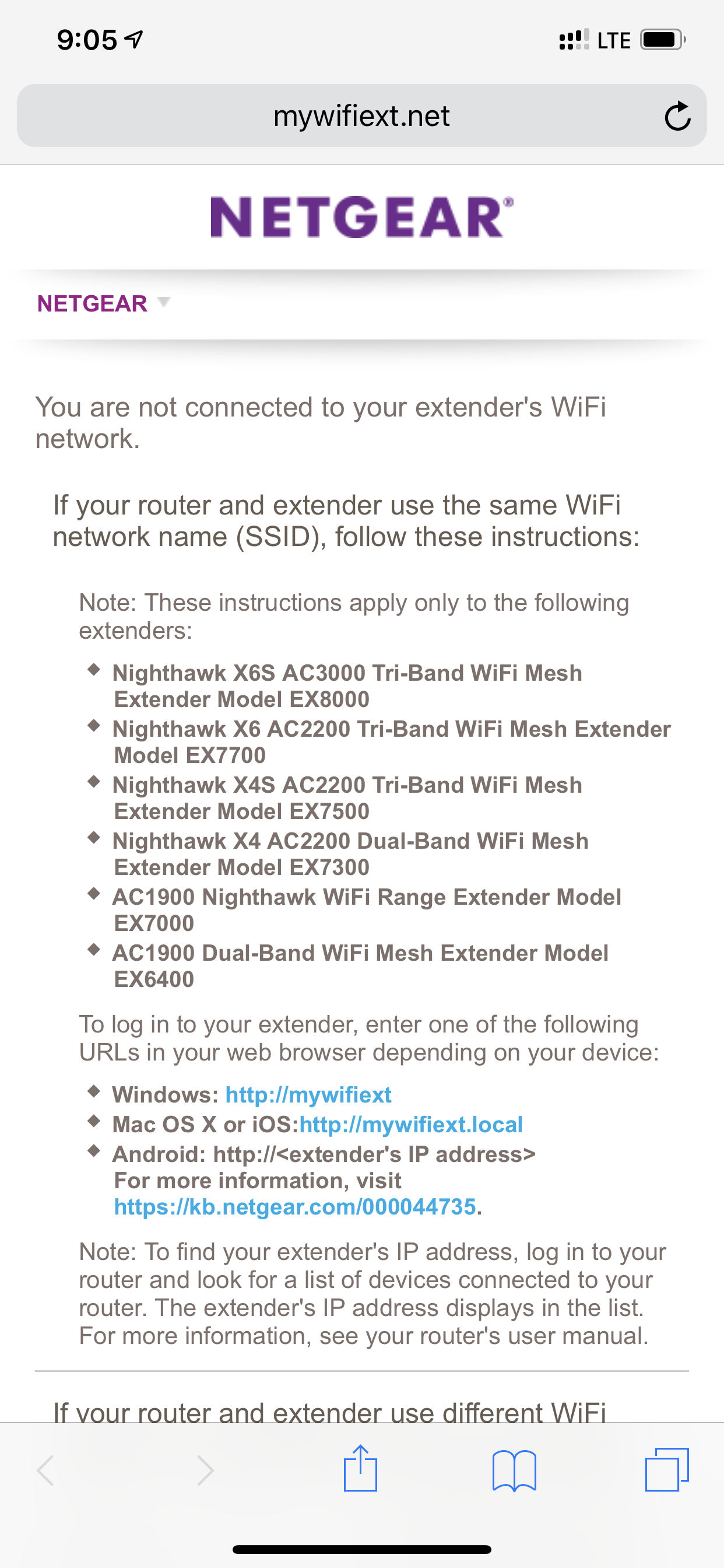

Not all of the time. I’ve tried that but it connects over to the main router again. Sometimes it’ll connect to the extender upon turning the WiFi back on, but it’ll only do it about 1/3 of the time. I can’t get a consistent behavior with it. I test it by trying to visit the Netgear extender’s portal, but if I’m not directly connected to the extenders WiFi signal, I’ll get this error page.
