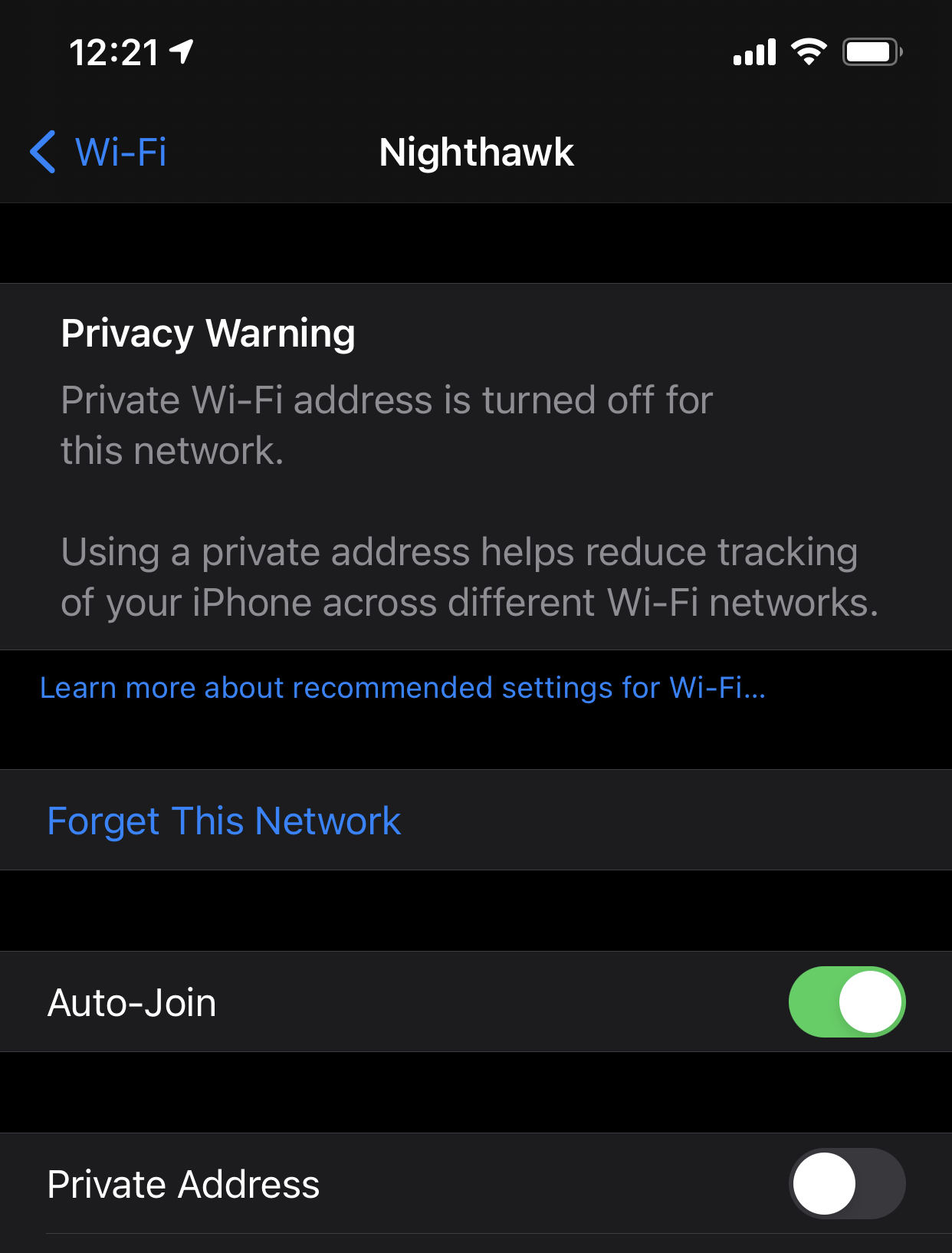

The common problem, from other threads on WiFi on iOS 14, was the Private Address toggle in when you go into the WiFi settings of the network you’re connected.
Go into that and turn off Private Address. That’s likely the solution for you.

Turn this off, you don’t need it on for your home network and is likely causing your issue.
Only need it on for public networks, like when you go to a coffee shop, etc.
I tried that too, turned it off and rejoined. Still the same result. Poor speeds and lots of jitter

Just turned off the privacy thing.. hope that helps. wifi on my iPhone X and 12 Pro Max has been shocking previously
