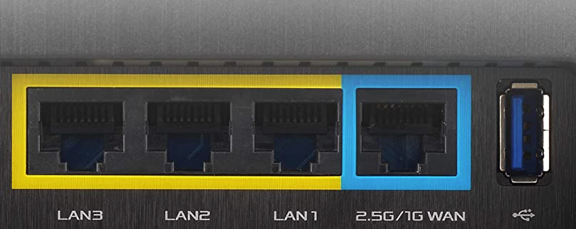

Maybe it would be easier to look at the WAN Ethernet port on your router, sometimes it is marked at the highest link speed, is it 2.5Gbps or higher? Like this one (one in the blue):
