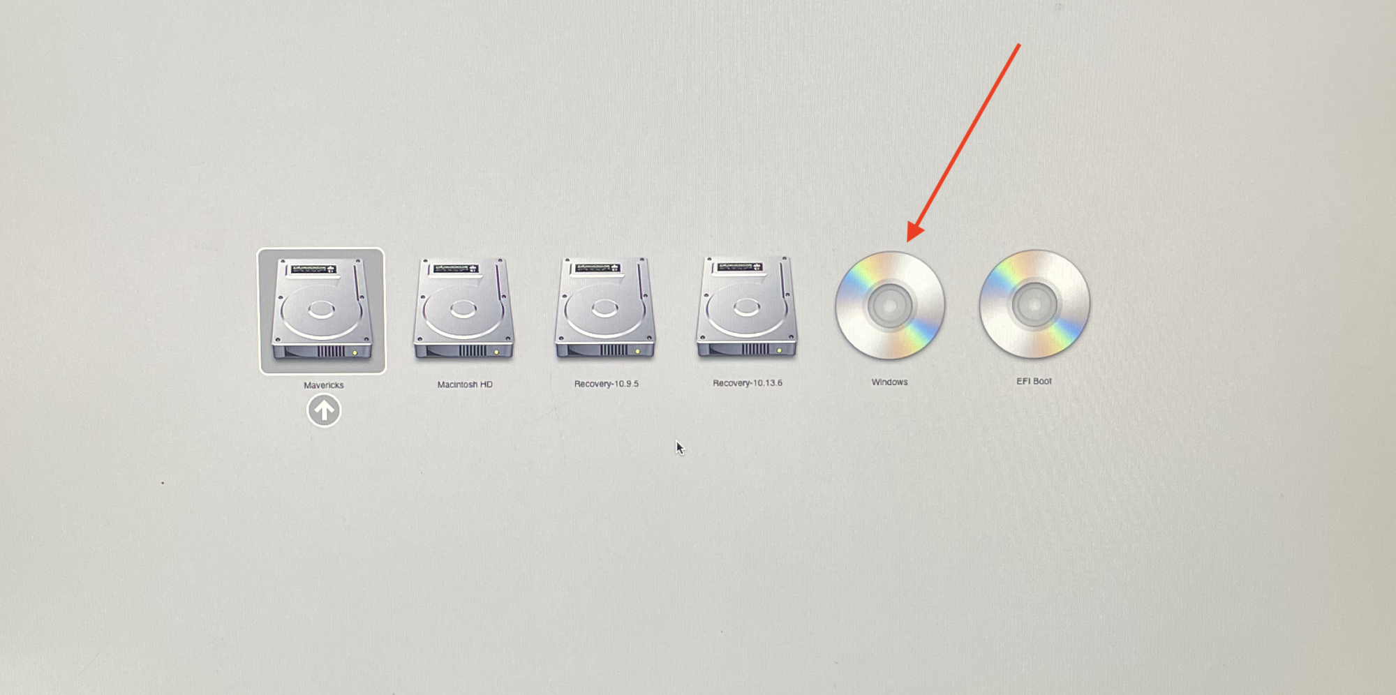

how do i know if im booting into EFI mode? sorry for the stupid questions 😂
The two disk images on the picture are from the same disk. The one with the EFI boot on it should not be selected at all.
