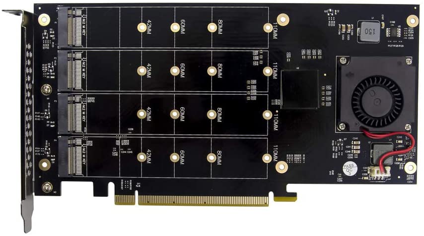

I have a NVMe card from Aliexpress, which seems to be some kind of HighPoint 7101a clone, runnig in my 5,1 (see picture)
Card works perfectly fine in macOS with nice performance, as one would expect from the "original".
But in Windows 11, as soon as 4 blades are mounted to the card, i get repeated "USB overcurrent"-error messages after booting and within 30 seconds or so Windows just crashes with a blue screen. With only 2 blades mounted, Windows runs fine without any issues. Of course with the SSDs not beeing usable as they only have Mac volumes on them.
Anybody experienced similar with a HighPoint or any solutions known? Thanks in advance.
This is card is definitively not a clone, maybe you can say that it's design is inspired by the SSD7101A-1.
My SSD7101A-1 works perfectly with four blades with macOS/Windows/Linux, never had any troubles.
Yes, PCB-layout looks somehow identical.

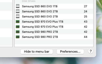

As the 5,1's PCIe-fan blows directly into the card's heatsink from the back, this does not seem to cause any problems. These are the temps of the SSDs idling with an ambient of about 25ºC:
Even with looping Blackmagic for about 15 minutes, the 980s don't exceed 60 degrees. The 970s get a bit warmer.
