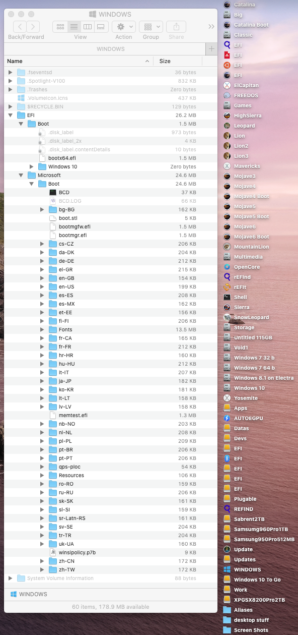

I don't think you have to reinstall Windows. You just have to fix the Windows EFI boot stuff. The folder structure of the EFI partition should look like this (I put the Windows EFI stuff in a separate partition called WINDOWS)
The folders you need to start with are:
Code:
EFI
    Boot
Microsoft
    Boot
The bootx64.efi file is a copy of the bootmgfw.efi file.
Maybe one of these will work:
After that, you should have most of the files/folders that I showed.
