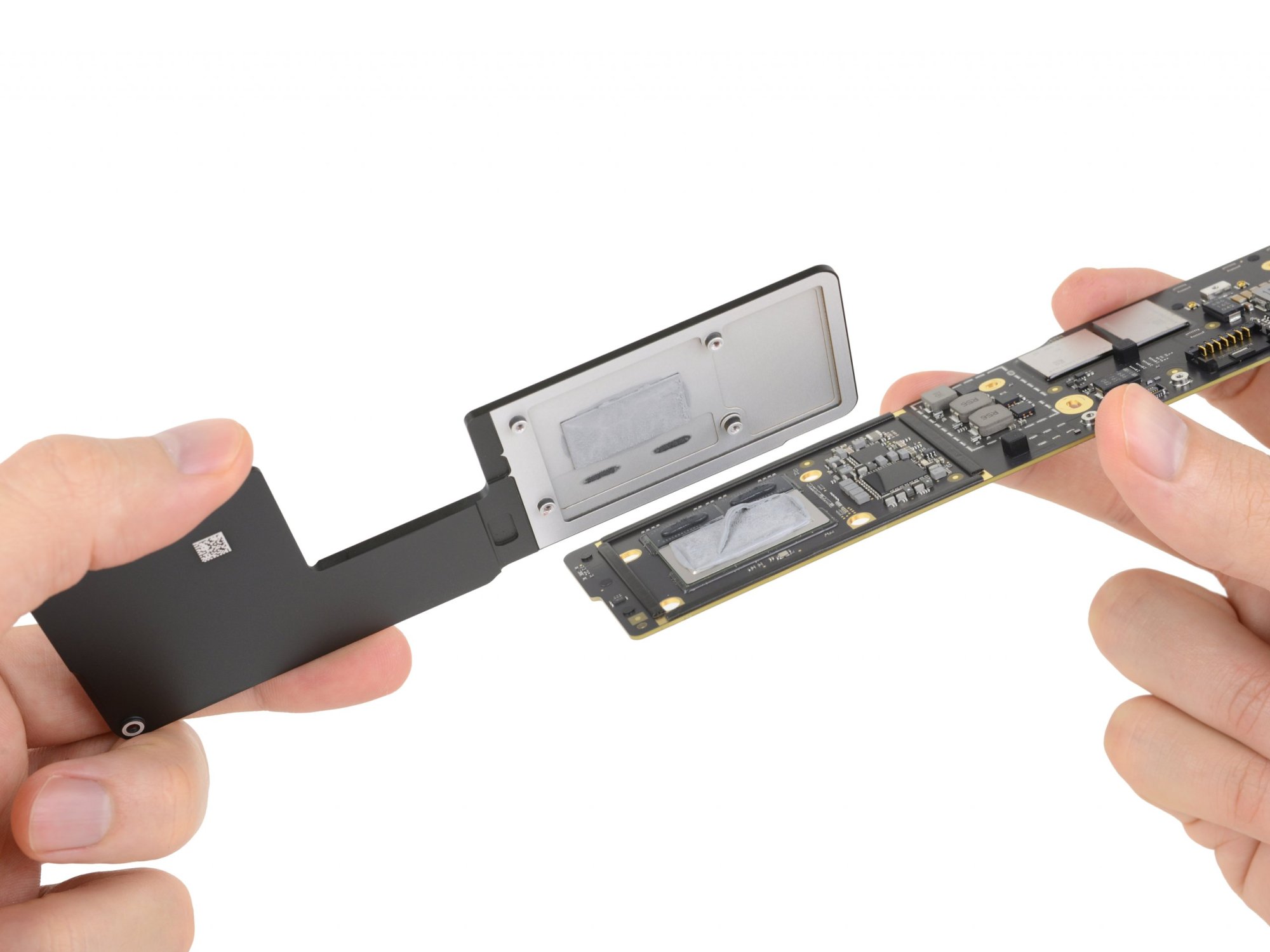

Sure. Last idea, you could send the device to rossman repair group in Texas, maybe they find a cheap fix, then it's worth more for a sale and you can get the data removed (or keep using it).
Or if you are taking it apart anyways, you can submerge the logic board in 99% isopropyl alcohol (cheap on amazon), gently clean every spot with a toothbrush, then let alcohol evaporate for 24 hours and assemble again. That will get rid of residue from fluids and if no permanent damage was done it should fix the issue altogether. Remove the heat sink beforehand as it prevents access to all components for cleaning. See attachment, taken from ifixit. MBA_M1_2020_49_v1-scaled.jpg
