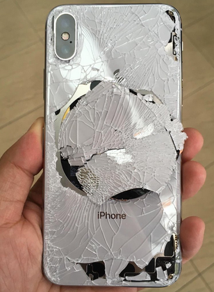

If you look at the shattered X, the circle is where the wireless charging is. If you can fit yours below it, it may work.
