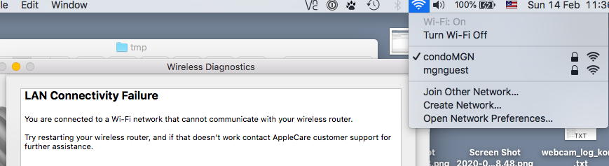

I have a remote 2010 MBA that failed to reconnect to an AirPort Extreme after a power outage. It is set to automatically connect to the Extreme's SSID. I ran Wireless Diagnostics but am confused by this message from the Assistant:
You are connected to a Wi-Fi network that cannot communicate with your wireless router.
At the time that message was generated the MBA was connected to WiFi, was able to connect to the Internet and I could use Airport Utility to check the Extreme's settings:
What does that statement actually mean?

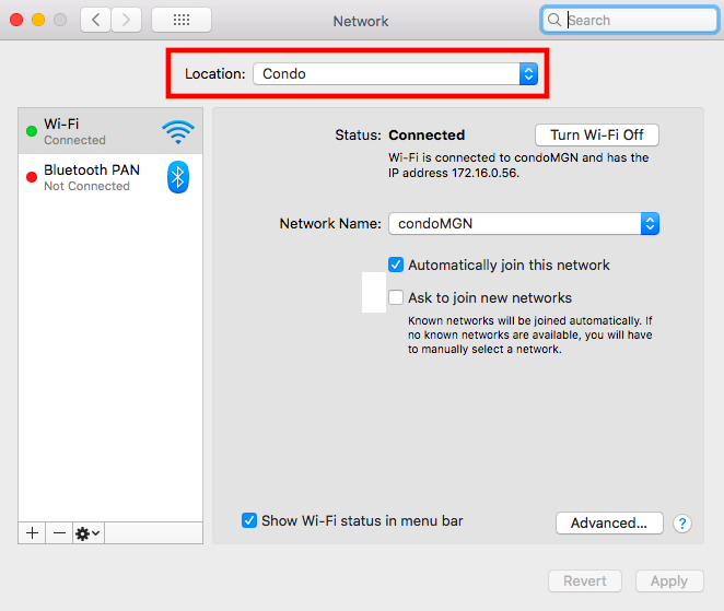

Then if you running an older version Of OS X then try this step:
System Preferences->Network pane, at the top of that pane is the 'Location' pull-down. Use that to select 'EditLocations ' and in the pop-out click on the + symbol to add a new custom named Location (calling it what you like) and then saving that in the pop-out, Network main page. Don't worry because it will act the same as 'Automatic', you just giving it a custom name. Then Use the System Preferences->Network pane, Airport card to rejoin your wireless network.
OK. I’ll give Locations another shot. I won’t be visiting that site until mid or late March, so will have to wait until then unless you’ve got an idea of how to do it remotely.
That machine has both a reverse ssh tunnel and a VNC server.
I don't understand why you say that. I have carefully read and responded to every suggestion you have made. When I replied to your suggestion about using a Location I was away from home and wasn't able to log on remotely to check. As soon as I got home I logged on to the machine in question to see whether or not I was already using a Location on that computer. As you can see from the screen shot I posted I was indeed already using a Location in the Network preferences.
