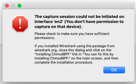

I now have Wireshark version 3.4.0 and Catalina version 10.15.7
When I try to open Wireshark, I get the following box:
This has been going on for some time.
Is there something simple and permanent I can do to get Wireshark to open every time?
Right now, the only way I can run it is to open Terminal and run this command: sudo chown username:admin bp*
After that it runs OK until I reboot or shut down.
Tom

I tried looking at hidden files using Finder and was not able to find "access_bpf." I did do cd /dev followed by ls -l bp* and got five files listed. Each of them showed the owner is root, I think, as the first line showed:
"crw--------- 1 root wheel 23, 0 Nov 8 13:42 bpf0"
The other four were similar except for the date and/or time and of course the numeric digit at the end of the filename.
I'm relatively uneducated in this aspect of MacOS, so perhaps I need another nudge...
Tom

I also should mention that if I open Terminal and enter
cd /dev
that Wireshark works fine until a shutdown or reboot.
Tom
