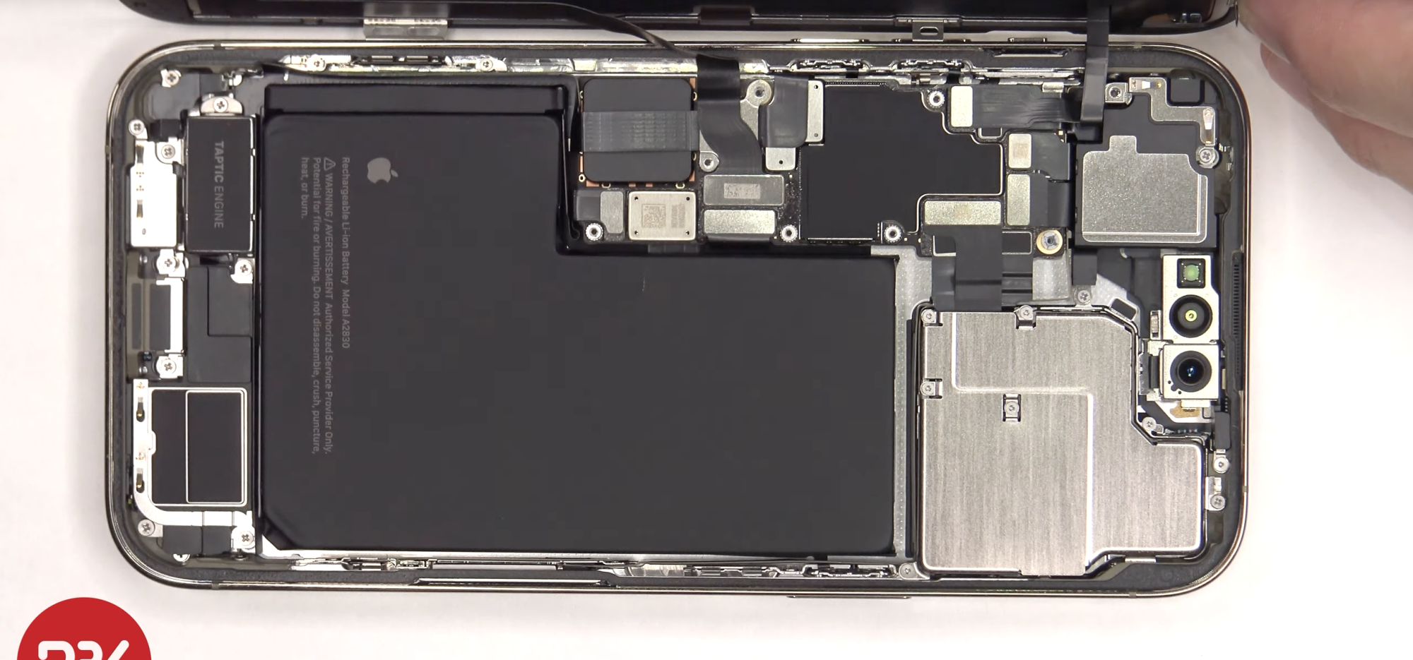

I'm sure the internals of the phone were designed with the removal of the SIM slot in mind, meaning Apple would have more space to move things around as needed, it's not like they would have designed the board with a void and just left it there. Updated components, the addition of satellite connectivity, the phone is also .2mm thicker than last year I believe, so who knows how it looks now. Looking forward to iFixIt's teardown.

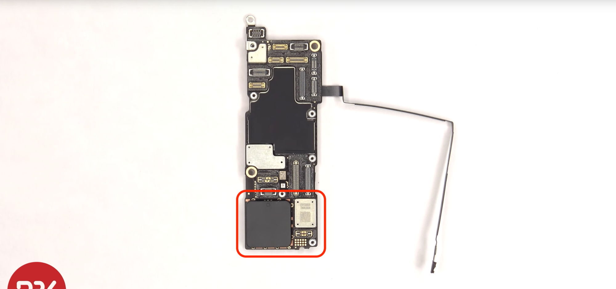

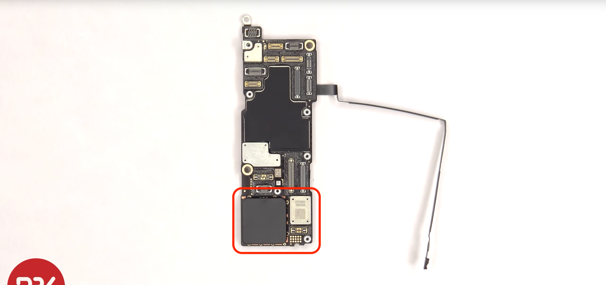

Confirmed, Apple literally just put a plastic spacer over the area. You can even see the solder pads for the SIM slot. It's just missing the slot.

The reviewer/disassembler believed that black module that looks like a spacer could be the satellite module, did not mention a spacer. Whether or not it is a spacer or actual logic, he points this out at 5:34 in his video

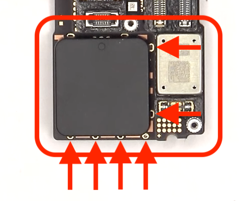

It doesn’t make any sense because there is no such thing as a “satellite module.” Globalstar uses the Qualcomm chip, specifically band n53. Look carefully and you’ll see circular copper pads underneath the spacer that are ready for mating to a component. That spacer clearly doesn’t mate to any of those copper pads.

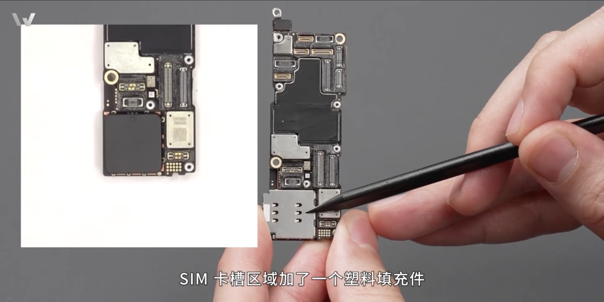

Here's what the non-neutered version of the iPhone 14 Pro Max logic board looks like.
