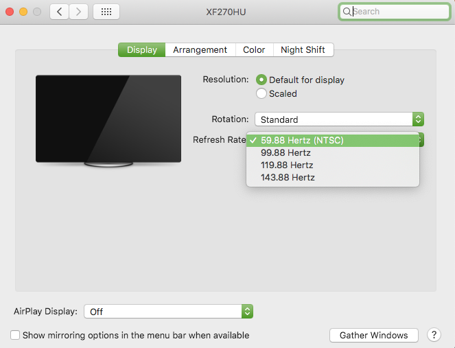

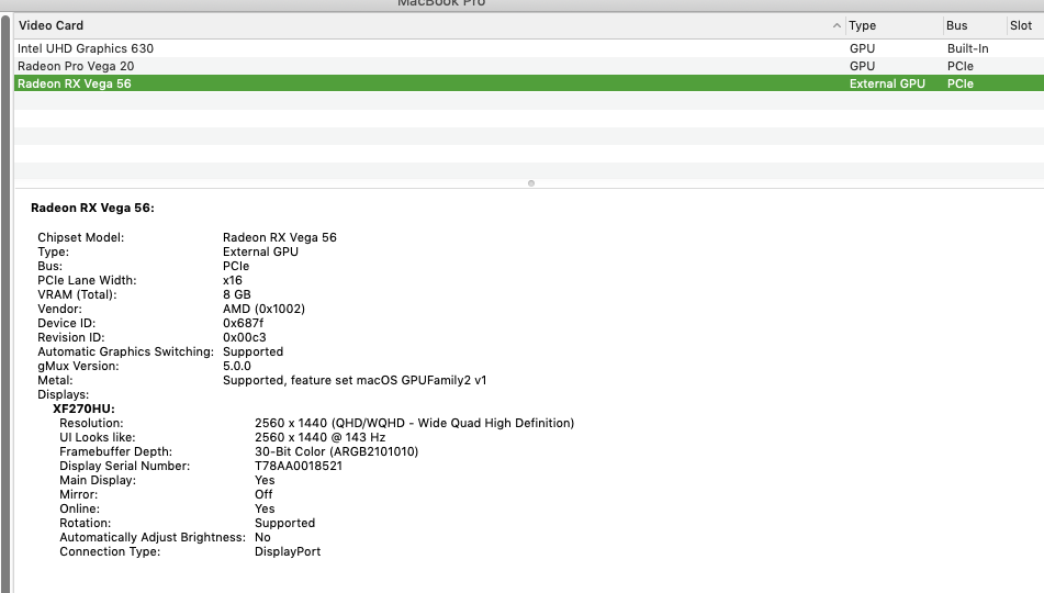

The Mac sees all the refresh rates of the monitor as being 0.12 Hertz less than what they should be. For example instead of 144 Hz it's 143.88 Hz, as you can see in the attached screenshot. This seems a little odd to me, makes me think the Mac is seeing the monitor as a TV, but in the Displays section of System Information there's no mention of it being a "Television". (That screenshot also attached.)
