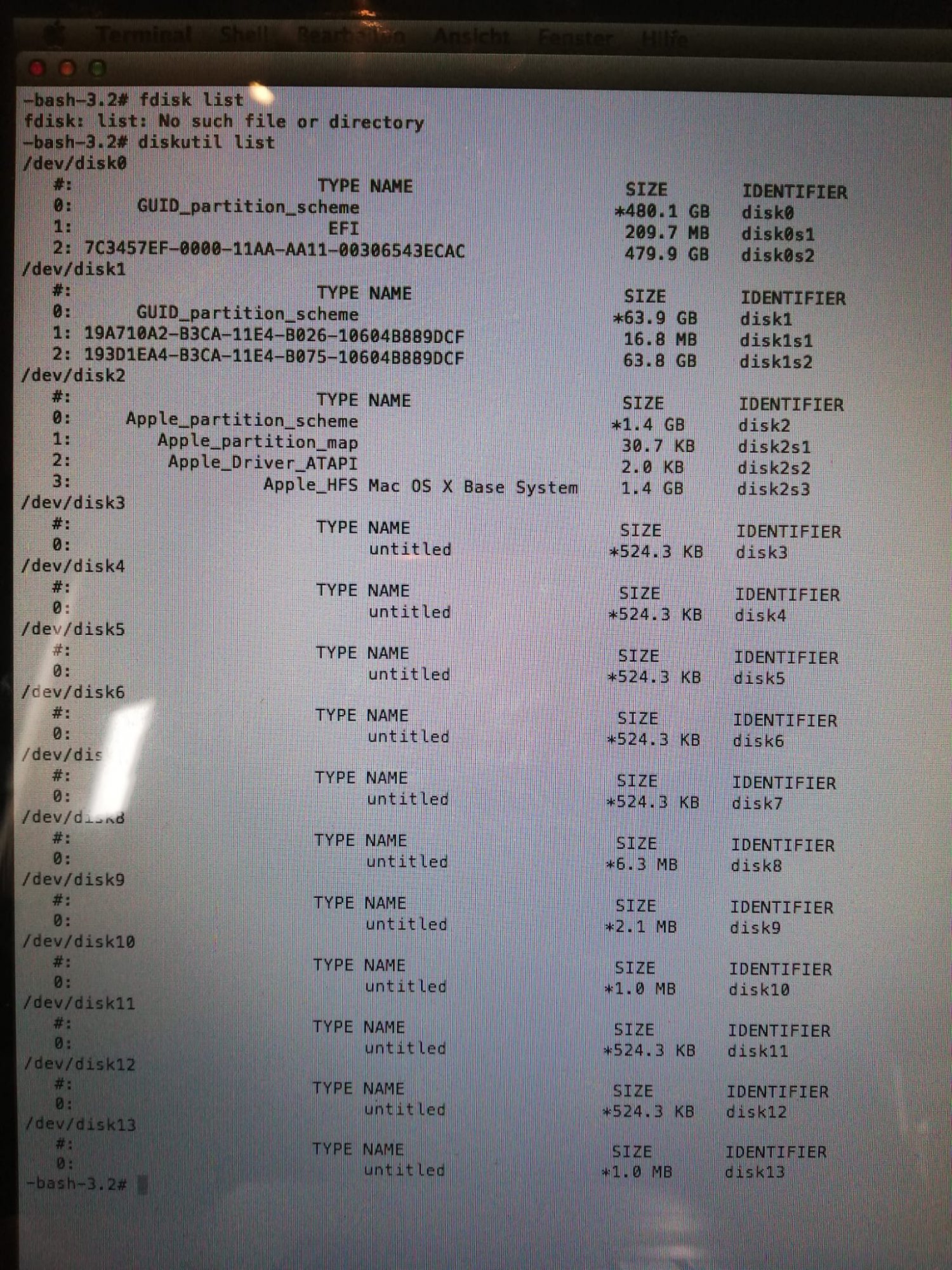

Hey folks,
A while ago I installed an SSD into my friends Macbook Pro 13" and installed Mac OS for him.
Now suddenly, while he was watching Netflix, the system froze and couldnt bootup again. (Folder with question mark).
I tried mounting, verifying and repairing but Disk Utility did not show any errors. Partition map seems to be fine.
I also put the SSD into my own Macbook Pro 15" (2011) but the problem persists. At least this is giving me a sign that my friends Macbook is actually fine.
Upon entering Internet Recovery and using Terminal I found many small, weird looking disks.
Does anyone have a suspicion what might have happened and how to fix this?
Would appreciate any ideas.
Those small disks (disk2 to disk13) are part of Recovery. Type mount to see where they are mounted (if they are mounted). Ignore them.
7C3457EF-0000-11AA-AA11-00306543ECAC is the partition type for Apple_APFS. The Internet Recovery is too old to look at Apple APFS containers so you can can't examine them or fix them here.

19A710A2-B3CA-11E4-B026-10604B889DCF is for Android meta partition (small) and 193D1EA4-B3CA-11E4-B075-10604B889DCF is for Android expand (everything else). Where are these coming from? Your 15" only has room for one drive, so does that mean this is a connected Android phone or something?

"Apple APFS containers so you can examine them or fix them here."
What do you mean? Fix them where?
"19A710A2-B3CA-11E4-B026-10604B889DCF is for Android meta partition (small) and 193D1EA4-B3CA-11E4-B075-10604B889DCF is for Android expand (everything else). Where are these coming from? Your 15" only has room for one drive, so does that mean this is a connected Android phone or something?"
Sry about that, it was a SanDisk microSD Adapter with a card inserted on my 15". Not very professional of me :confused:

7C3457EF-0000-11AA-AA11-00306543ECAC is the partition type for Apple_APFS. The Internet Recovery is too old to look at Apple APFS containers so you can examine them or fix them here.
@joevt
The reason why disk utility cant recognize the file system is because its too old right?
Can I somehow update that or create a modern recovery partition that can recognize APFS to check the disk?
Sorry, I mean't "can't fix them here." You need to boot a newer version Recovery/macOS/Disk Utility to fix it.

Internet Recovery is the feature of your Mac system that will boot your Mac from Apple's remote servers.
It only requires an internet connection.
It does not require any local or internal drive to be attached, and does not transfer any files to a local drive, unless you choose to do so.
It boots to that remote system, providing a means to completely erase an internal drive (if that is necessary), including any recovery partitions, then install a system on that drive. Internet Recovery originally would provide the same system that shipped with that Mac, so could be quite old (Lion, Mountain Lion, etc.) although now Internet recovery might offer more recent versions. I tested that out about a month ago, using a 2012 iMac. Catalina was installed on that iMac. The installed Recovery system offered to reinstall that Catalina system (as expected). Booting to Internet Recovery offered to download and install Yosemite, although that iMac originally shipped with Mountain Lion.
Seems strange that an Internet provided recovery system would not be the latest that the system supports since it is coming from the internet and not the Recovery partition. I guess this goes back to the days when you had to pay for macOS upgrades? https://www.wired.com/2013/10/apple-ends-paid-oses/
I read the following articles to learn the difference between Recovery and Internet Recovery:
The Apple support article says some Macs will install the latest supported macOS and some will install the version of macOS that came with the Mac.
yeah, i think so, its the same with my 2011 macbook pro 15", i think my friends 13" is from 2011/2012 too.
