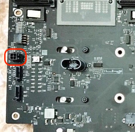

When I did have to modify some Mac Pro 5,1's to keep them alive a bit longer I managed to find a custom 4pin cable that draws power from the DVD drive power port which apparently delivers 150w. So that combined with the 2x 75w GPU power connectors gave me 300w to work with. Enough to drive a Vega 56 but not a Vega 64 as it turned out, but for my purposes a Vega 56 worked out just fine.

got a source for that 4pin cable?
This was a while back now when i was at a different company otherwise I'd dig out the source, I cant seem to find it at the moment. Long story short, you plug it into this port, which means you lose the CD drive, but gain 150w when thats split out into a single 8pin.
Worked a treat for Vega 56, but when I tried it on a Vega 64 I discovered it was drawing way more than the TDP it was advertised at (500w+)so the machine kept shutting itself off.
You can run a Vega56 off just the original 2x mini 6pin PCIe connectors. I did for years. As long as you go 2x mini 6 pin -> single 8 pin -> 2x 8pin to distribute the load properly. The total power draw isn't a concern, but the peak to a single connector can be. I did have the system cut out on me 2 or three times when gaming in windows, but never in MacOS.

I really doubt that the ODD Power socket delivers 150 Watt without burning. Its a 4 pin plug, so it has to deliver 3.3, 5 and 12 Volts plus GND of course. So 1 pin for 150 Watts is way too much.
