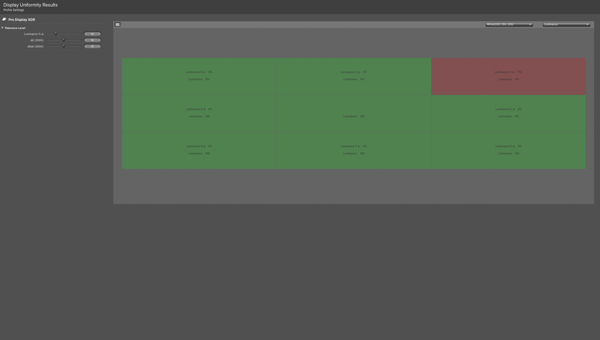

So, I took some measurements in two modes:
  • D65 Photography

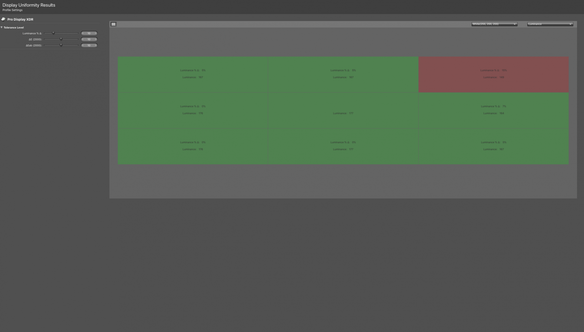

  • Apple Display (P3-500 nits): Max Brightness, Auto brightness off, True Tone on
I assume the colorimeter (i1 Display3) I used can't measure correctly on high brightness, as the second reading shows values similar to the dimmed D65 Photography – that can't be correct. But what the measurements confirmed consistently is that my Nano-XDR isn't uniform in the upper right corner 🤯😔. I noticed this also when looking at a solid grey screen.
I guess I'll have to contact Apple for a replacement 🙄
