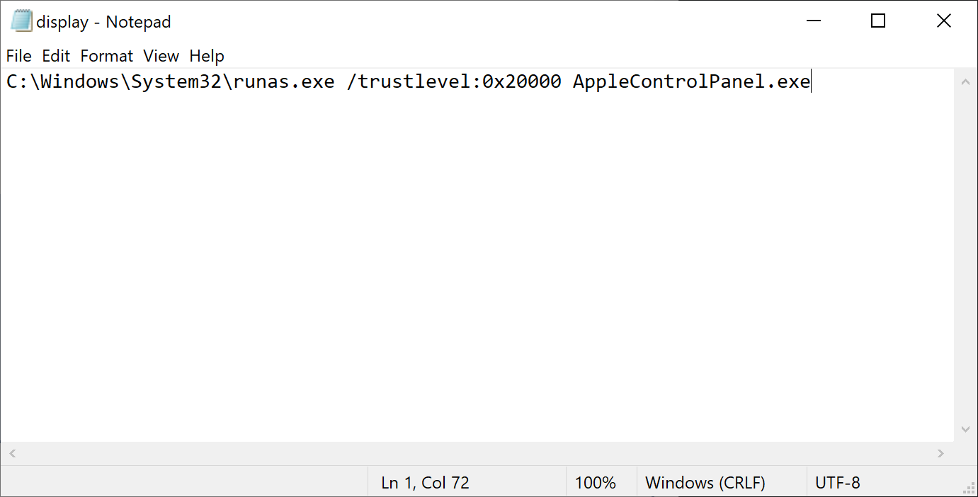

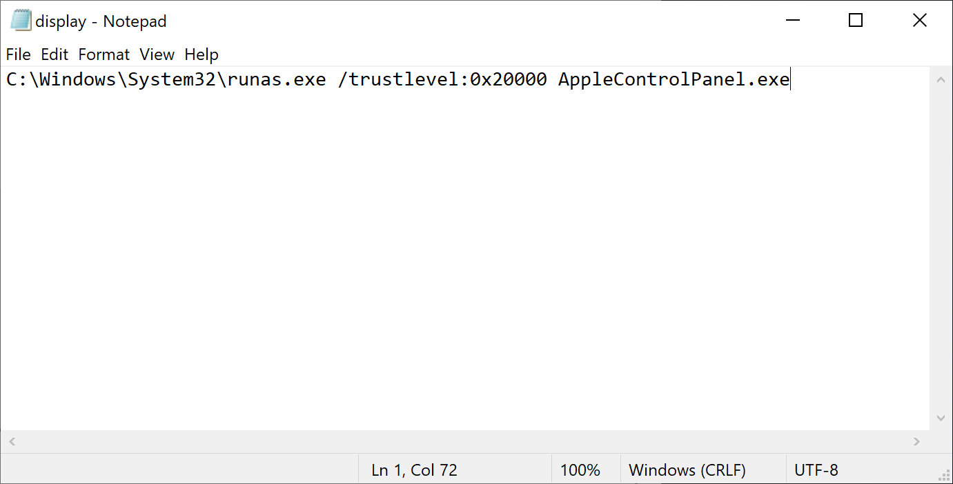

Ok, maybe this will help you:
- Create an empty text file
- Add the following line to it:
Bash:
C:\Windows\System32\runas.exe /trustlevel:0x20000 AppleControlPanel.exe
- Save it with name "display.bat" on Desktop

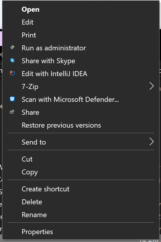

- Right click on it and "Run as Administrator"
It should open BootCamp Control Panel with display and keyboard controls.
Hope it would work for you.

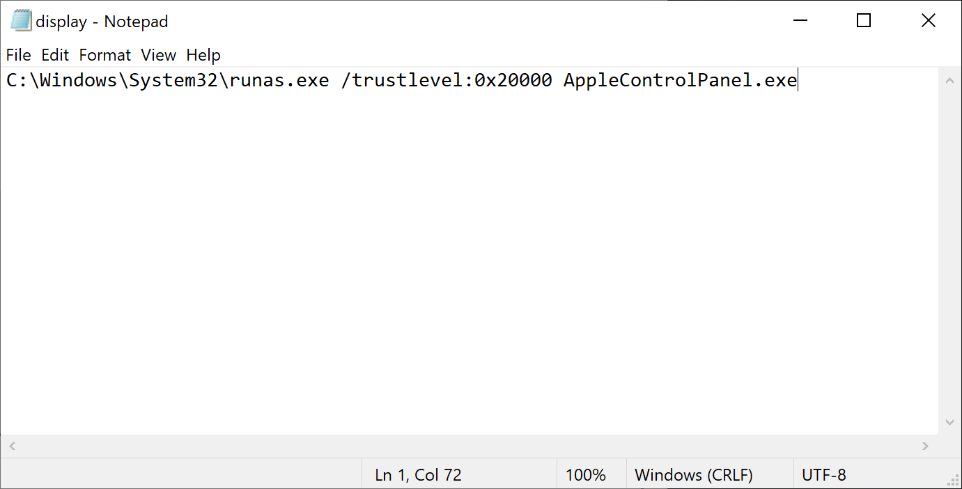

Bash:
Thanks for the instructions, but unfortunately it didn't help.(

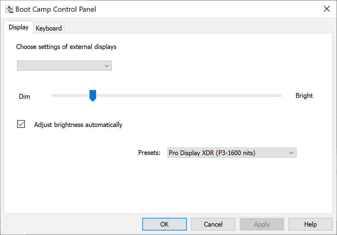

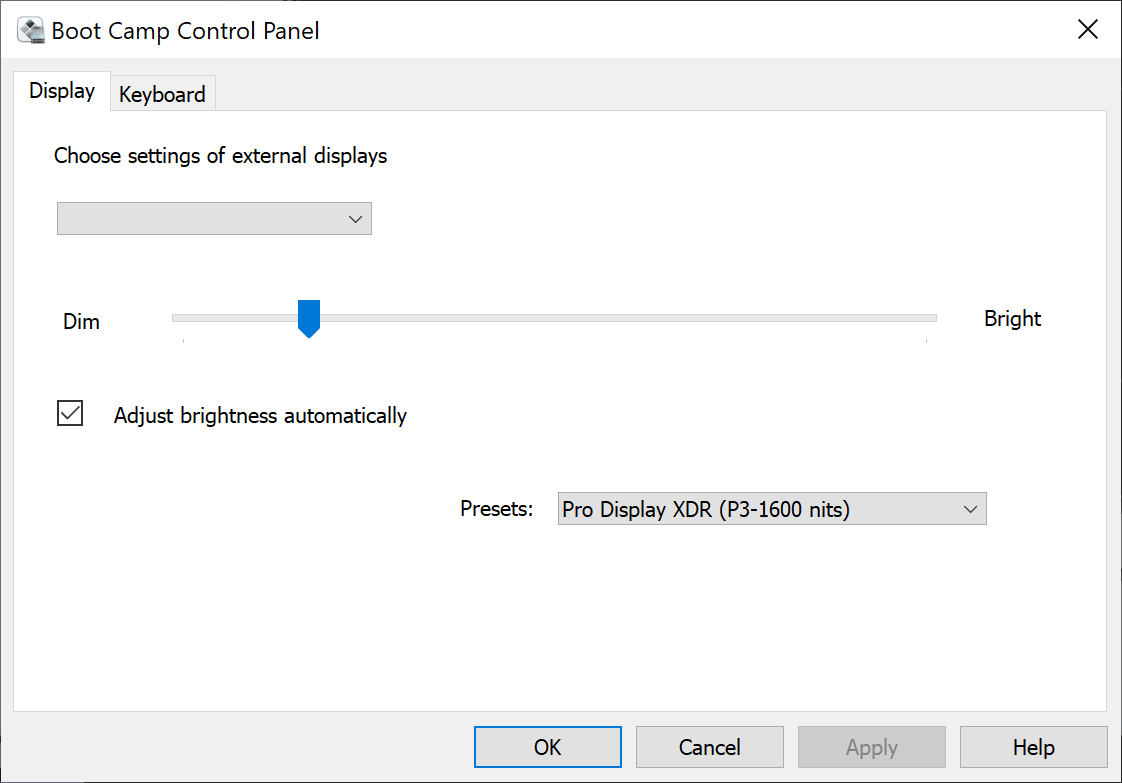

I found a way to enable BootCamp, but there are no monitor settings there, all it says is "No supported external monitors are connected"

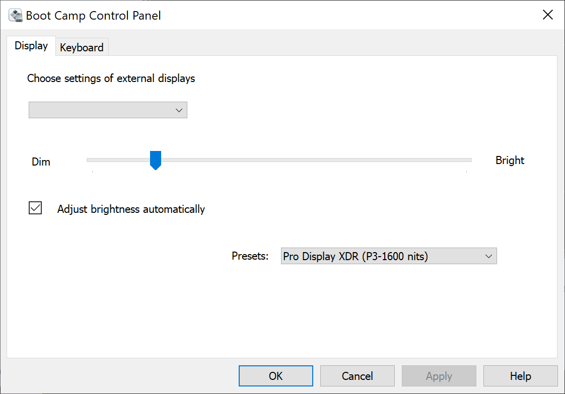

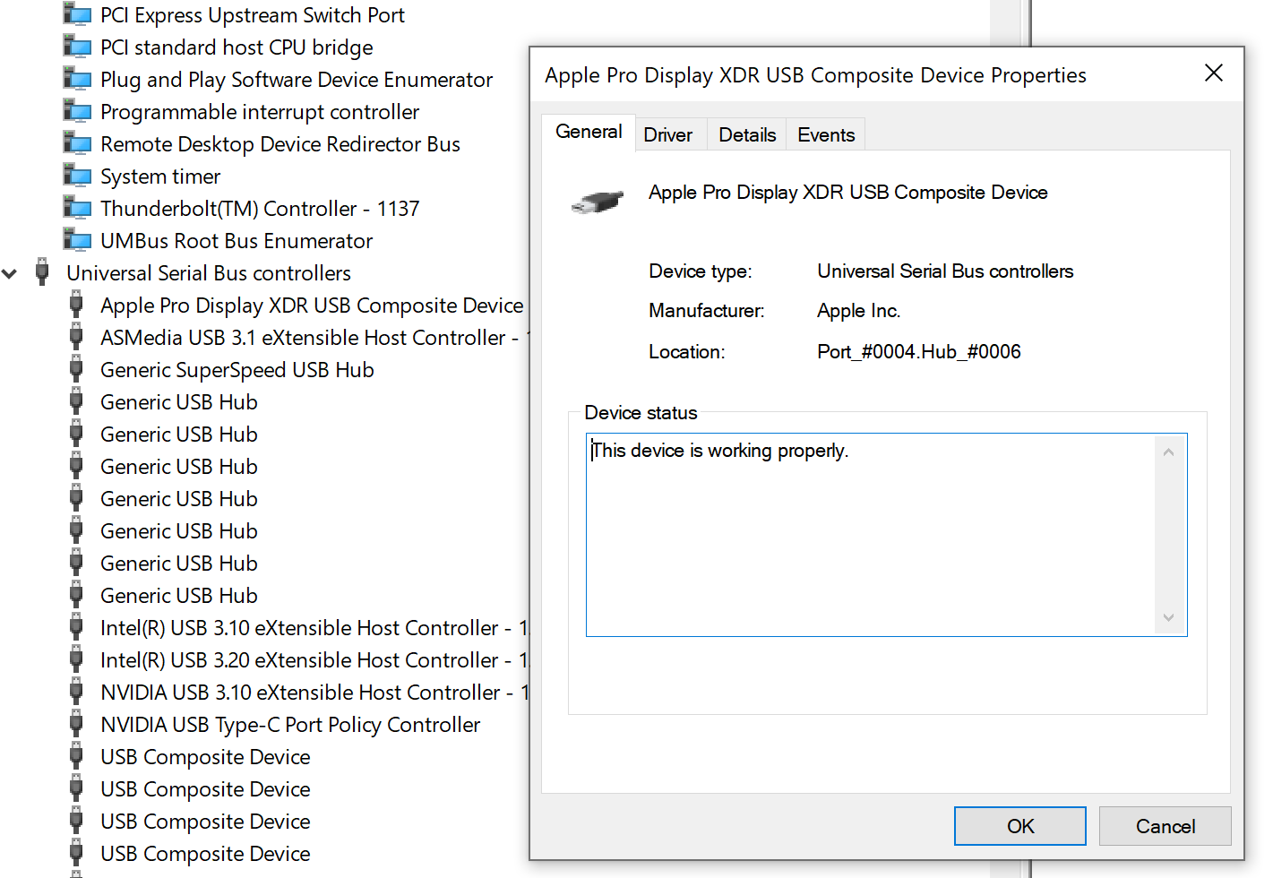

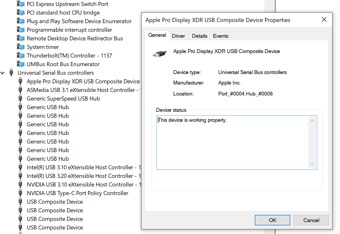

It seems your Belkin cable does not work properly. Check device manager, you should see there Apple Pro Display XDR USB Composite Device under USB Controllers:
If it's not present, then try to use other USB ports with Belkin cable.
If there's an unknown device, try to install drivers manually and use bootcamp distribution folder for searching.

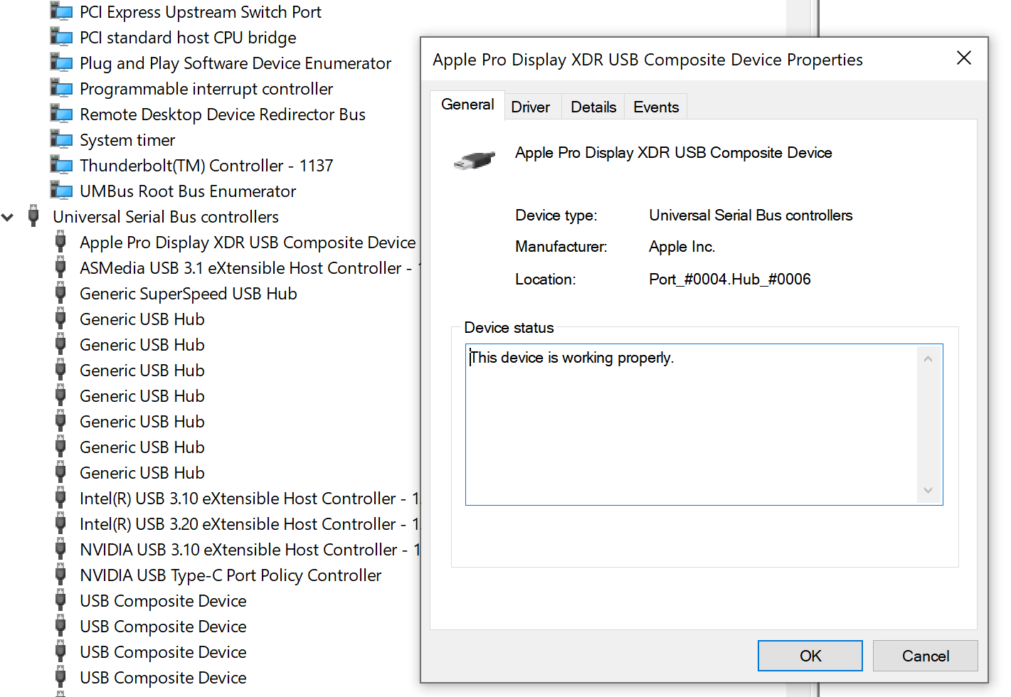

I don’t know what to do anymore.. Starting this device is impossible. (Code 10)
The USB device descriptor request failed.
