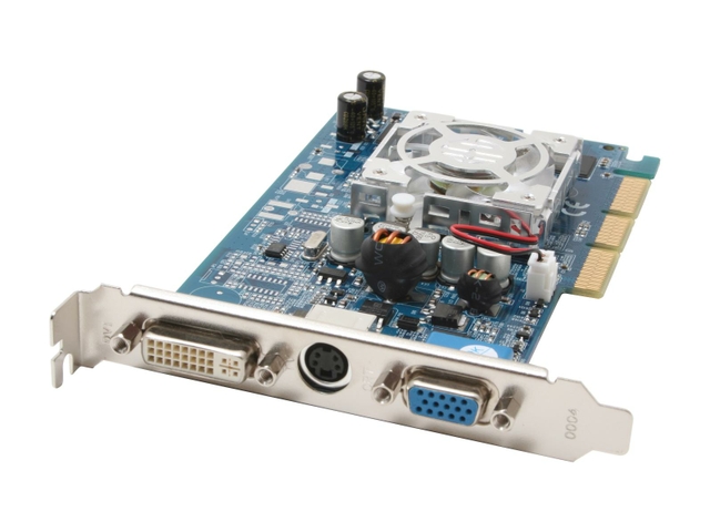

Hi everyone,
I have an upgraded G4 Cube with a (tower) Sonnet 1.2GHz 7455 CPU, a 200GB / 7200rpm Seagate HDD and 1.5GB RAM, and recently upgraded the graphics card to an XFX 6200 'WANG'. It has the black PCB and seems to be the recommended 6200 upgrade. I also tracked down and fitted the recommended Titan copper GPU cooler.
The Cube boots quickly into Tiger and Leopard, and plays old games like Quake 3 / UT99 like a champ. It is completely stable and I haven't seen any glitches. The problem is that if the Mac is put to sleep, it generally doesn't wake up. It was fine with the Rage 128. The fans spin up and the power sensor lights up, but the display is blank. It will always wake if woken immediately after being put to sleep, and occasionally it will wake up as asked after, say, an hour. But usually, it does not.
I used ROMs from the Mac Elite website, and have tried both the standard one and the 'no sensor' one (Tome's version; the regular 'no sensor' one wouldn't flash). I had already removed the HWTemp kext, but thought it worth trying a different version in case it solved this problem.
I've tried everything I can think of - removing USB devices, different RAM, DVI, VGA, VGA via DVI-I, CPU Nap mode, PMU reset, PRAM reset, various energy saver preferences and so on.

I have a BFG 6200 that wakes fine. I don't know what the rom is though.
Thanks for responding. Did you buy it already flashed? Is it a low profile model? DVI + VGA + S-video?
I flashed it long ago with a "strangedogs" rom. It's a BFGOC card with DVI + VGA + S-video. If you dig around over at cubeowner you might find some info.
That's great. Will the card will fit without moving the VRM? How is the fan noise? Though I can always change it for the Titan if necessary.
The card fits fine (same size as the original rage128) but the shorter cards are nice if you put heatsinks on the VRM. With your upgraded CPU and GPU you might consider doing this. Run some CPU/GPU intensive programs with the cube out of the case and feel how hot the 3.3v and 5v sections of the VRM get.
About the sleep issues, you could get a SSD and a temperature controlled base fan, and just leave the cube on. The SSD won't make any noise and if the CPU isn't doing much the base fan would slow way down and be nearly silent.

For anyone else trying this (admittedly 10 years after the scene moved on), my results have been:
XFX 6200 WANG (black PCB): works perfectly in Tiger and Leopard, but won't wake from sleep.
Xpertvision 5500 256MB: seems to be perfect in Tiger, but hangs computer when exiting a 3D game in Leopard.
