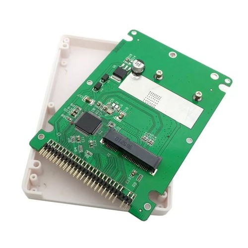

The Msata to ide adapter I had originally tried was this type
Mini PCI-e msata SSD to IDE 2.5 inch 5V 44pin Adapter Card | eBay
1 x Msata to IDE Converter. MPN : Does Not Apply.
