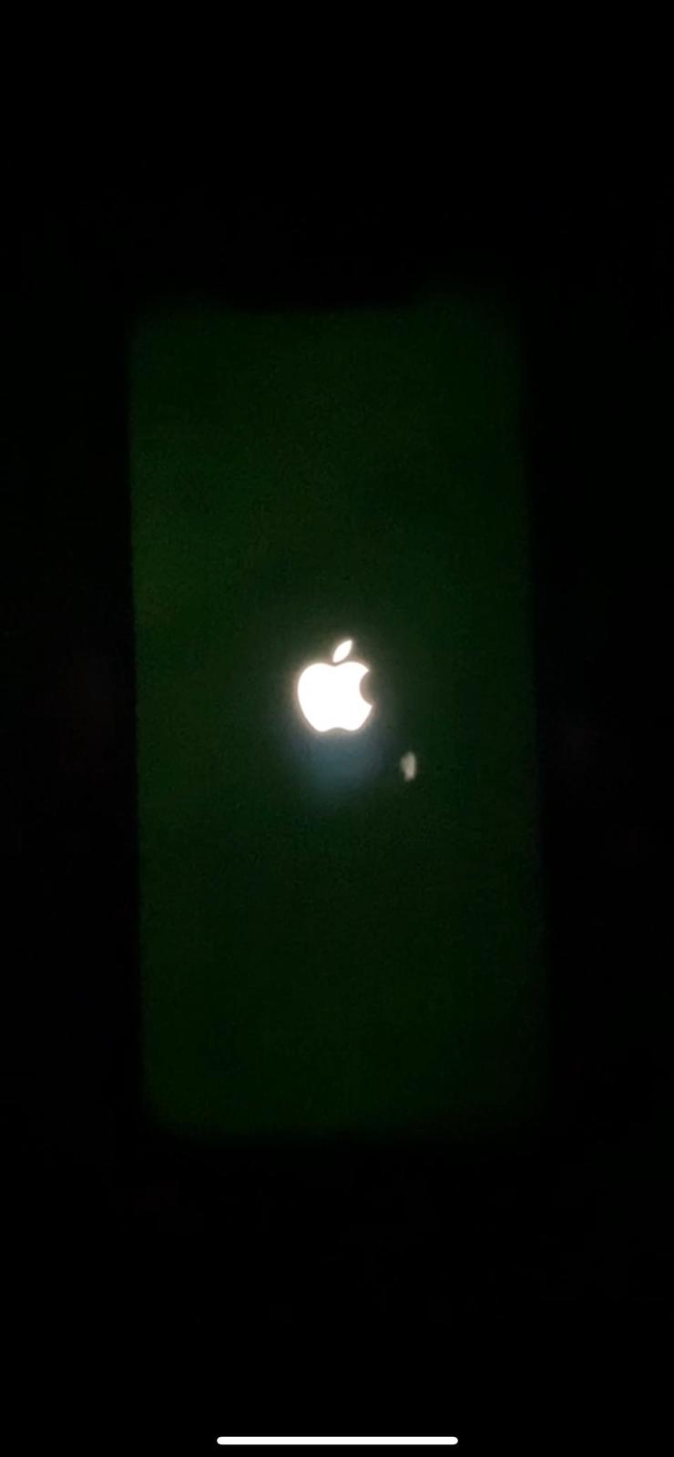

Got my replacement 12 today. Is it as white as my wife’s X? No, but it’s definitely an improvement. The screen has much less of a greener tint. I’m guessing if I had a display calibrator it would show a higher red RGB value. I think I’ll keep this one as it looks pretty good and I don’t really wanna go through the lottery again.
Some stats: Serial is DNQ, week 43. Screen serial is GH303...

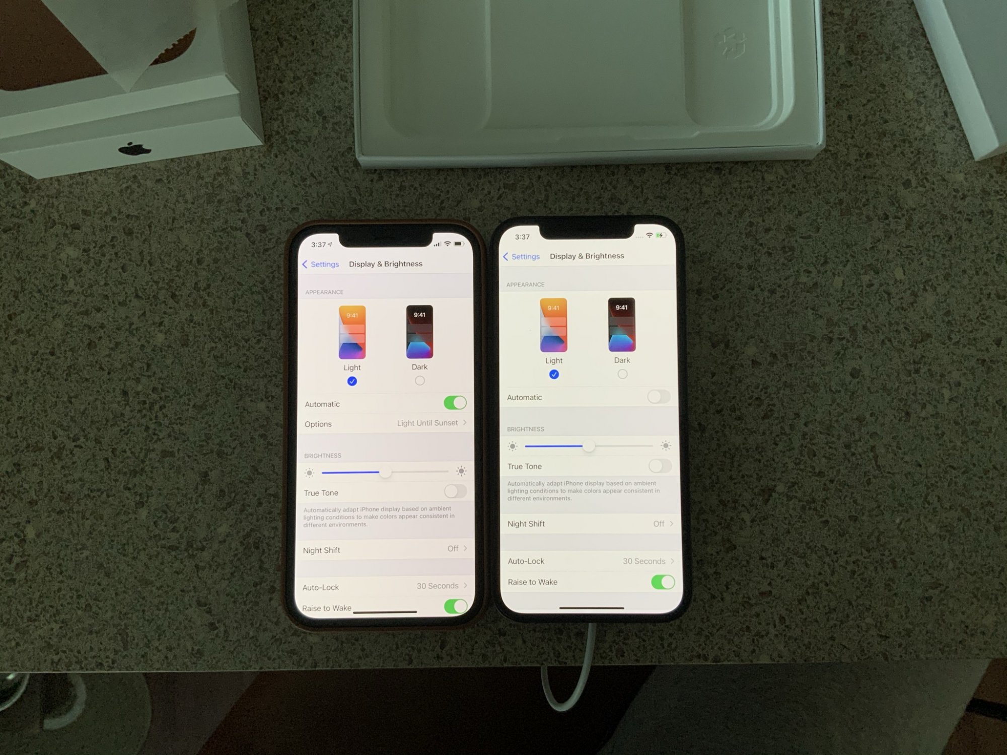

Left is new iPhone, right is old. Both set to 50% brightness by siri.

Please, help me decide to keep it or not! :confused: I took some pictures to compare both screens, iPhone 12 PM (bigger) and iPhone X. To my eyes I can see the iPhone 12 Pro Max looks warmer than my iPhone X. But to my DSLR there is no so much difference. Bothe phone with TT off, auto-brightness off, screen brightness at 50%.

Got my new 12 Pro in yesterday, ran a DisplayCal with the same settings as I did before. New serial starting in DNPDR.
I'm decently satisfied with this replacement. Side by side with my XS there's still some green tint, but also my XS apparently is red tinted. The original 12 Pro was egregious enough that I noticed it and searched for the problem, but when I woke up and looked at my phone it didn't immediately feel wrong. Will see if it gets better in a few months-hopefully those blues and greens soften a bit.

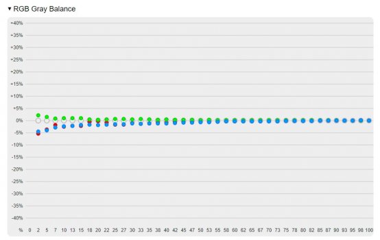

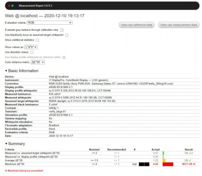

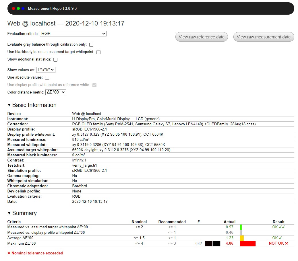

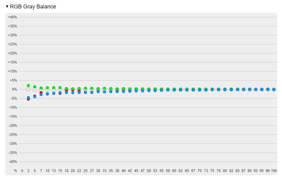

Congrats on finally getting a good screen! I provided CALMAN measurements of my 12PM earlier in this thread, but thought I'd run a new one in DisplayCAL to match yours. I also see the similar elevated levels of green in the gray balance. :(
Same here. I don’t have equipment, but there is a slight blue/green hue in greys. It seemed yellower than the xs Max I turned in. But I got used to it.
Now, the flickering in dark environment with blacks sucks but I’m hoping for a recall or software upgrade. Other than that, I’ve been happy with the battery and colors.

The accessibility color tint/hue(which is what most people have been using to adjust, not the RGB filters) has no effect on the camera shots. Don’t believe me, try it. Throw some wacky color filters/tints on your screen, take the same shot with and without them and look at them under the same viewing conditions. You will see the shots are the same.
Bottom line is, in our cases, our brightness is the same as my 11 was along with blacks are fine, it’s just a warmer look, like turning on warm1 on your tv vs neutral. Ours were able to be adjusted back to what our 11s looked like(we compared them side by side).
Now there are some that I have seen here and other places that are just bad and have more than a simple tint issue. The ones with the green in their blacks and lack of brightness should definitely be replaced.
