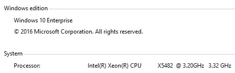

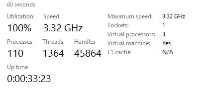

And oddly enough the Win10 VM sees the higher clock rate, but my Linux VM doesn't.
I've only shared 3 cores with Win 10 (mcafee on-access scanner is pegging CPU):
