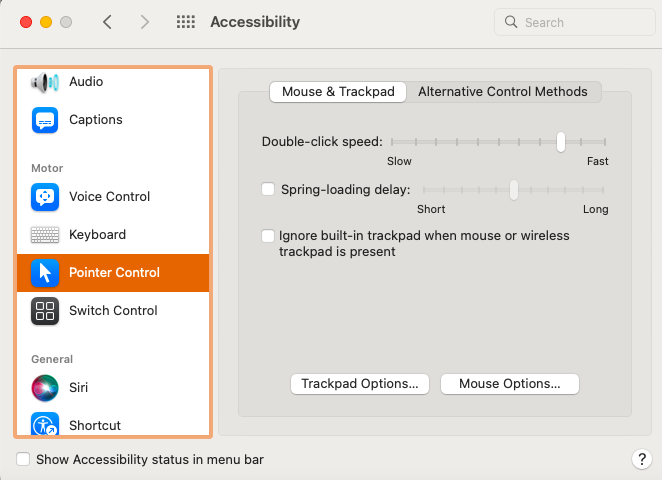

After experiencing the same issue on my MBA 2017 running Monterey, and watching many videos everything seemed to point to the Accessibility options and Mouse & Trackpad.
Since playing around with the settings in here and unchecking 'Spring-loading delay' - numbers 1-9 are working all the time! try and see if it works?
