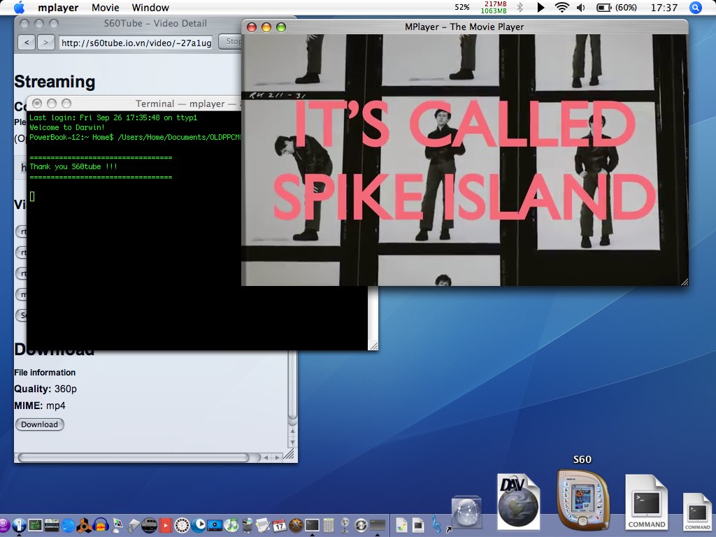

I don't use my Powerbook for Youtube anymore but when I came across S60Tube some months ago I used it as the home page in OneWindowBrowser combined with a script to launch the video in MPlayer:

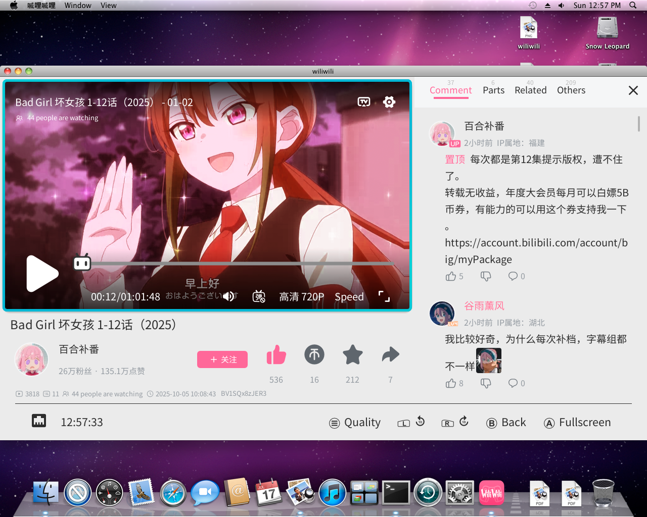

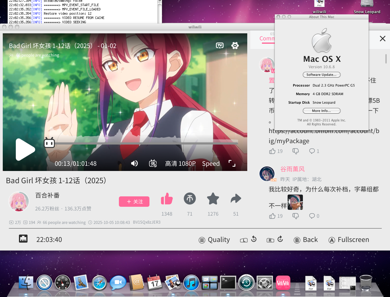

After two days spent on this, I fixed the build of wiliwili, a client for BiliBili (youtube-like) service.
Amount of English lang content is not comparable, but there is no difficulty with music videos.
mpv endianness bug again shows up, so colors with SDL2 cocoa are wrong. I will try fixing that.
Upd. Colors are wrong with SDL2 X11 too, and the issue is likely on mpv side or their interoperation with wiliwili code.

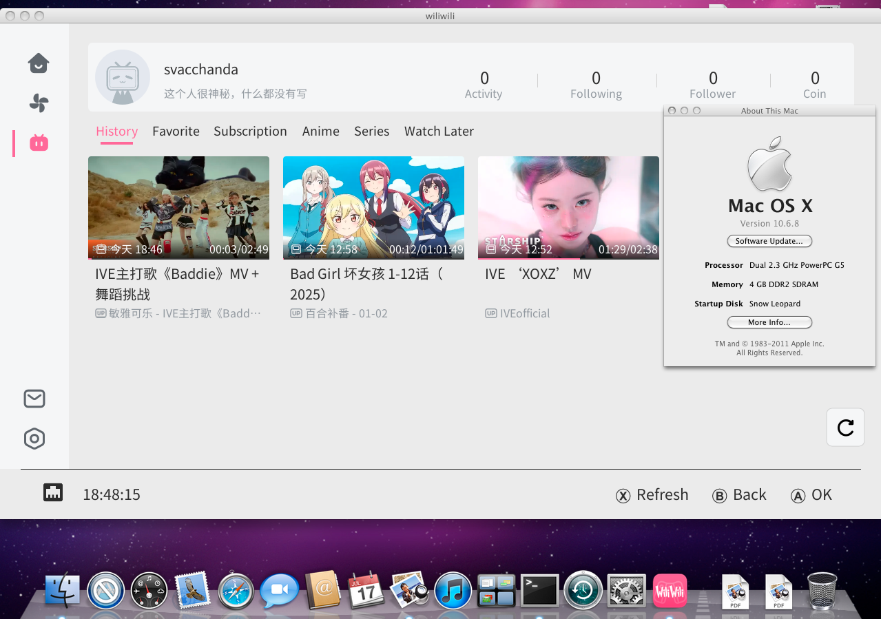

Yes the endianess is messed up is something I found before too, In PPCMC7 the ffplay command forces a correct format to work around it. Definitely needs to be corrected in the SDL code tho.
I am not really sure who is at fault, since on its own SDL2 has correct colors, AFAICT, and mpv usually has correct colors (I added a hack to its x11 codepath to fix it, but sdl2 codepath did not have the issue). However there is also GL at play, and wiliwili requires GL in SDL2, but allows mpv to soft-render. We have to use the latter, since GL in mpv is semi-defunct and does not work in wiliwili. It’s a bit of a mess LOL
Colors issue aside (will be fixed eventually), I wish we had this app for YouTube. It even supports logging in via QR code via mobile app (i.e. I can log in on a PowerPC app using iPhone).
Reactions: alex_free
I fixed the color bug:

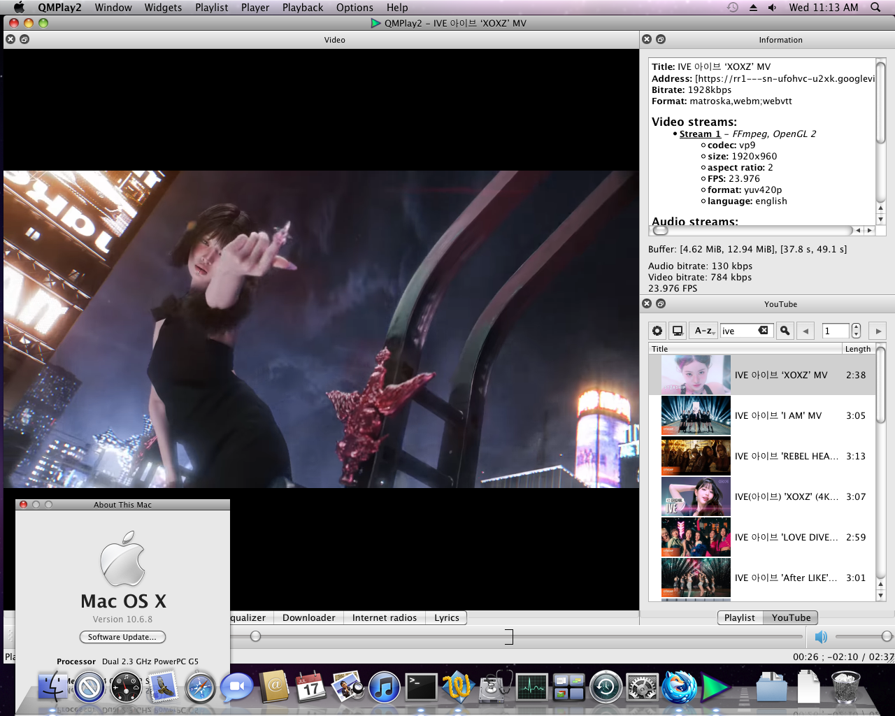

Huh, PPCMC 7.2.7 is over a year old and I still can download 720p videos and play them on my tiger intel book.
Looks like there may be a future yet for YouTube on legacy OS X. I future proofed it into 2026!
The v7.2.8 update is currently in development hell, but it’s good to know v7.2.7 was this future proof. Stream on, Tiger users. Safari URL integration is completely dead now with google search dropping old browsers, but tenfourfox can get you the url you need. All streaming except with FFplay (which doesn’t work via Rosetta on intel yet, so I use VLC personally for my HD tiger video playback laptop needs that I download first) is most likely dead as well.
I’ll just mic drop with this, what INTERNET CONNECTED (especially youtube/google) app do you use that works no problem 1 year later?? I think that says a lot that I made an effort for the last version to remain relevant for as long as possible. I knew this one was gonna be tricky, but this is still going strong.

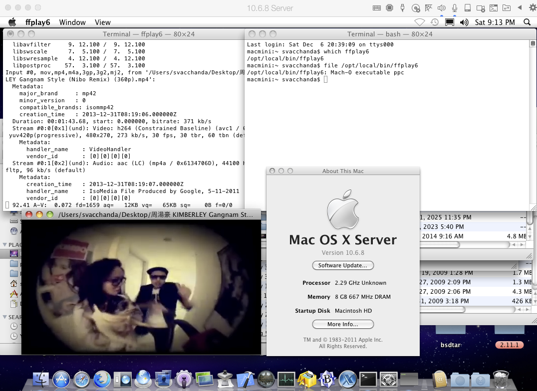

What’s up with FFplay?
QuickJS builds on Tiger now, so you can use that for JS runtime with YT dlp.
It’s just PowerPC builds of ffplay running via Rosetta. There was no native intel build of PPCMC 7.2.7, so when I use ffplay on my mid 2007 2.16ghz MacBook running tiger it crashes. Rosetta is magic until it comes to SDL2.0.3 compiled for PPC. 7.2.6 had a native intel build , but is 5 years old at this point…
Same story from back in the late 2000s, if you use vlc for ppc on intel you get a crash too (and haha that was SDL1 for sure). I really just need to make an intel build, which would have the optimizations necessary for HD as well anyways…
Reactions: MacFoxG4
I recall at least via X11 it worked in Rosetta (i.e. ffplay via sdl2 via x11), won’t be surprised if Cocoa does not, gonna verify out of curiosity.
vlc is garbage code
At least the default build of VLC expects hardware acceleration, which won’t work via Rosetta, I guess? My usual Rosetta set-up is in a VM, and that way even native VLC build won’t work LOL
In fact works normally for me. All ports are built on ppc natively from PPCPorts and installed on 10.6.8 Rosetta via PPCPorts.
