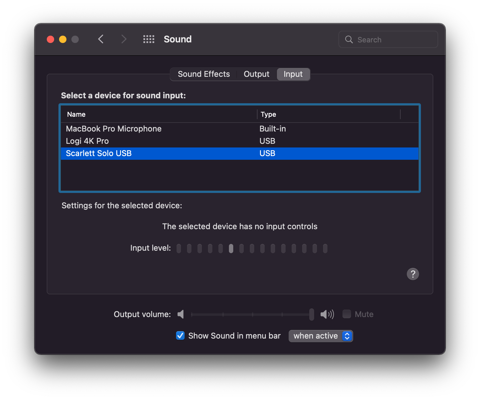

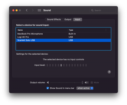

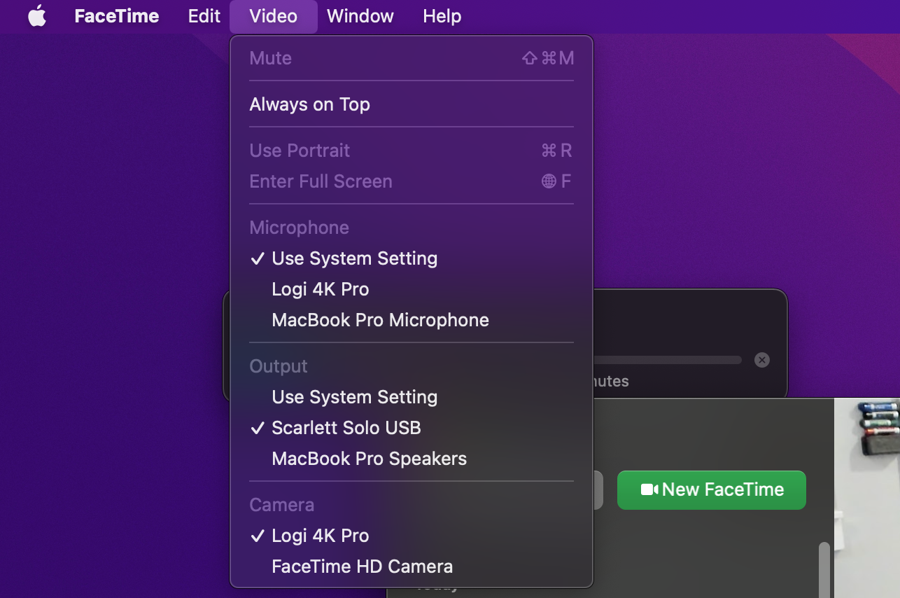

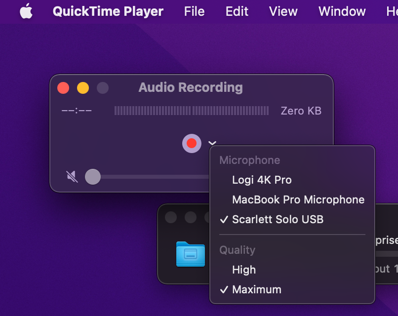

I'm experiencing an issue with my 16" M1 Max MacBook Pro on macOS 12.1. FaceTime doesn't seem to recognize audio interface microphones.
I have a PreSonus and Scarlett Solo, neither show up as an input option in FaceTime. However, other apps in macOS work just fine. System preferences, QuickTime, google meet, etc, all work just fine. Anyone else experience this? Searching around I feel like I'm an outlier.
Tried all the usual things. Rebooted, tried various mics, interfaces etc. Trashed preference files, reinstalled macOS. Nothing.
Interface shows and works fine - sound input in system preferences:

Shows up and records/works fine in QuickTime
Not listed in FaceTime.
