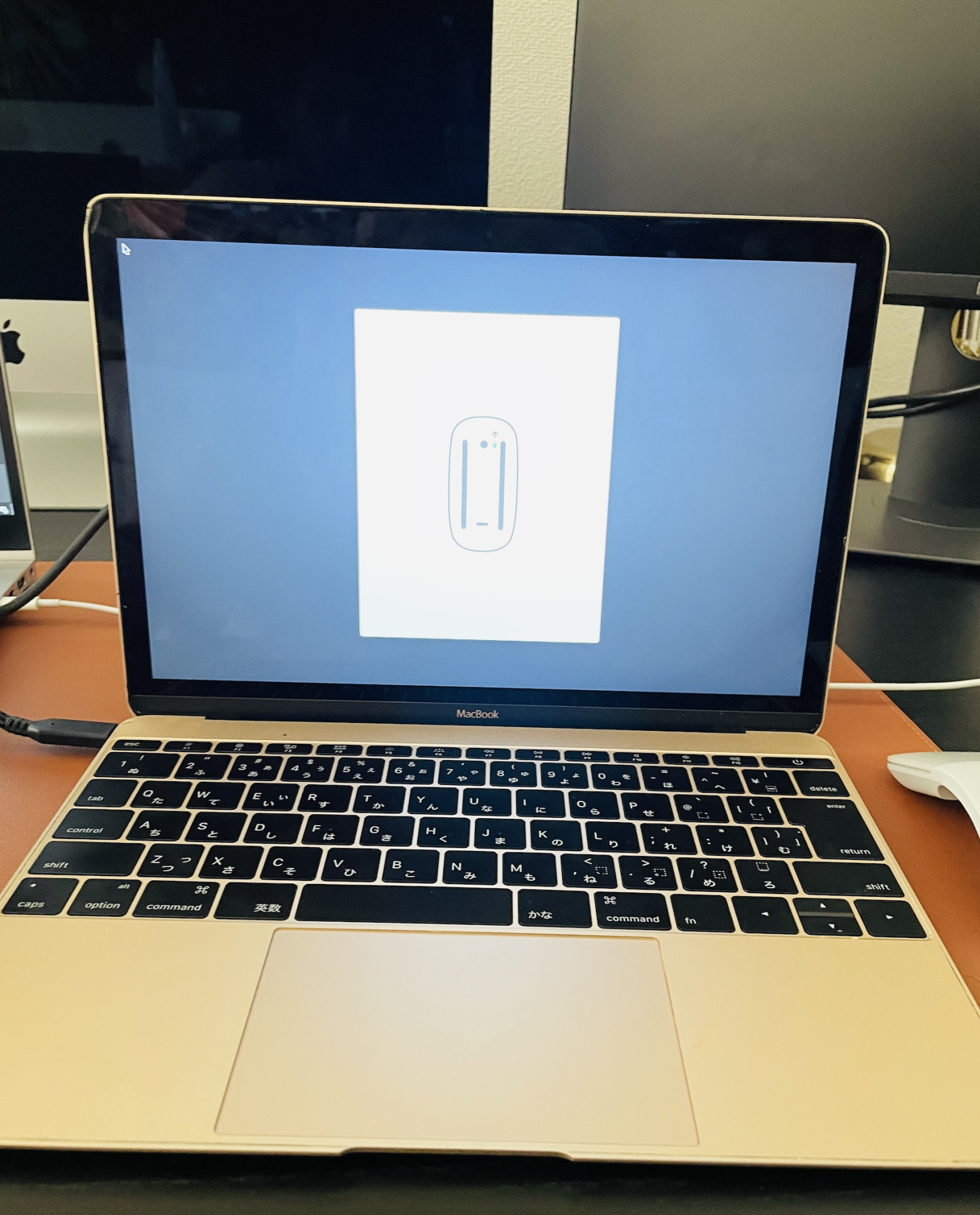

Hi, My 12 inch 2015 Macbook A1534 resurrected after 3 years.
In 2019, I took it to Apple Store and they said Logic board replacement is needed due to water damage. Since it was too expensive, I didn' go for it.
Yesterday I just plugged it in and It was working all of a sudden. It could not detect internal trackpad and keyboard so asked for external. I plugged in my iMac keyboard using USB-C cable and I could login to my account. It even restored all the apps and Safari pages I was working on probably.
I update icloud password and started Mac OS update from MAC OS Mojave10.14.6 to Mac OS Catalina as prompted.
However it restarted during an update and then crashed again.
I'm thinking it might be due to NVRAM reset. Is there anyway to do it other than Option+Cmd+P+R?
Since then I have tried countless times to do SMC reset, NVRAM reset and all startup things with various permutation and combinations.
Battery is charging normally. I can charge my iphone 2 times atleast. trackpad is working normally.
Not sure what is wrong.
Maybe need to wait another 3 years ;)
maybe NOW you can take it to AppleStore
