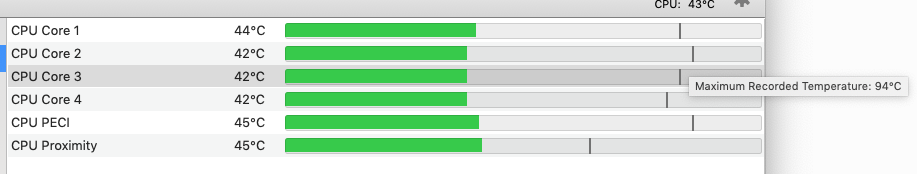

I also found a way to reduce the fan speed, but then it no longer adjusts depending on the temperature, which is too dangerous to me. Have you found a better way?
With Macs Fan Control, after having reduced the minimum fan speed to 1000 rpm, you can use a personalized setting based on CPU Proximity temp where it will automatically increase fan speed when it reaches that temp. So you can create an almost normal behavior where it will fluctuate between 1000 to 2700 rpm instead of 1200 to 2700 rpm (system settings)
I am just trying to figure out what temp would be appropriate for fans to kick in. Maybe 55C or 60C ?
Wouldn't hottest core make more sense? I was just doing some video work and CPU proximity had a max temp of 70c in my usage. CPU Core 2 have had a max temp of 94c.

What is the minimum RPM the app allows? Apple is using their minimum start RPM as there minimum speed (for safety and longevity). I wouldn't go much below 1000 RPM if the app allows it. It might be perfectly fine but I doubt Apple would have invested much into the motor for lower RPM operation with no plan to ever leverage it.
This is why the MacBook fans shut off and don't modulate down below 1250 RPM (2018 13" model) btw. If it was as easy as just reducing the fan below the motors minimum speed they would just do that.
You could test the temps yourself based on the default SMC fan profile using these commands in terminal (4 instances = 4 core)....
yes > /dev/null & yes > /dev/null & yes > /dev/null & yes > /dev/null &
then type.....
killall yes
Using the up arrow to recall you can cycle between those commands quick enough to work the temp up and have it maintain whatever temp you want. You can even go into activity monitor and kill one of the "yes" processes to keep it running on other cores. Even around 75c my fan is sitting at 1200 RPM.
