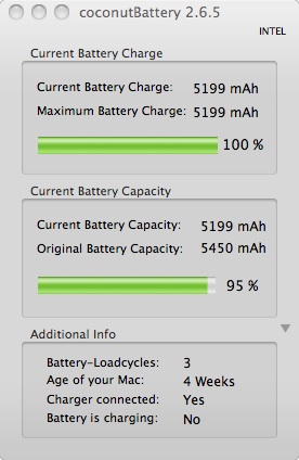

I am very worried about my battery.

swait, so you haven't even let the battery run down? You're just going off the estimated battery life? :confused:
Or did I miss something?
Edit: Nvm, I should have read the whole thread.
5% OMG! Seriously, batteries fluctuate all the time depending on temperature, use and calibration and the fact that not all batteries are created equal.
I happily get 6 hours under fairly heavy work and that's good enough for me.

Every day my battery has lower capacity. When I started complaining my 13" macbook pro battery, full charge capacity was about 5349 mAh vs original of 5450.
Now its reached a new low of 4722, only 88% of original capacity with a cycle count of only 46. It sure doesn't look like its going to make it to 1000 cycles before reaching 80%.
