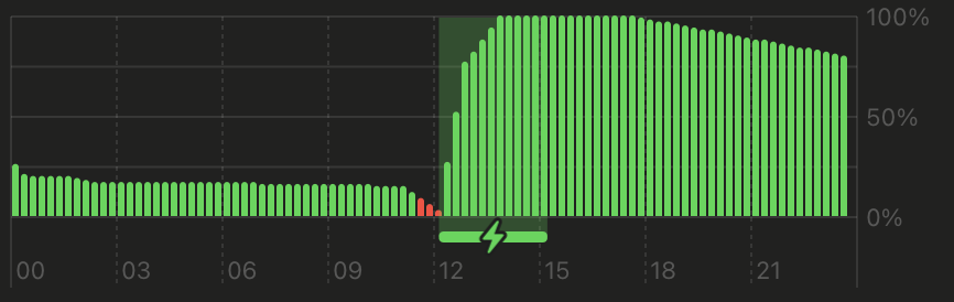

Battery history below:
I can see that process mDNSResponder is preventing sleep sometimes.
What is it? Can I disable it? It looks like that it does DHCP lease renewal every time.

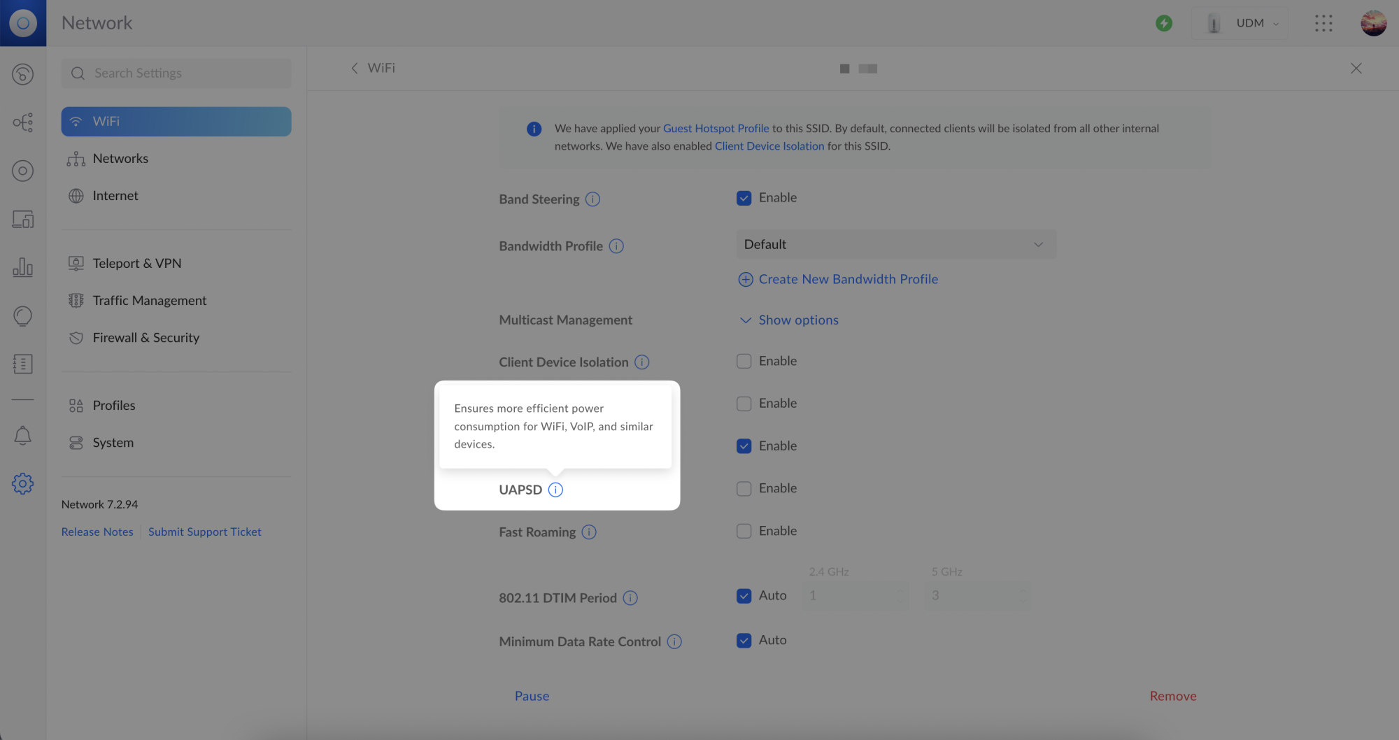

Looks pretty normal to me, does your router have setting for UAPSD? It may help.

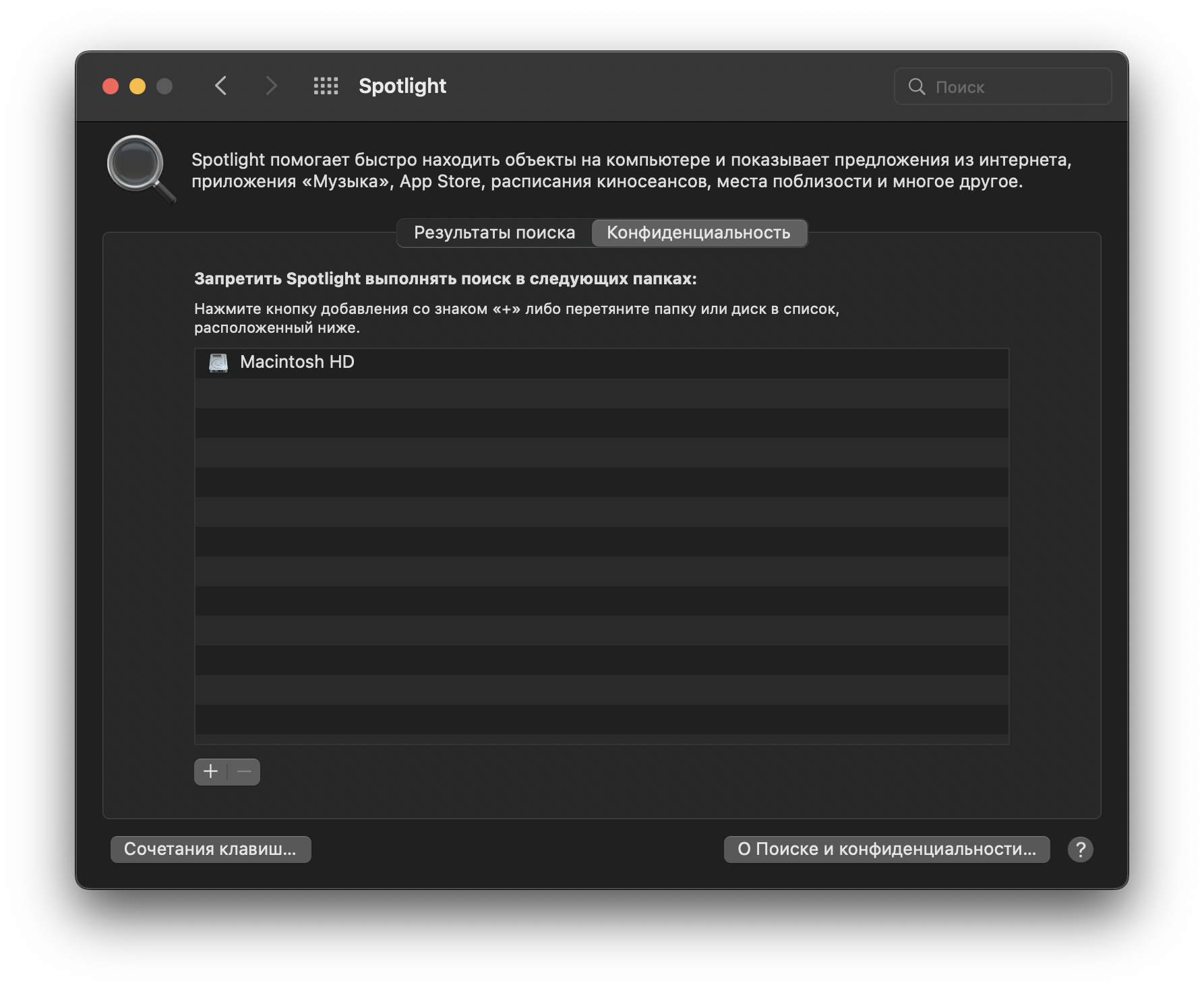

Hey guys. Thank you for your posts in this thread. I've been periodically watched it for months.
I had the same problem that cause my macbook discharge. Now I have 100% battery with more than 24 hours since last charge. Let me tell you what I've done yesterday
1) First one is disable Spotlight indexing:
> sudo mdutil -a -i off
FYI: mdutil – Utility to manage Spotlight indexes.​
Interesting options:​
-i (on|off) Turn indexing on or off.​
-a Apply command to all stores on all volumes.​
If you need to enable Spotlight write:​
> sudo mdutil -a -i on
2) Second one I opened Preferences > Spotlight > Privacy
and I added the Macintosh HD to that list.
Also I have unchecked some search options in first tab, but it didn't bring any result for "battery drain" in the past. (But keep it in mind)
I hope the problem will not get back tomorrow.

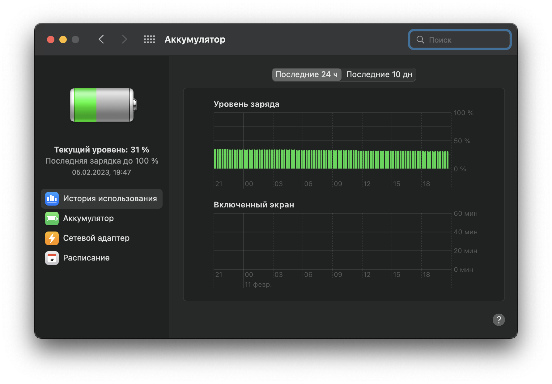

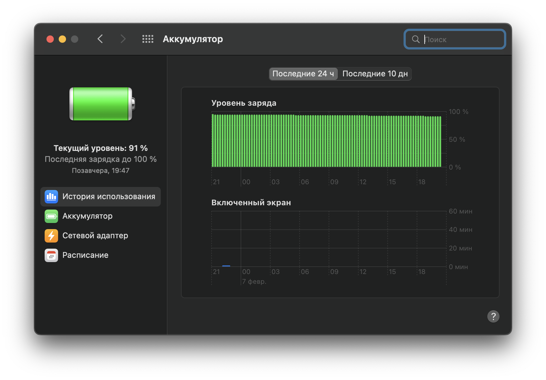

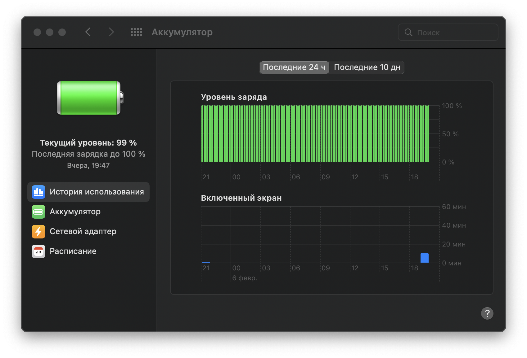

andrew57385610
macrumors newbie
Feb 6, 2023
6
Day 2. Yesterday I closed MacBook at 94% and have opened at 91% today.
PS: I didn't turn Wi-Fi off yesterday, today there are a lot of wake requests with it (that may cause a 3% decrease)
But at (Day 1) I didn't turn Wi-Fi off too.
andrew57385610
macrumors newbie
Feb 6, 2023
6
I don't want to rain on your parade but I just tried and in 2 hours I lost 10% 😭
Hope it will continue working for you, even this is not he silver bullet.
I am getting really tired about this thing....
My actions were something like this:
1) sudo mdutil -a -i off
2) add Macintosh HD to list
3) kill spotlight processes
4) reboot
5) sudo mdutil -a -i off
5) kill spotlight processes
andrew57385610
macrumors newbie
Feb 6, 2023
6

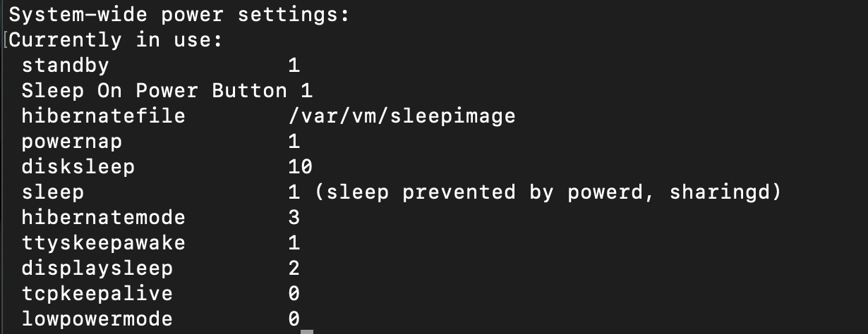

Also I have
1) disabled Screen Time
2) disabled checks in Preferences > Sharing
3) static wallpaper
5) power settings
Prints your settings:​
> pmset -g​
where tcpkeepalive is disabled when battery in use (b stands for battery)​
> sudo pmset -b tcpkeepalive 0​
6) "avatarsd"
> launchctl list | grep avatarsd
4604 0 com.apple.avatarsd
(it's status = ZERO)
I may have different status for this service than you because when I had seen a lot of avatarsd in "Wake Requests" list I run next command:
> launchctl bootout gui/501/com.apple.avatarsd
7) I had disabled Handoff for some time but last month it is enabled
8) Turn the Light appearance, Dark Appearance, Automatic Appearance and Dark again. (because it may be a bug in automatic changes)
https://www.reddit.com/r/macbookpro/comments/qj3l9m/_/iatn06n
I use always dark appearance.

Okay... Looks like the problem is still here 😓
Check the apps you've installed.
3rd party mouse drivers or webcam drivers? What other hardware is or has been connected to your machine?
DisplayLink adapters?
Adobe Creative Cloud cloud sync?
However, I don't think 1-2% per day in sleep is abnormal. The machine will wake periodically to download iCloud updates, iCloud email, etc. How much iCloud email do you receive daily? Is Time Machine on and pointed to a network drive?

hmmm.... There's several possibilities I can think of that might cause this.
1. As the battery wears out, predicting remaining time becomes even more inaccurate. I've had older MacBooks die when they reach < 20%.
2. System settings prevent sleep and or hibernation, I would say that this is unlikely but I wouldn't rule it out. Open Terminal and enter "pmset -g live", then press enter and post the results here.
3. A rogue process preventing the Mac from sleeping, you can check the activity monitor, and use the column "Prevents Sleep" to see if you have any of these.
4. I've experienced some Apple processes which can prevent sleep to the point the battery drains completely. "Adaptive Standby Wake", attempts to wake my Mac in preparation for me to use. Except, I found if it's awake under this process and the power is disconnected, the Mac stays awake until the battery is completely depleted, no hibernation, nothing, dead, pushing up the daises. Apple say's there's no way to turn off this feature, but I'm not convinced.
For the last 16 months I've been working a Mac app to help diagnose Mac sleeping problems, if you would like to take a look, google "Mac Sleep Aid".
