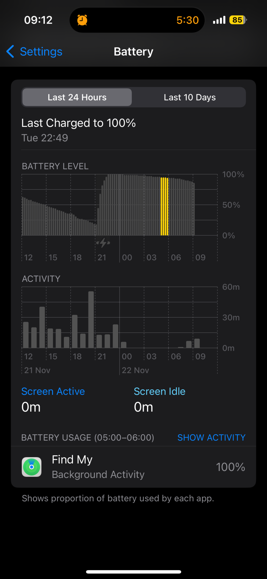

Around 10% per night goes to Find My.
I have an automation that turns off AID/ turns on battery saving during the night. Yet I’m losing 10+% on Find My.
Initially I thought it’s because of my AirPods staying out of the case. But it’s not, I haven’t used the AirPods last night and still lost battery.
Any solution in this?

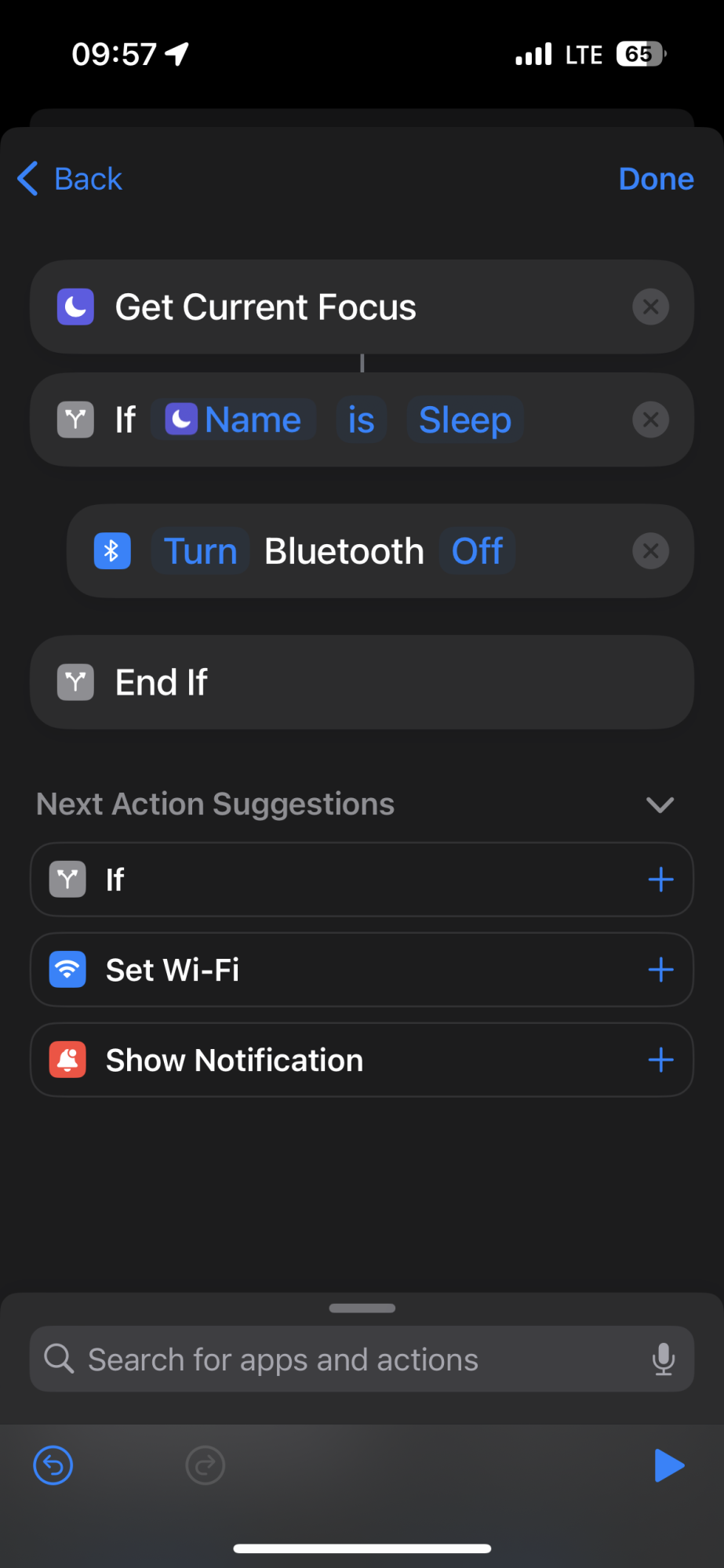

I found in other places that it's an old issue due to bluetooth, might try an automation that turns off bluetooth during the night
Reactions: Corgirat
So it seems that with Bluetooth off between 2 and 7, I lost only 3% 🤡
Seems we found the culprit.

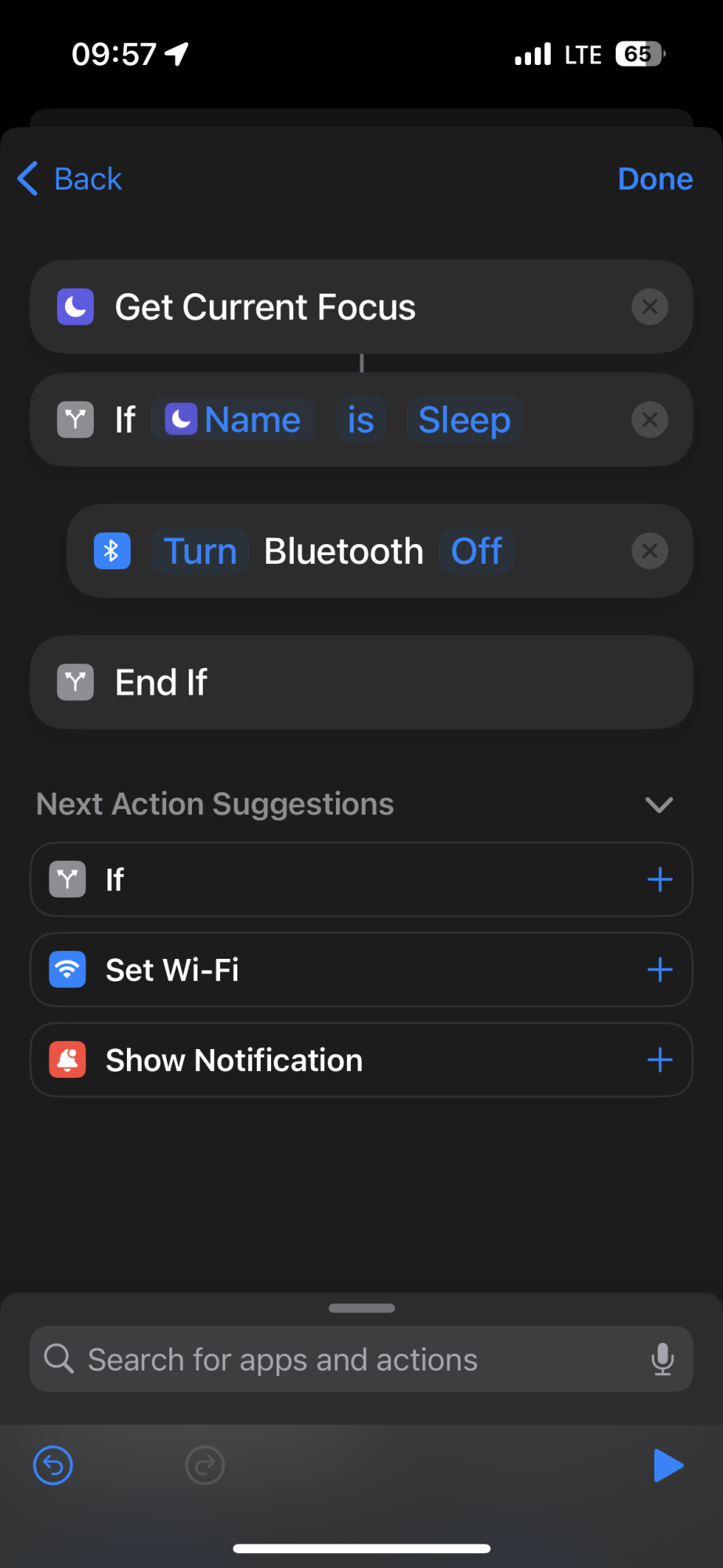

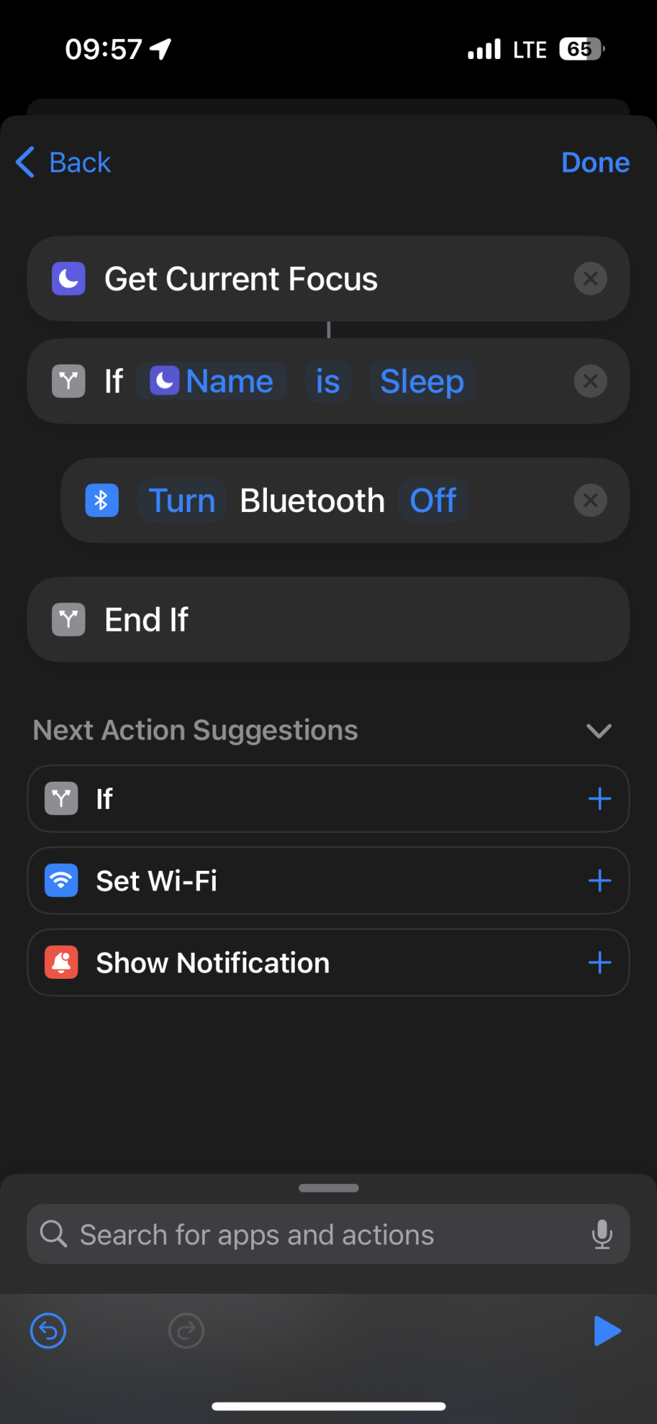

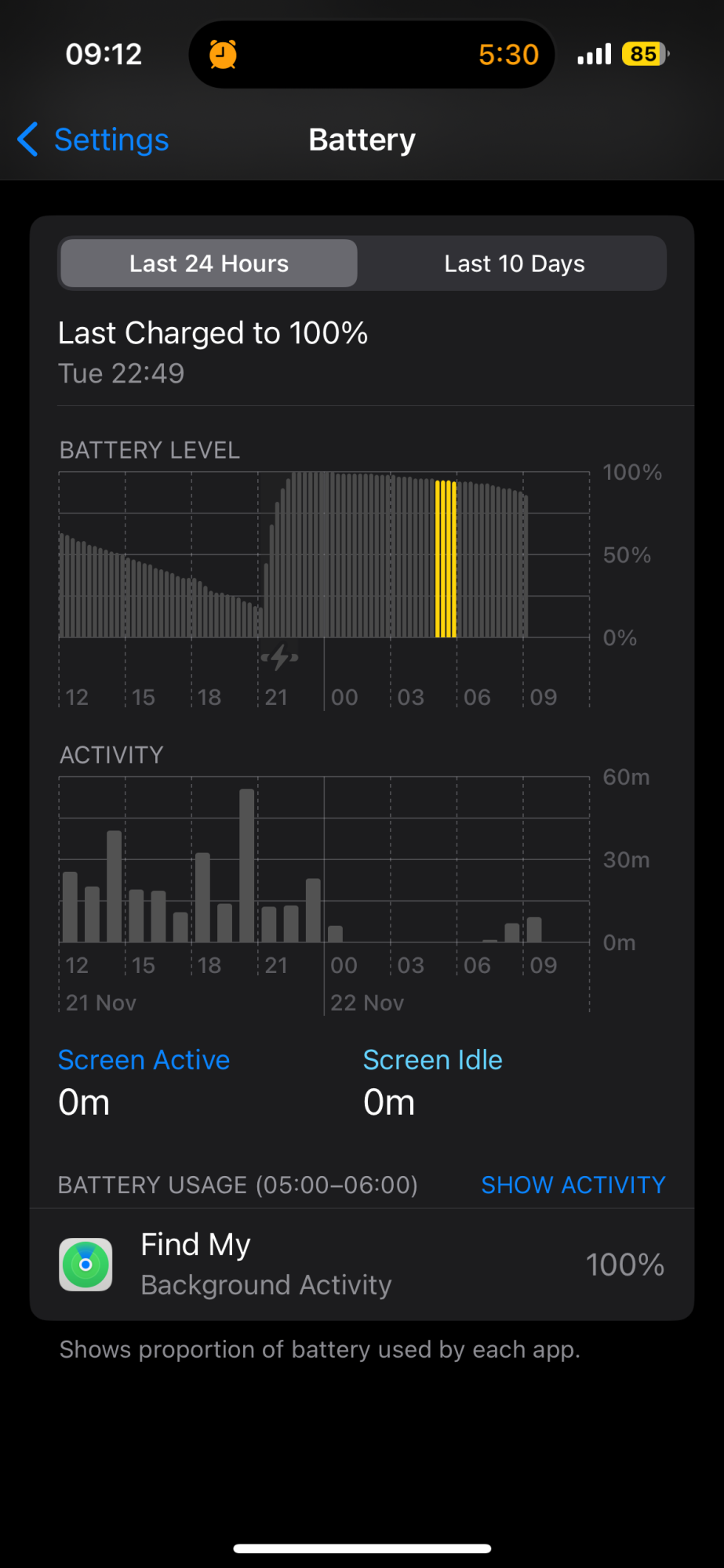

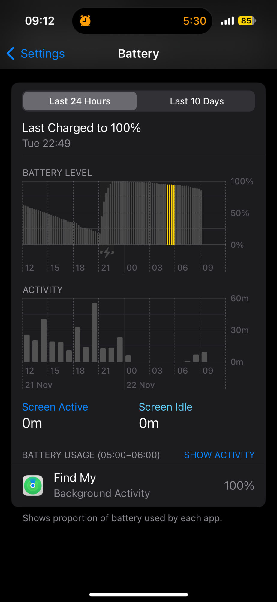

I made an automation that triggers at 1am (I sleep late) and if focus = sleep then turn off Bluetooth.
I want to keep it independent from the bedtime automation (starts around 11:30) because maybe I’m out drinking and I don’t want it, so I’ll have time to turn off sleep mode so Bluetooth off won’t trigger.
but this also means that find my/ bluetooth drains a lot of battery during the day... 🙁 and actually find my still identifies the items and approx location, even for airtag "home 8 minutes ago" with BT completely off.
