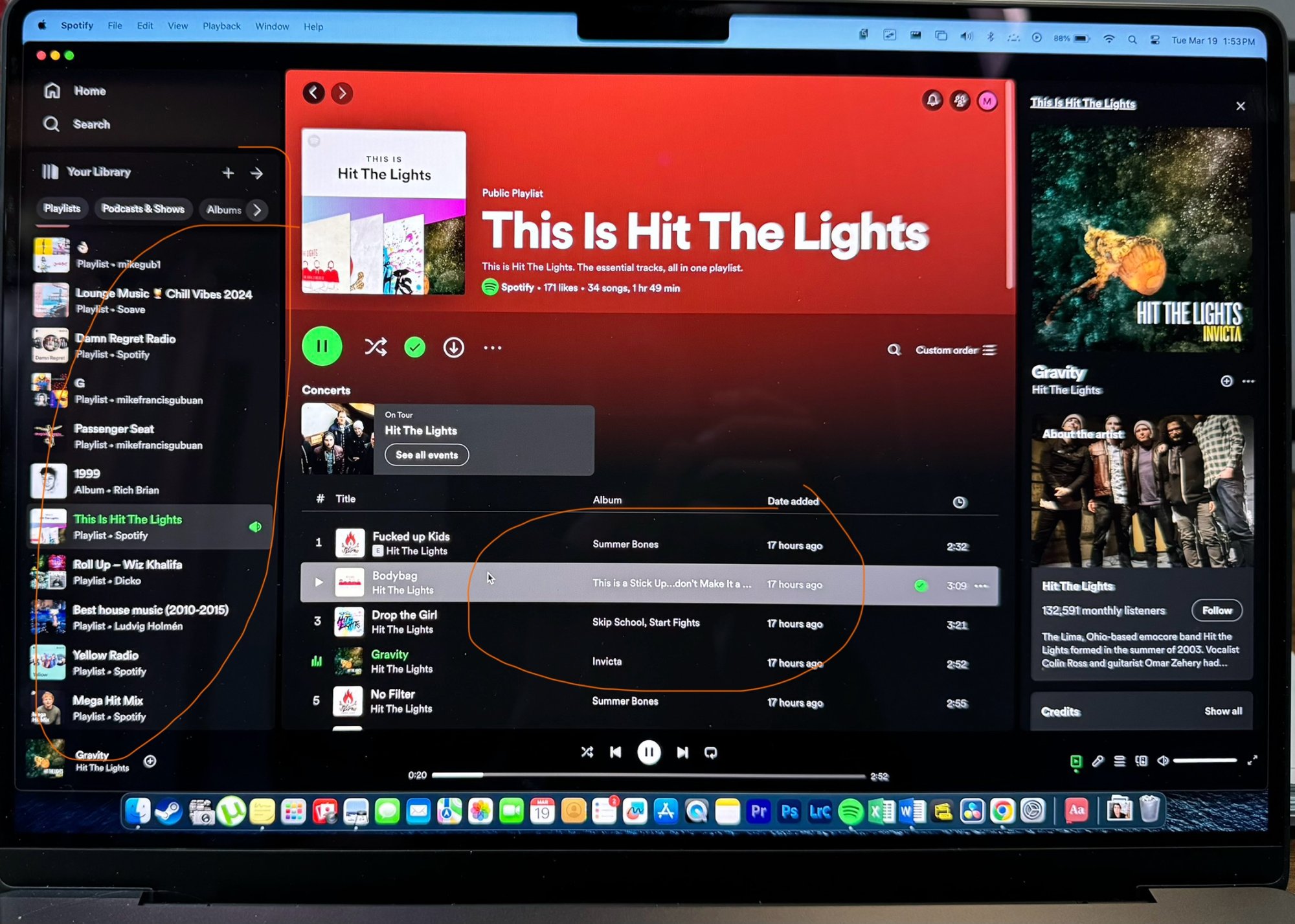

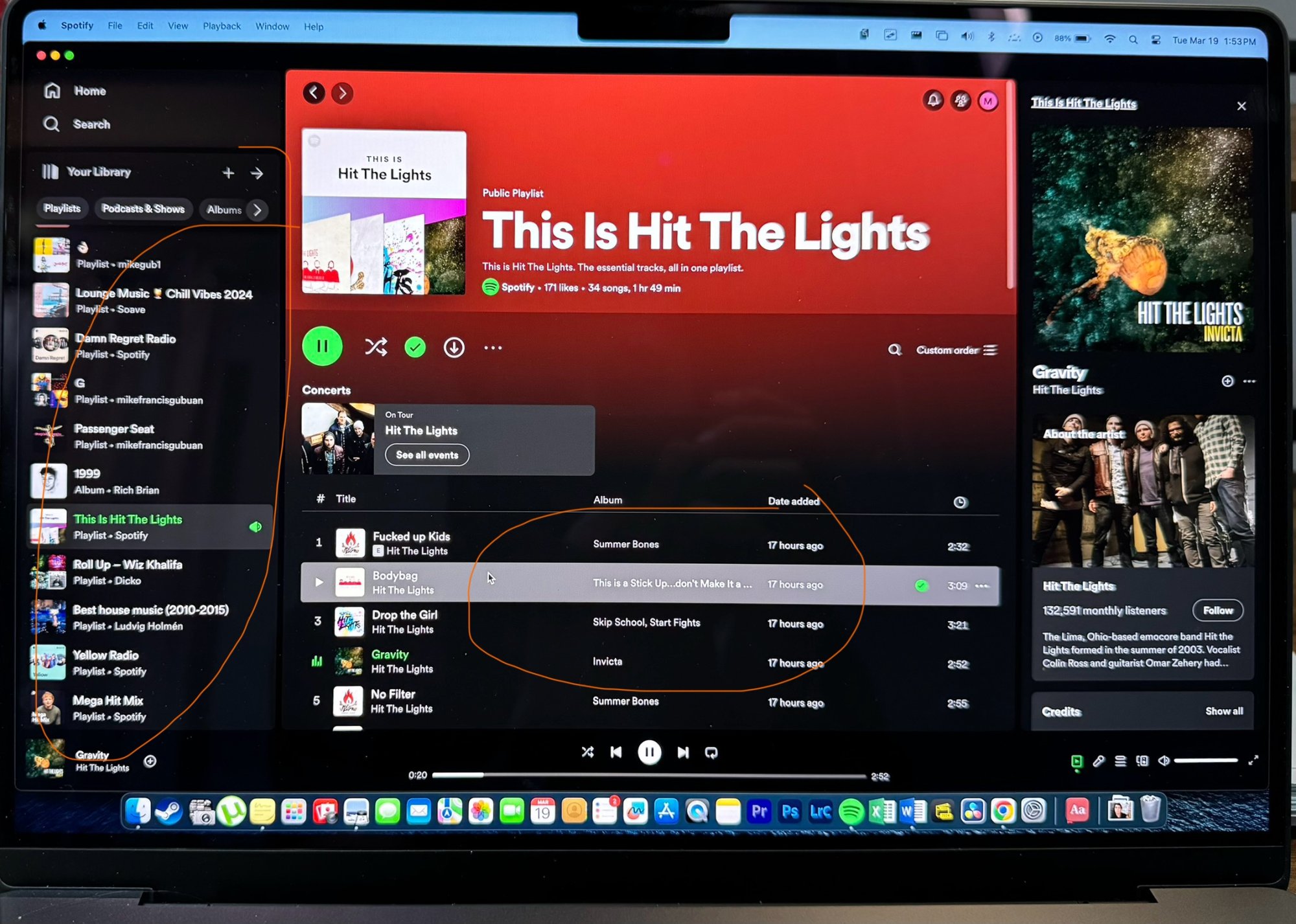

i have the same issue bro, just try using the 2x lens. maybe in the future update they can fix this issue. ive notice the center is clear and sharp while the corners are off or out of focus. see my sample in the attached file
