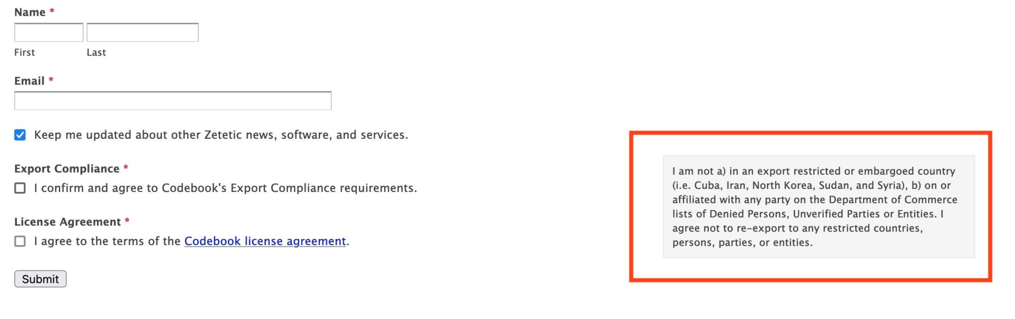

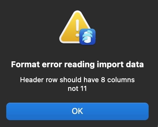

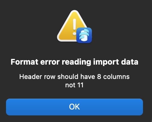

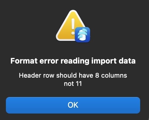

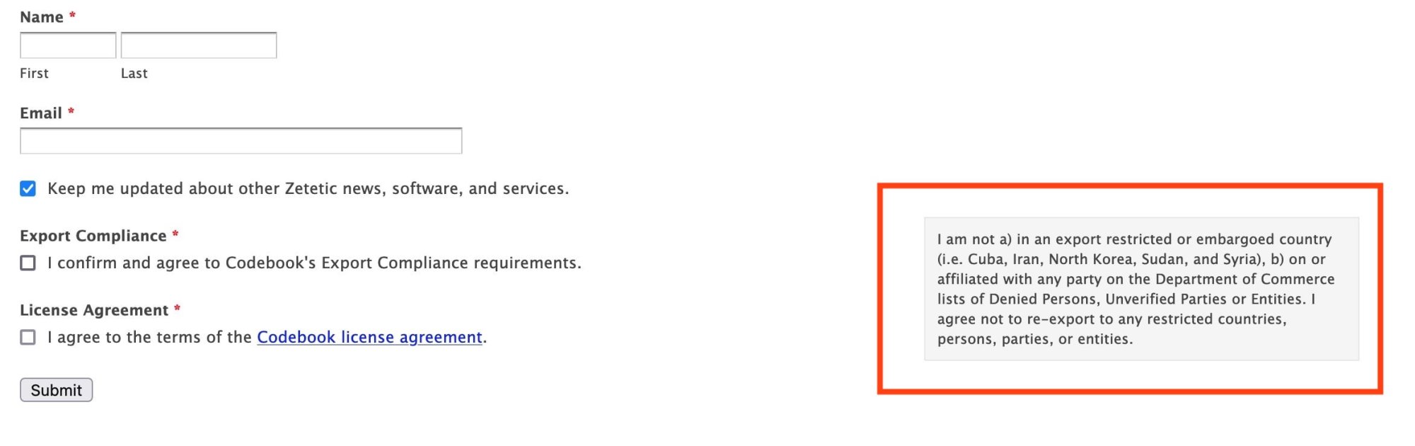

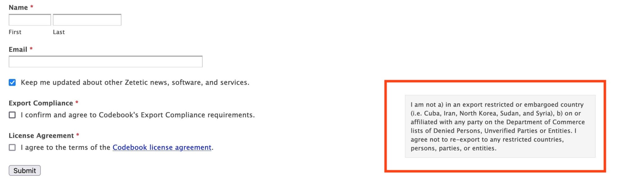

Tried to give Codebook a shot. So far, its not going well importing from Bitwarden. I also got a weird warning that I do not recall ever seeing in my whole life on the internet.
View attachment 2292255View attachment 2292256
Zetetic provides detailed instructions for importing from Bitwarden: https://www.zetetic.net/codebook/switch/import/bitwarden/
If you have followed these and are still having trouble, I recommend you contact Codebook Support, as they suggest.

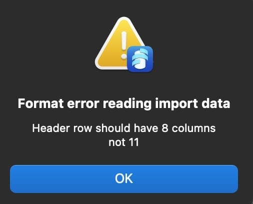

I did the name changing in the CSV file and imported as "Bitwarden CSV " same thing it didn't work. Said it should have 8 columns not 11.
I imported as "CSV" file it worked but any custom fields I had got messed up. I think it stored them as notes. I use custom fields a lot. Those are fields usually that are not "email, password, username"

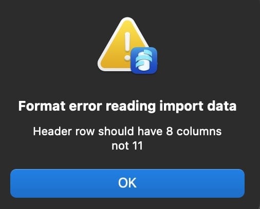

I am sorry, but I am not able to help. I strongly encourage you to contact Codebook Support.
