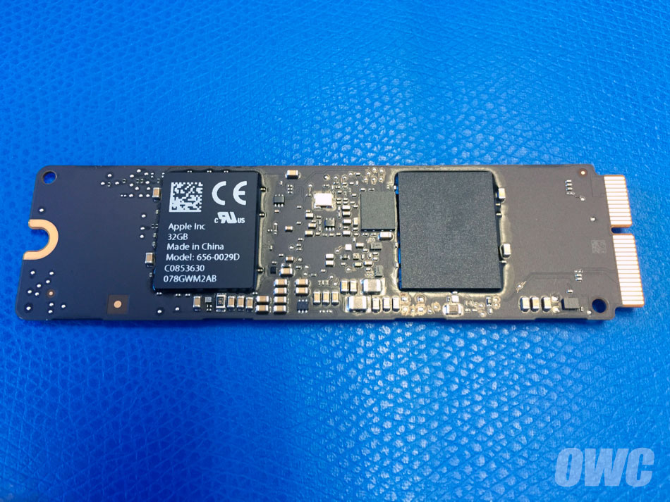

I believe the PCIe flash drive in the "1tb fusion" iMac is in reality a 32gb drive, with approximately 8gb of that space "provisioned off", to be utilized incrementally in the future as the "live" memory cells wear out.
Apple can't be paying all that much for these blade drives.
They should have at least used a 64gb flash drive (perhaps with 8gb provisioned for a usable space of 55-56gb) in the low-end fusion model...
If that were the case it would show 24GB capacity in system report. Over provisioned space is not seen by the OS.
Looking at the teardown of the late 2015 27" iMac, it does say 32GB on the card.
Link: http://blog.macsales.com/33572-owc-unboxes-tears-down-the-late-2015-27-inch-imac-retina-5k
Over provisioned drives I have seen always only show the usable space
Perhaps Apple is using a proprietary method and it won't show as provisioned.
Tbh, I think it makes a lot of sense that apple is using 32GB because 24GB is an odd size.
Interesting find... but I still don't think it shows 32GB in System Report or diskutil. Over provisioned drives I have seen always only show the usable space. I'd like to see a System Report screenshot of someone with one of these.
As far as I know it only shows 24GB in the system report. But yes, it would be interesting to see from someone who has that model. Otherwise I'll have to check next time I am at a store that has one :)
It's 32gb. Actually, this fact was revealed some time ago.
I reckon that the "2tb fusion" iMac (perhaps the Mac Mini models, too) uses a 128gb SSD module, with 8gb "secretly provisioned off" and the remaining 120gb or so available for CORE storage.
The idea is to fend off "SSD drive failures" due to too many used-up memory cells. By having an overly-large reserve of provisioned cells, Apple is hoping that they don't have to replace many of these in the future...
The capacity "loss" is likely explained by Fusion Drive's write cache, which is 4GB. The cache may be in SLC mode (which would explain why 8GB is lost), or there could be some additional over-provisioning.
Digging up this old thread:
I've got this exact drive. Capacity is reported as 24GB.
Did anyone replace this with higher capacity? Do I need to look for an actual Apple part, or will any of the newer 3rd party drives do? I seem to find contradicting (and perhaps a bit old) info when googling.
EDIT: and interestingly, the system reports 'removable: No'. It does look very removable in the photo above.
